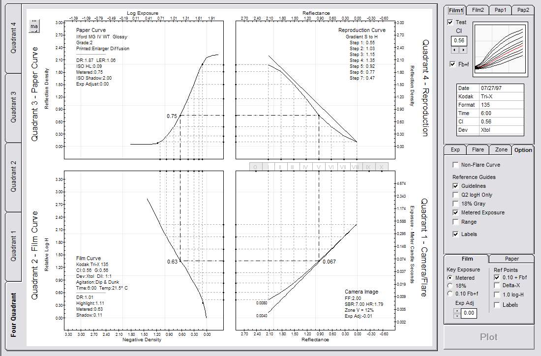

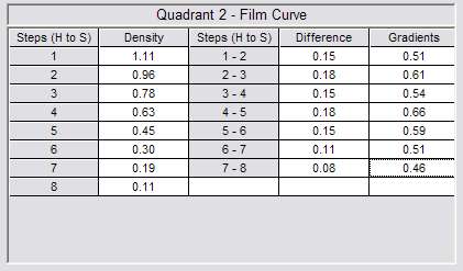

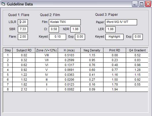

There's a lot of information that can be gained from what ic-racer calls "system testing" (nice term BTW), especially when it's about the interaction between the various elements (original subject, camera image, negative, print, reproduction). Will it tell me if my photograph will likely hang in a gallery? No, but it will help to better explain how the photographic process works if that's what you're interested in, but it's just one aspect of photography. It's not a panacea.

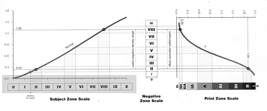

Using the four quadrant reproduction curve, I'm able to explore many different scenarios and test different points of theory such as 18% or 12%, speed point and flare, and Delta-X speed. No more "light meters read 18%" crap for me. Curves are basically meaningless if you don't interpret them.
I'm also working on different ways to compare and evaluate the data. The different attachments show the different gradients for each of the steps in the guidelines, a more detailed breakdown for the film quadrant, and a breakdown of the values in the camera image quadrant. Bit by bit it all adds up to a better understanding of the photographic process which might just make it slightly easier to obtain the creative results one desires.

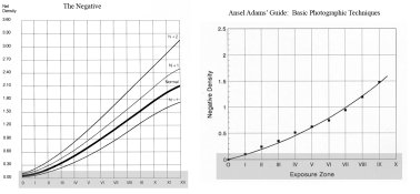

Getting back to the topic of the thread which is about a specific point of theory - correctly defining and interpreting the testing procedures and results using as an example the seeming discrepancy of negative density aim values between the Zone System and Tone Reproduction methodologies. While the two testing methods described in the first message produces the same results and are both relatively valid, because the ZS method doesn't properly define the conditions of the test, it can lead to misinterpretations. The best testing is worthless if the analysis is bad.
Attached are five examples from five different books: The Negative, Ansel Adam's Guide: The Techniques of Photography, Beyond the Zone System, Way Beyond Monochrome, and Photographic Materials and Processes. Only one correctly illustrates the distribution of illuminance in relation to the film curve - Photographic Materials and Processes. All the other examples have the exposure along the x-axis at equal intervals. For a one stop flare factor, this means that they are incorrectly indicating a negative density one stop beyond what would actually result in usage. To me, an important aspect to testing and evaluation is to assure it reflects reality as closely as possible. In four out of these five examples, it does not.

It's possible to reconcile the numeric discrepancy between the two methods using nothing more than Zone System information from The Negative and a little analysis.

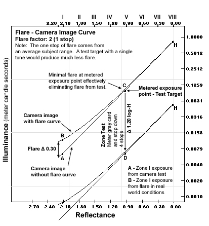

Exposing the step tablet in camera won't introduce any flare to the test because the step tablet is contacted. The interpreting of the data obtained from a contact by definition excludes flare. Flare, therefore, must be factored in.
There also seems to be some confusion between exposure and the camera image. Flare is create from the interaction of the subject and the camera. It is independent of exposure. As you can see from the examples, changes in exposure simply moves the whole curve up and down. The relationship of the camera image to the original subject doesn't change. I've also included an example using scene reflection density for better clarification.

Stephen Benskin
Jan 7, 2005
2,737
Los Angeles
Chuck,
I know you use the Schaefer testing method, so you might find this interesting. The exposure value from the above example for Zone X and/or Zone VIII + two stops exposure is the key to evaluating its accuracy. The exposure value represents the illuminance falling on the step tablet. You already know the density of the steps on the tablet. All you need to do is calculate the transmitted light at each step in the tablet. We know that film speed is calculated based on the exposure where the film curve density is 0.10 above Fb+f - 0.8 / Hm. Schaefer says that the Zone I exposure will fall 9 stops down from the Zone X exposure which correlates at 2.70 step tablet density. The example above of 2.032 is the exposure for a 125 speed film. That means you are looking for an Hm to equal 0.0064 (0.8 /125 = 0.0064). If that happens at 2.70, his exposure technique is accurate.

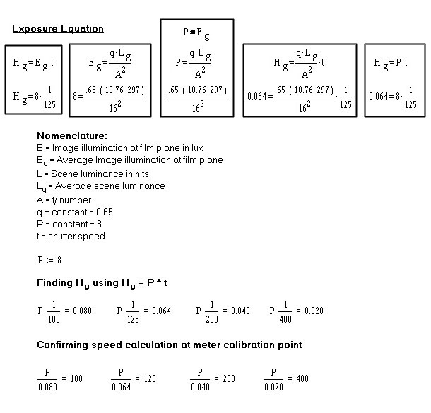

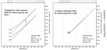

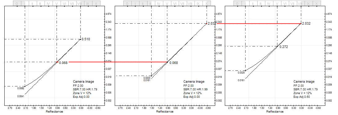

The other three graphs illustrate flare and speed testing. The two quadrant example was for an article on the subject. The other two are quick examples from my new program. Both have the metered exposure point fall at the same place on the film curve. The difference between where the shadows fall is dependent on the lack or presence of flare. I want to add, that these two examples have been simplified slightly with a luminance range of 2.10 and not the standard model's 2.20.
As you know, the meter doesn't read percentages. It measures luminance and wants to produce an exposure of 8 mcs (that's the E in E * t = H equation). E * the shutter speed equals the exposure at the film plane or H. I like to use 125 speeds because it is the only film speed that has an equivalent shutter speed. So for a 125 speed film, the metered exposure (Hg) is 8 * 1/125 = 0.064. As you can see that is the value in the non-flare curve. Black and white film speed is calculated using the equation 0.8 / Hm. To find what Hm should be for any given film speed 0.8 / EI or 0.8 / 125 = .0064. As you can see the difference between these two points is 1.0 log-H or 3 1/3 stops. These more on this in the Sunny 16 attachment.
BTW, the whole middle gray dilemma can also be solved by factoring in flare.
The average luminance range falls 4 1/3 stops below the metered exposure and with the Zone System, Zone I falls 3 stops below. So why is the film speed measured 3 1/3 stops down? Simple answer - flare. Flare brings the shadow exposure up. The standard model uses one stop flare, but in practice is more likely to be around 1 1/4 to 1 1/3 stops.
So if you do a Zone System test, which doesn't incorporate much flare into the test, and stop down four stops, the point where the exposure falls is 2/3 stops below the speed point exposure. That is why so many ZS practitioners find their "personal" film speeds to be 1/2 to 1 stop slower than the film's ISO speed.

If you want, you can compare your film curves from the photographed reflection wedge with a curve generated by a transmission step wedge taped on the film in the camera. The amount of flare in your system, under those conditions, will then be apparent.
These curves are generated from a step wedge on the film in the camera. I was responding to Mr. Benskin's claim that film that ZS practitioners film speeds are 1/2 to 1 stop slower than the stated ISO speed because of flare interaction between the subject and the camera that he believes is not accounted for on the film image in ZS testing.
