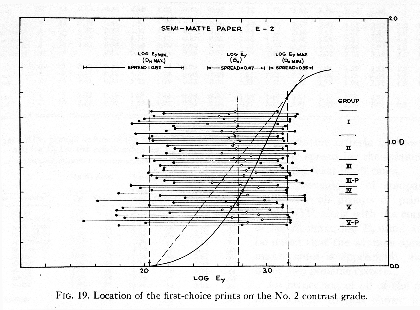

This thread was originally about properly interpreting the results from two methodologies. How a test is interpreted is just as important as making the test, especially if the results are intended to be shared. Tone reproduction, Zone System, and other methods including simple trial and error, all endeavor toward the same goal: to match the scene to the printing material and establish a standard goal or normal. The difference between the various methods mostly has to do with the degree of control, repeatability, and communicating the results. As with most testing, the results will fall within a range. Because the final product of a photograph is subjective there is generally a greater range of acceptability. This has been both a saving grace for practioners and the cause for endless debate.
In the paper, Jones, L.A., and Nelson, C.N., Control of Photographic Printing: Improvement in Terminology and Further Analysis of Results, Journal of the Optical Society of America, V. 38, No. 11, 1948., Jones was evaluating the best approach to objectively determine sensitometrically the paper grade that will consistently produce high quality prints. Jones concluded, “because of the influence of the brightness distribution and subject matter in the scenes photographed, an accurate prediction cannot always be made of the exposure scale (LER) of the paper which will give a first-choice print from a negative of known density scale (DR)… But what other course is there to follow? Either we must make the best of a somewhat imperfect relationship or face the prospect of having no criterion whatever for choosing the paper contrast grade.”
Even though matching the negative DR to the paper LER isn’t a perfect criterion, it is good enough to produce quality images in most situations, or at least with a slight contrast adjustment. Jones also found a few exceptions to the DR / LER criteria, “for the soft papers, the density scales of the negative (DR) should in most cases exceed the sensitometric exposure scale of the paper (LER), whereas, for the hard papers, the density scales of the negatives should in most cases be less than the sensitometric exposure scale of the paper (LER).” So, it's more about determining the middle of an acceptable range than nailing a precise value. As with table 2-4 from the previous post, the "desired density range of a negative usually suitable for each Log Exposure Range or Grade Number" is a range and not a specific value. Grade 2 for a diffusion enlarger is 0.95 - 1.14. Most often the stated LER for a grade of paper is the middle value which in this example is 1.05. If the aim is for an LER of 1.05 then the results most likely will work on a grade 2 paper in practice. However. these values also assume an understanding of what numbers actually represent. The paper LER doesn't refer to the full range of the paper from black to white. Nor does it mean this is the target density range for the negative, but only represents a portion in relation to the subject luminance range.
With that in mind, the following graph excellently illustrates Jones conclusions. The curve is a grade 2 paper curve. The horizontal lines represent the density ranges of negatives that produced first choice prints (best judged quality) when printed on the paper and where the ranges fell on the print. A necessary consideration has to do with the judging parameters. A realistic representative of a scene is different than a dramatic or abstract interpretation. All can be considered excellent in their own right, but fall outside the parameters of the test. For the record, the judges evaluated the photographs as to whether they were a good representative of how the judge believed the scene looked in real life. A realistic representation since this was the goal of the majority of photographs taken.

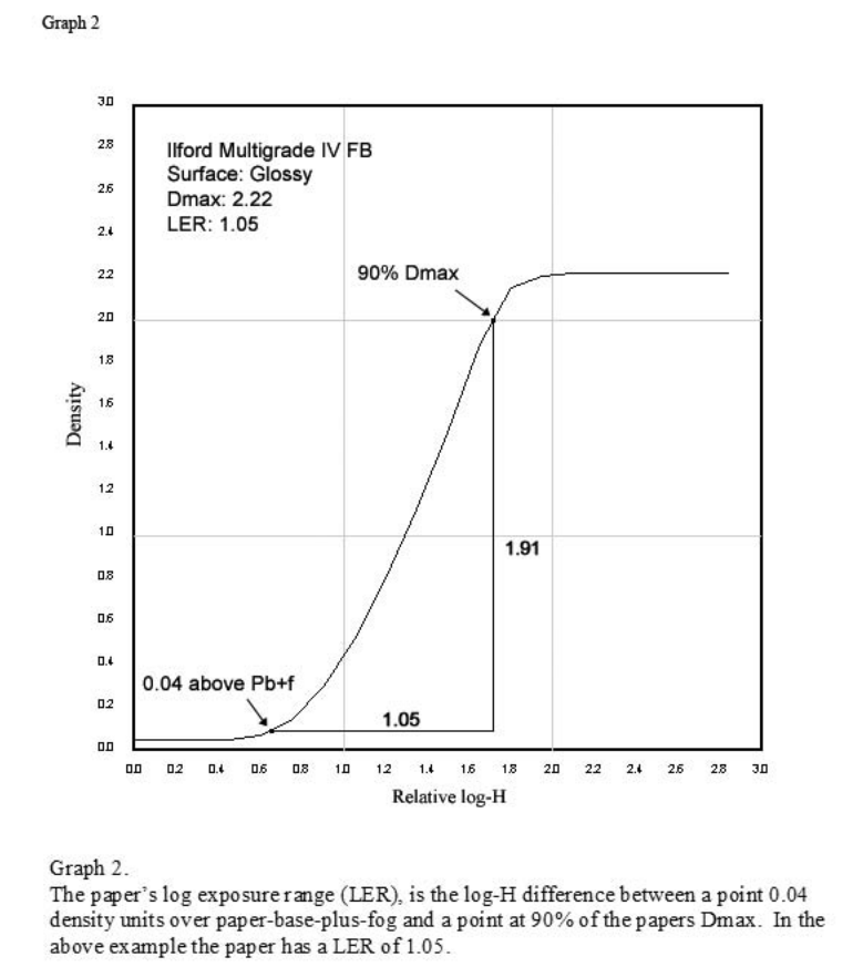

No matter how much you think you understand something, any feelings of complacency are shattered when you have to explain it to someone else. They say no one learns more in a classroom than the teacher. And that pretty much sums it up when I was teaching a class and the lesson was on the Zone System. Like many people, I started with the Zone System, but soon I moved onto more scientific versions of sensitometry and tone reproduction.
When it came time to teach, I had to finally face certain concepts that didnt seem to match up between what I learn about sensitometry and what the Zone System was explaining. One of these dilemmas is on how to define a normal negative. The basic idea is to process the negative so that the negative density range will fit onto the papers log exposure range. While sensitometry uses the method that is described in Chucks thread Testing for Relative ISO Range Numbers, the Zone System has a set of density aim values for the negative to fit onto a grade 2 paper.
According to sensitometric and tone reproduction theory, a paper with an LER of 1.05 is considered a grade 2 paper; therefore, a negative with a density range of 1.05 should fit nicely onto the paper.
According to Zone System theory, the negative density range for a grade 2 paper is 1.25 (1.35 0.10). Sensitometric theory says that is the range for a grade 1 paper and not a grade 2 paper.
Obviously one has to be wrong. Since a negative with a density range of 1.25 will be too contrasty for a LER 1.05 grade 2 paper, it must be the Zone Systems approach that is incorrect. Except that in practice, both methods seem to work. Thus the dilemma.
Some people dont seem to have problems not questioning such differences. Personally, I had blown off the Zone System values as coming from a less precise, less sophisticated method. That is until I had to explain it and why it still worked. I had to ask myself how two seemingly dissimilar methods that had different stated aim values could produce similar results.
Theres a good reason for it and an important lesson that should be kept in mind by everyone when testing.
I did both approaching this scientifically and trying t use the plain Zone System. Both worked for me, but I'm seeing you about to make the same fundamental mistake I
made and that is: trying to fit the entire subject brightness range onto the paper. That is indeed possible but rarely desirable, as it will ultimately lead to a battleship-grey print. A good-looking B&W print has some Dmax blacks and some Dmin whites to show the entire palette of greys

The contrast of paper should have nothing to do with the negative density range. All negatives should be developed the same and printed on the same grade of paper, with minor adjustments in case of under-exposure or bad flare. This will assure that the mid-tones are reproduced at close to 1:1.
I believe you may have misinterpreted the 1956 Kodak publication which appears to have been published in 1952. Could you provide a supporting argument that doesn't rely on that one source? Please include an explanation what the NDR is based upon.
FYI, the mid-tone gradient on the reproduction curve should exceed 1.0. Generally the preferred gradient should be at 1.10-1.12, according to The Theory of the Photographic Process, 3rd edition, Chapter 22, The Theory of Tone Reproduction by C.N. Nelson (co-author of the above paper with Jones).
Hi Ralph,
That is not what that post was about. It was pointing out the Zone System aim of 1.25 and the tone reproduction aim of 1.05 are really the same because the testing procedures are different, but as the resulting gradients are identical, the input to output will be the same, so the resulting aim should also be the same meaning the interpretation of the test results from one of the methods is resulting in misleading conclusions.
The post you quoted is from 2010, so I've long since gone down that road.
Stephen
Bill Burk
Feb 9, 2010
9,332
Teacher learns more… that’s true.
ZS 1.25 vs. tone reproduction 1.05 are the same… noted.
Battleship gray when you try to fit a large subject luminance range by reducing development… agreed that’s a bad picture.
