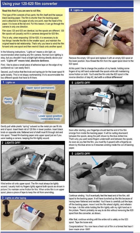

Not sure if it has already been covered, but I bought one of these - makes re-rolling 120 to 620 much easier, especially in a dark bag.
Sirius Glass
Jan 18, 2007
50,869
Southern California
Do you go from the 120 roll to a 620 roll and rewind it to a 620 roll or 120 roll to a 120 roll and rewind it to a 620 roll?
BrianShaw
Nov 30, 2005
17,024
La-la-land
Instructions:
It appears tha the 120 spool is fixed/permanent, so it must be 120 -> 120 -> 620
Rick A
Mar 31, 2009
10,039
Laurel Highlands
8x10 Format
If you roll 120 -> 620 -> 620 you have less chance of getting the dreaded hump.
Sirius Glass
Jan 18, 2007
50,869
Southern California
And that was exactly what I was thinking about when I posted.
BrianShaw
Nov 30, 2005
17,024
La-la-land
If you keep the spools very close together and the film/paper taut, the chance of the jump is minimal. No matter what spool is used as the intermediate.
pdccamerqs
May 11, 2023
270
CT, USA
I eliminate the hump by unsticking the tape, pulling the film taught, and then re-sticking it to the backing paper.
