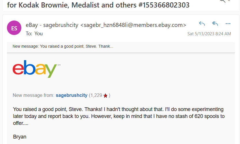

I wonder if he would accept and include a 620 spool if you supplied one?
I wonder how the jig is assembled, and if a buyer can be disassemble the jig enough to replace the "permanent" 120 spool with a 620 spool.,.. and reasemble it.
Since my Brownie Hawkeye camera will take a 120 spool and I only need a 620 spool to take up the film, I will skip buying one and just be careful to save the 620 spool after developing each roll.

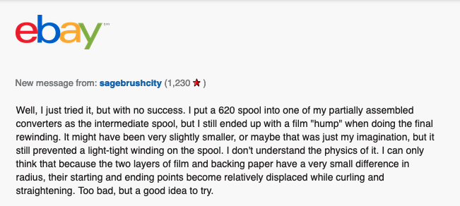

I contacted the seller and asked if the 120 spool could be changed to a 620 spool or if he could provide a 620 spool instead.
His answer:
Update
