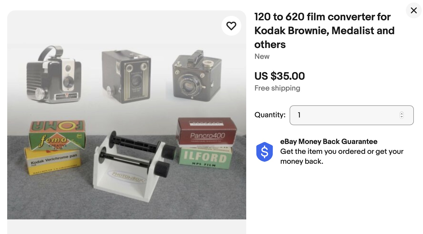

That is why I am asking about this devise, it sound like it will consistently provide a hump. I am better off going 120 to 620 and rewinding on 620 by hand rather than pay $35 plus shipping to install a hump every time on the film roll.

Not sure if it has already been covered, but I bought one of these - makes re-rolling 120 to 620 much easier, especially in a dark bag.
I contacted the seller and asked if the 120 spool could be changed to a 620 spool or if he could provide a 620 spool instead.
His answer:
