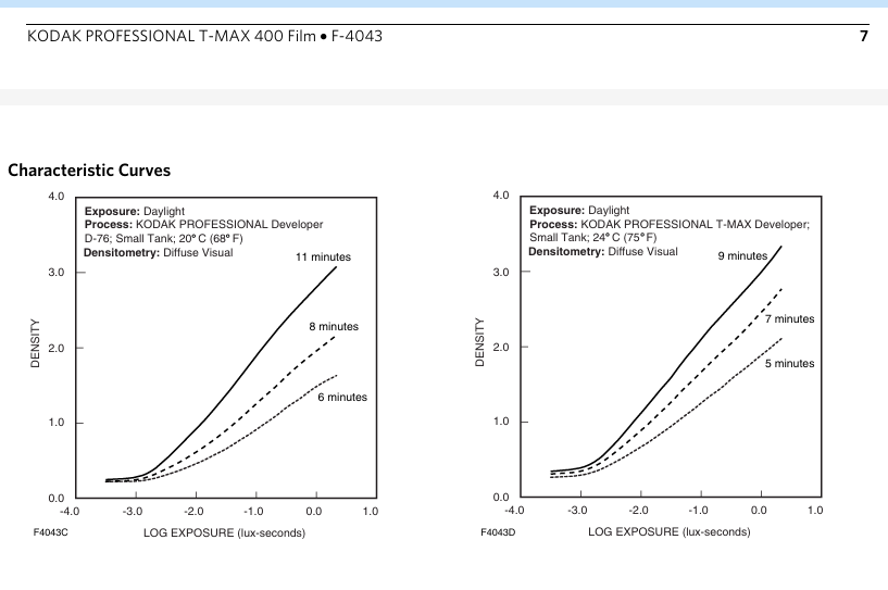

The tool used to depict the contrast behavior of film is a graphed curve, which shows light level on one axis, and film density on the other axis, and is usually in logarithmic units. Typically the resulting curve is somewhat S shaped, with a middle, relatively straight section. The slope of that straight section is measured, and that slope is a measure of the film's contrast - a steep slope means very contrasty, while a less steep slope means less contrasty.
Here is a couple of examples - from the Kodak datasheet for TMax 400:

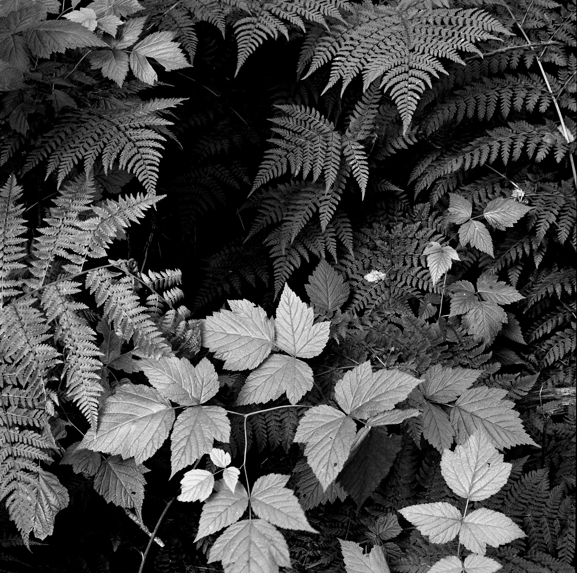

Here is an example, which I have frequently shared. The light was both dim and relatively low in contrast. The developed negative looks incredibly thin and might lead you to the conclusion that it is too low in contrast. I have scanned it, and I have printed it in a darkroom. I'm happy with how it renders:

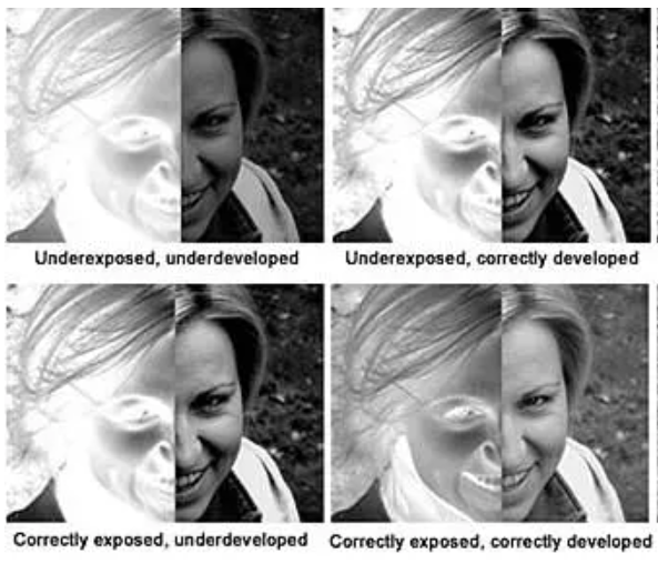

Speaking of, I've read the page that you linked to in the other thread ---- the one with the 9 sample shots showing the difference between over/under exposed vs over/under developed negatives and positives. That's really helpful, thank you.
1. For most examples, I feel I can see the difference between overexposed and overdeveloped images ---- the overdeveloped ones have a much higher "D_max".
2. But, honestly, I cannot see the difference between the underexposed and underdeveloped photos. I'm sure with practice I'll gradually get the hang of it.
An underexposed negative will lack detail in the shadows - they will be clear or nearly clear.
An underdeveloped negative will lack built up density in the highlights - they will be light gray, rather than darker gray, perhaps even approaching black.
In the examples above, the reproduction issues cloud the issue slightly. It is actually a bit easier to see on the positive images, rather than the adjacent negative images.
Comparing the "correctly exposed, underdeveloped" image with the "underexposed, correctly developed", one can see more detail in the shadowed parts of the face in the former, and more separation of tones in the lighter parts of the face in the latter.

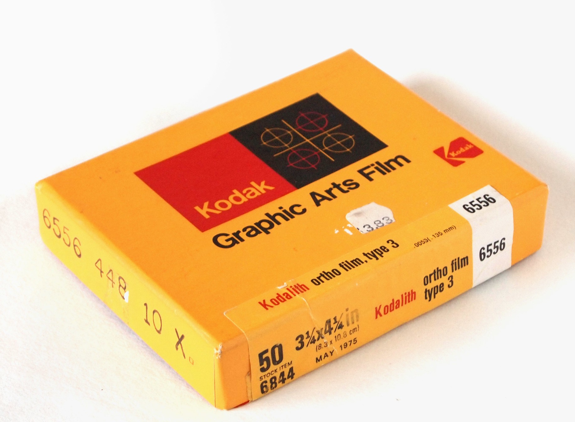

You mean like lith film?
Probably a good example. Kodalith was designed to build contrast/density rapidly and was primarily intended to do this when used with contrast-optimized developers. I don’t know what kind of effective exposure range it would have if developed to a normal gradient (and in a regular developer) but my guess is it would have a significantly narrower range than general purpose films.
Other special purpose materials such as document/copy films would also be examples of high contrast films.
