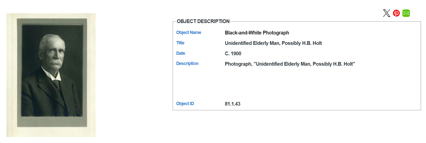

Contact the folks at the Las Cuces Museum that maintain this collection: http://5089.sydneyplus.com/final/portal.aspx?lang=en-US&g_AABX={s:AAAI}&d=d
There appears to be a wide variety of photos there whose main value will be historical, but it is likely that there are original prints amongst them that will be of high quality.
For clarity - don't just look at the digitized versions. Arrange to go see them in real life, if you can.
As an example, the digital version of this one is pretty good, so the original may be a good example:
The curators with responsibility for them may also be able to refer you to others.
