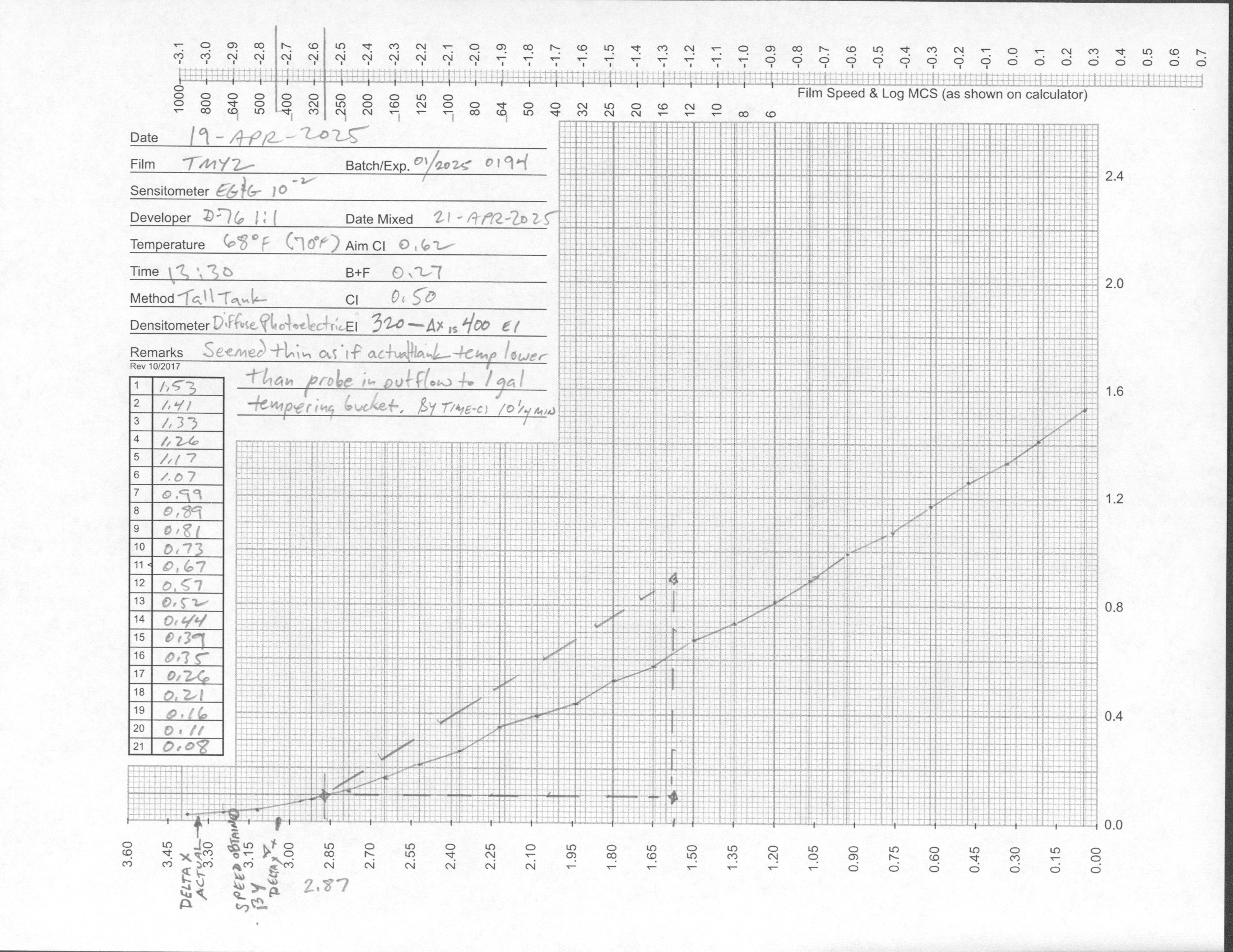

It's crazy that you have seven knobs you can turn that all control one variable (the slope of the D vs exposure curve).
Crazier is trying to figure out which of them went wrong when something does go wrong.
I tried to figure out why my last tank run was underdeveloped.
I have a couple theories.
One problem might be that I put the USB probe thermometer under the outflow of the faucet where the water goes into a smaller-than-needed bucket of tempering water. That temperature was 70-degrees F. Although the developer started at 70-degrees F (matching inflow but see next suspected issue), I think it cooled off to 68 when it filled the "cold" tall 8-reel tank. The USB probe controls my compensating developing timer, and appears to have guided me to a real developing time of 10 minutes 15 seconds developing time (according to my time-ci chart published in Photrio resources).
Another problem I just found is that the adjustable dial thermometer I had in the developing tank was reading 70-degrees F while the USB probe temperature indicated 67-degrees F. I have adjusted the dial thermometer but will double-check it more often. The USB probe, a Paterson glass thermometer and the dial thermometer now agree.
The compensated developing time with aim temperature 68-degrees F for 13 minutes 30 seconds when actual temperature is 70-degrees F is 11 minutes and 45 seconds. (According to stopwatch re-cap of running the timer with the probe in a bath of water at 70-Degrees F)
So best guess is I had a few factors work against me. The dial thermometer was wrong, making the actual developer temperature 67-degrees F going in, the tall tank may have cooled that developer down when it was poured in. The water bath was 70-degrees F but insufficient to raise the temperature in the tall tank to 70-degrees F over time. And the real time was 11 minutes 45 seconds. I might have lost thirty seconds by starting timer before pouring in developer.
I aimed for 0.6 CI, a good contrast would have been 0.55 CI but I got 0.5 CI which many people like because it gives thin negatives without blowing out highlights.
I just prefer a richer, overall more dense negative for printing, so I'll be more careful next time. I'll put the USB probe in the tall tank when I develop and will use Infrared viewer so I can see what I'm doing in the dark with the tank lid open.
