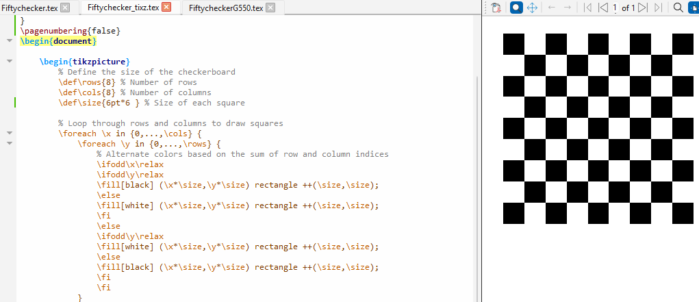

Here's the direction I'm going. Using TeX to create a page to print with a checkerboard half.
Print and put on light box. Put hollow cardboard box with divider on that. And another piece of paper on that. This should cut one half by 50%.
The halftone pattern could be increased and decreased to cut light by any desired percent. I'll also provide a table of percent to density (know that 50% = 0.30) and a table of expected density difference per contrast index at two stops bracketing. Could even share the math so anyone who wants could pick any bracketing amount they're comfortable with (or if real world tests by students proves that two stops isn't enough to make the test results easy to read).
