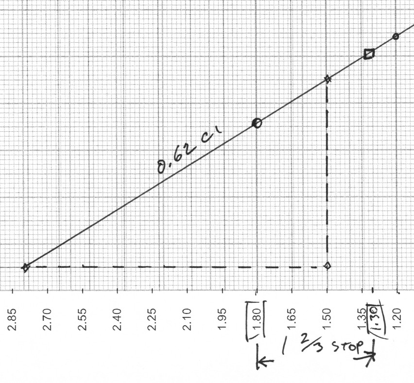

1 and 2/3 stops should give you a slope of .6 with a .3 ND filter, if you want more contrast.
If it’s easy for you to dial in + 1 2/3 stops exposure compensation, that’s a very good idea.
Well, as the person whose endless questions inspired you to develop your test, I would be remiss if I didn't mention that my camera has an exposure compensation dial with 1/3 stop increments. I can literally set the dial to EV = +1 2/3.
That's what inspired me to suggest 1/3 stop increments to dial in the gamma.
Yup that’s fine for you. It will work on my Pentax ES-II in auto. But for any manual camera you might be dialing in differences of whole stops.
If I still go with two whole stops bracketing as originally planned, odd how graphically it looks close to being +0.1 density higher with +0.1 Log exposure increase. It’s not mathematically correct but might be close enough for practical checking.
Now it might be with an 0.40 neutral density filter on the light table, two stop bracketing might match.
I have an 0.10 Neutral Density filter I can add on the light table.

Thanks to Bill Burk for the evaluation method.
I added a resource to describe a simple film test that can be done using an 0.30 neutral density filter.
Here is a link to the article:
Confirming_Development_Time
The way it works is that normal development is pretty close to a 50% gradient, and so if you bracket a couple shots. Give one normal exposure and give the bracketed shot 2 stops greater exposure, the difference should be close to 0.30
So after developing, if you lay an 0.30 neutral density filter on the normal exposed shot, it should look like the shot that received 2 stops greater exposure.

I'll try to explain.
Imagine you expose a negative with just a single grey value, let's say it's a solid-colored wall with no texture and perfectly evenly lit. In the correctly exposed and developed negative its density comes out at 1.00logD. Now imagine that you expose another negative, immediately next to it, but this time you overexpose by 2 stops. What will the density of that negative be? If the gamma is exactly 0.5, then the overexposure of 2 stops would result in 2 * 0.5 = 1 stop additional density in the negative. 1 stop density = 0.3logD, so the density would become 1.3logD. Hence, if you observe the correctly exposed negative through a filter that adds 0.3logD density, then it should look the same (1.0+0.3=1.3logD) as the intentionally overexposed negative next to it.
That is, if everything worked out as planned and the development did indeed yield a gamma of approx. 0.5. If the gamma was much lower (underdevelopment), let's say 0.25, then the density on the overexposed negative would end up lower, at around 1.15logD. So it would look visibly lighter than the correctly exposed negative viewed through a 0.3logD filter. Conversely, if the gamma ended up higher (overdevelopment), let's say 1.0, the density on the overexposed negative would be higher (around 1.6logD) and the overexposed negative would look substantially darker than the correctly exposed negative viewed through the 0.3logD filter.

I like your quick test, Bill. I will try a frame with +1.5 LV more exposure for a gamma of 0.66.
I'm thinking that a subject with tones mostly around zone 5 would give the most reliable results (it would stay within the straight-line portion of the curve).
