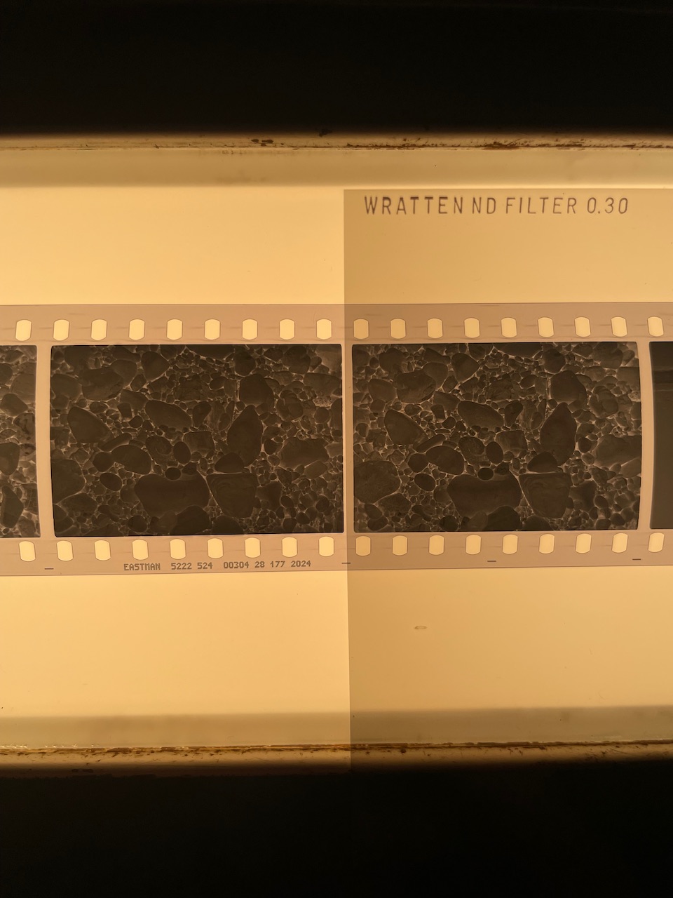

I added a resource to describe a simple film test that can be done using an 0.30 neutral density filter.
Here is a link to the article:
Confirming_Development_Time
The way it works is that normal development is pretty close to a 50% gradient, and so if you bracket a couple shots. Give one normal exposure and give the bracketed shot 2 stops greater exposure, the difference should be close to 0.30
So after developing, if you lay an 0.30 neutral density filter on the normal exposed shot, it should look like the shot that received 2 stops greater exposure.

Sharing the cellphone picture does give us a chance to help. But it also lets you play with settings to exaggerate the differences if they’re hard to see.
I used a tungsten light box to avoid fluorescent or LED flicker. (This is where having a half dozen light boxes comes in handy). A window would be a good choice.

I prefer recommending two shots, two f/stops apart because they stick out on the light table. Plus they are not a waste of film. Both shots could make an excellent print.
Time will tell if it is easy for people to get their hands on an 0.30 ND filter. I might start “accumulating” them so I can cut them up and mail out pieces to people who want to try it.

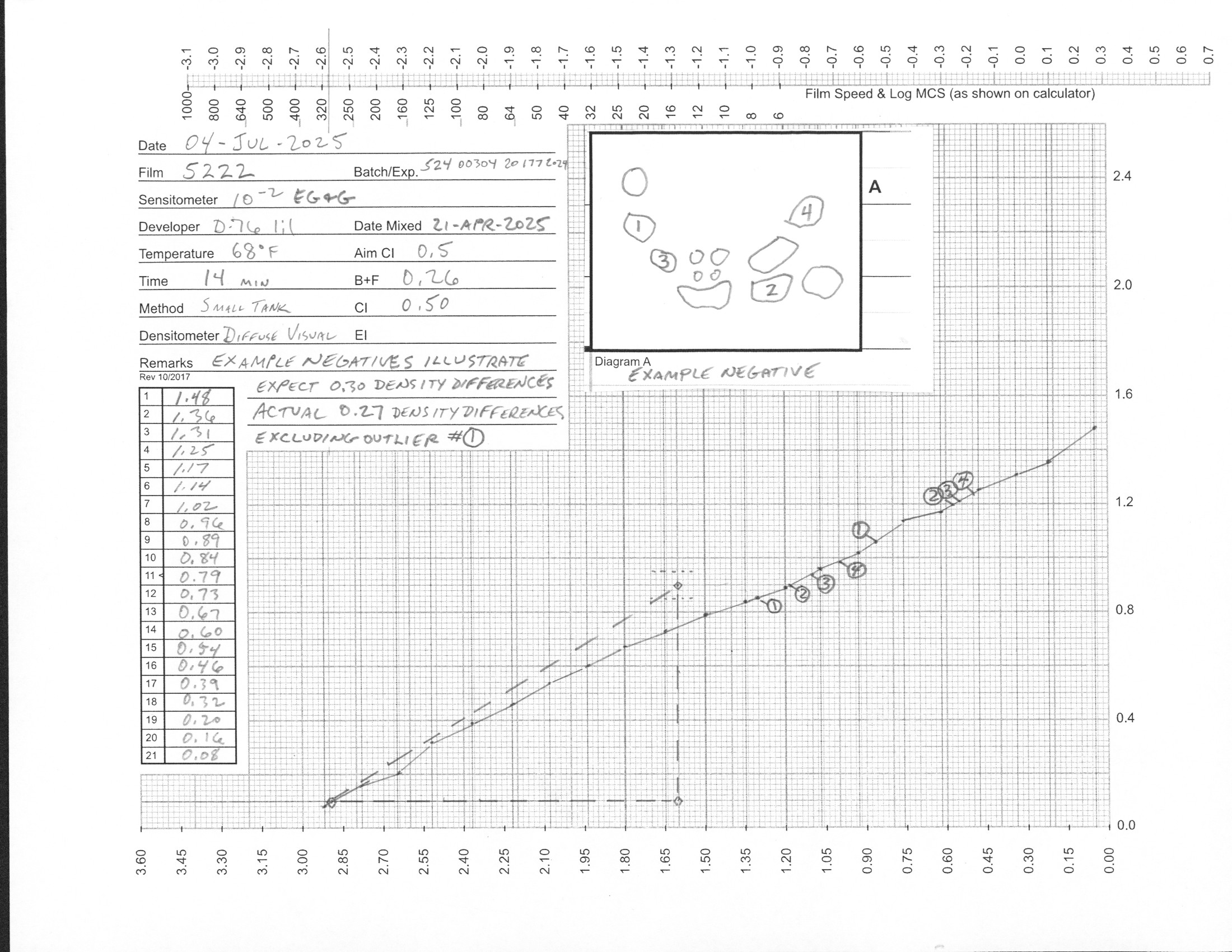

The densitometry and sensitometry behind the test.
In fact I did get 0.50 Contrast Index.
So the two negatives “should look the same” when an 0.30 neutral density filter is laid over the negative which received normal exposure.
Density readings of several rocks in the negatives show an average 0.27 density difference when I throw out a reading that wasn’t close. This is pretty close to expectations.
If I'm reading this correctly, this only works for checking whether you developed the film to CI = 0.5?
Is 0.5 somethig like a gold standard?
I must admit that I've never in my life checked what CI film/developer manufacturer targeted with their suggested development times. So this method could easily suggest that something is wrong with my times, temperature, dillutions, etc. and/or would lead me to substantially different contrast index than what manufacturer had in mind when providing development times for different developers?

That's what I noticed too, but I assumed that 0.5 would be close enough to 0.6-0.65 which would be a more common CI to aim for. And since this method based on a visual assessment would only be useful for spotting gross deviations, it wouldn't matter too much that the 0.5g-bar would be a little on the low side. The idea here is probably to see you're not hitting way too low or way too high, but somewhere in the ballpark.
Thanks @koraks! It was just to confirm that I understood the principle. For BW I'm basically "read the development times from the box/MDC and you'll always be good" kinda guy...
But I can see that this method can easily be applied to scanning with a lot more precision than in 100% analogue workflow visual inspection so @Bill Burk (or someone else) might expand on this article.
