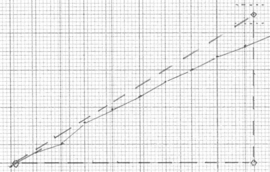

When you plot a characteristic curve and have a candidate for ISO, you locate the point of least exposure where the curve crosses 0.1 density above base + fog. Then you go across towards greater exposure and check the density at 1.3 log exosure across. For ISO you look for density increase 0.80 +/- 0.05.
Hence 1.3 run 0.8 rise, rounds off to 0.62 most of the time.
You can see the 0.5 curve crosses low of ISO tolerance.

What your plot also neatly illustrates that in the real world, the 5 significant digits don't do much. The width and inaccuracy of a pencil-drawn curve alone renders all that numerical resolution moot. And then we're not even talking about variance in metrology, film processing etc.
