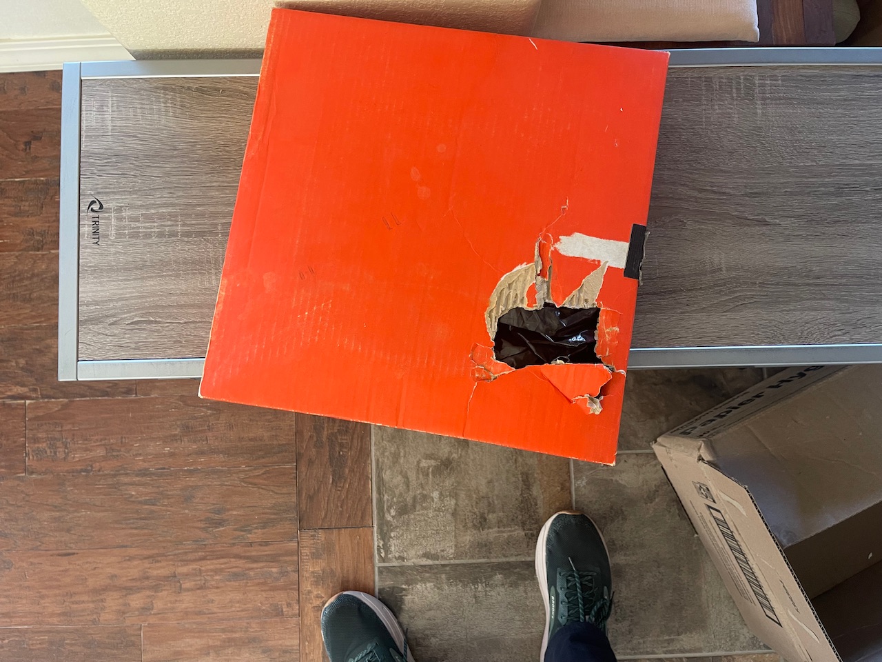

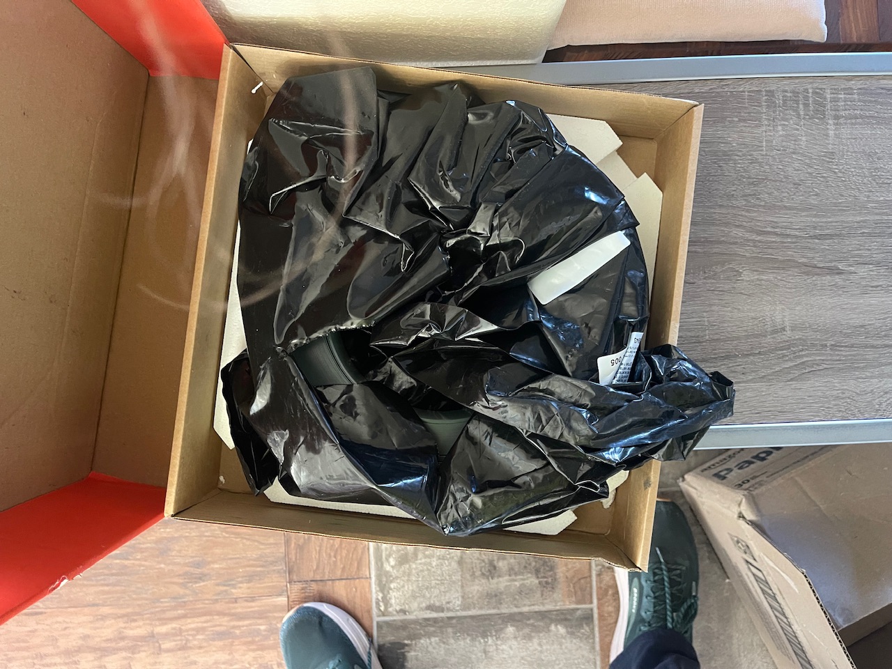

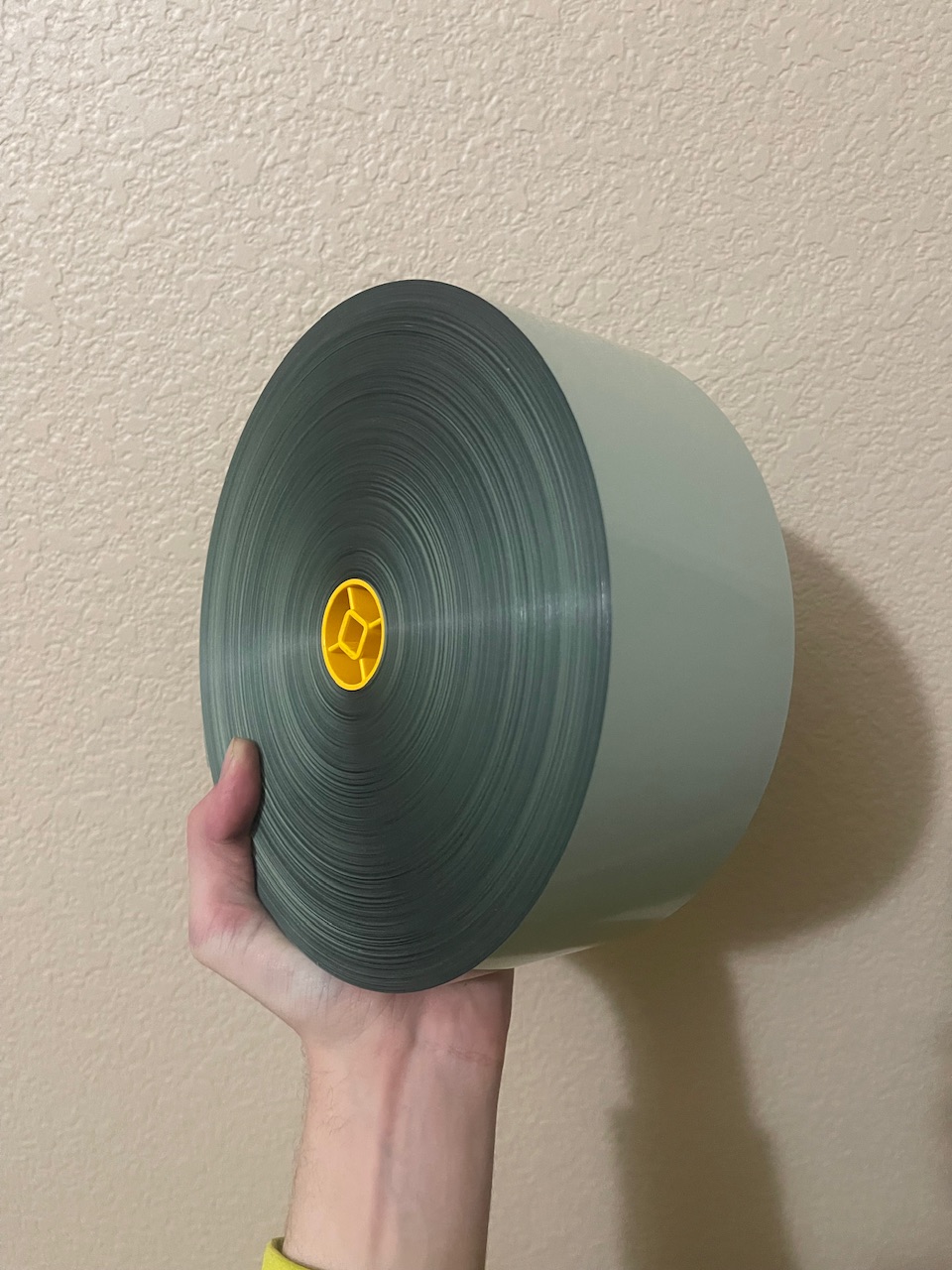

Ok yeah this film is fucked.
If anyone wants dummy film, lemme know. I unfortunately have plenty.
That film may still be good for exposing, Tightly wound like that would prevent light from fogging 3/4 of the roll from the center out. Only the edges would be ruined. Are you keeping it safe in the black plastic bag?
Do you know yet what type of film it actually is, and the size? Is it 70mm, or larger?
The film actually came very loosely wound in the box, I am unsure if that’s how it’s normally packed, but I doubt that there was any salvaging any of it. I just put it on a 1 inch core because the box took up a lot of space and I wanted to get rid of it. Couldn’t quite make myself throw out the film though.
This is 70 mm film, but on a thick sheet base.
