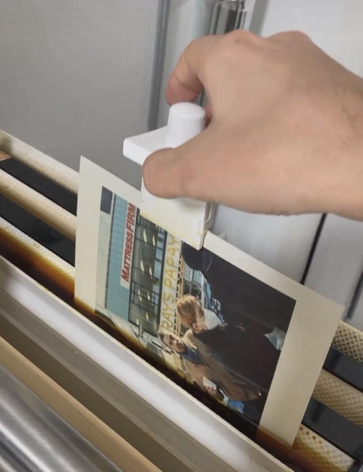

Finally got my Nova set up
This machine can process RA-4 paper? I’m looking for any at home/studio options for printing RA-4 and I’ve come across photos of it several times but I can’t figure out how it works. Does the paper get carried by rollers?
What roller/machine is this? Is it for rocking chemistry back and forth with a print inside?
Not sure which photo you were referring to, but I think it is the curved stainless steel tray.
It can do RA-4, but it is still somewhat manual. It basically acts like vertical trays where you slide the paper into the slots.
The 2 sections between the slots contain a heated water bath to control temps. I have it set up to a wifi plug since it takes a little to heat up, I can turn it on via my phone and show up to my darkroom and start printing almost immediately.
