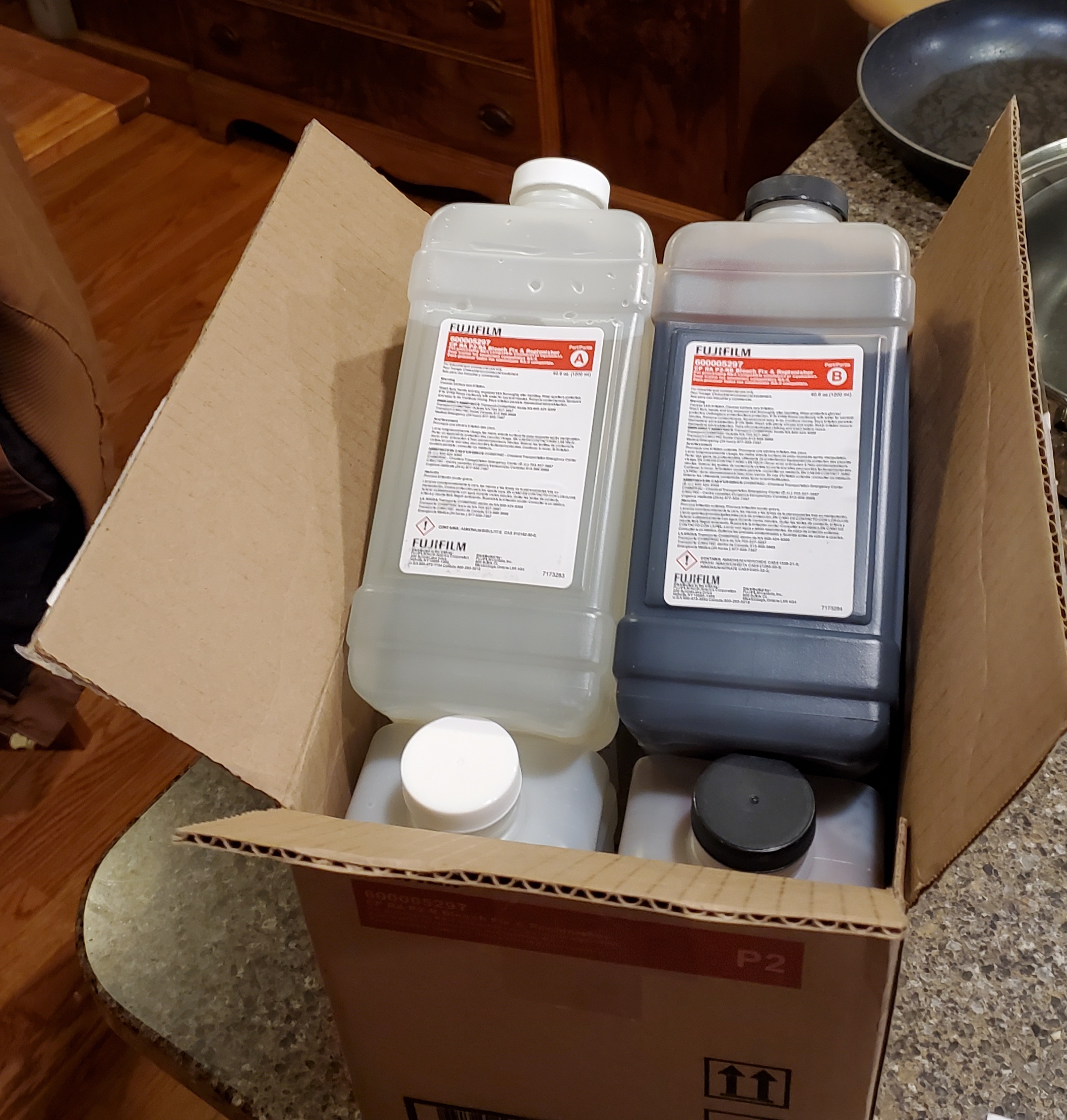

I've never tried room temperature RA-4. I know PE processed RA-4 at room temperature in a tray, 2 minutes each for developer and blix. Would be zero investment, just a tray and a watch.
