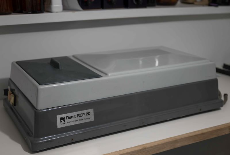

I mostly do drums for larger sized prints and have an RCP20 up and running for RA4 for anything 8x10 and smaller.

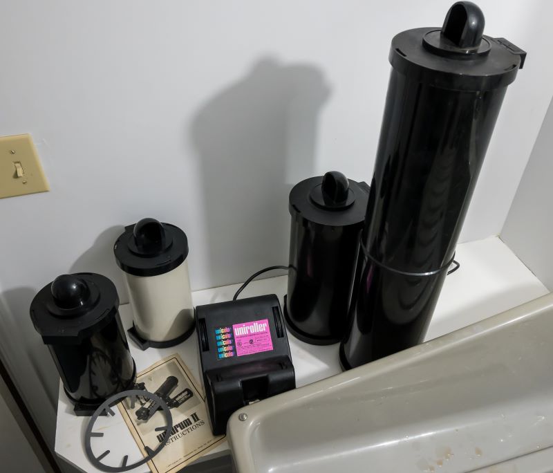

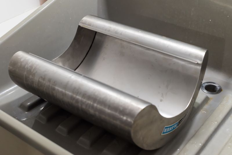

For the daylight drums, I have Cibachrome x4, Unicolor x7 , Patterson x3 and a couple of Unicolor roller bases, I also have a 16x20 Mitchell color canoe, which I have tried but I need new filters for my Thomas Duplex Safelight before I can use it without having a 'blueing' effect on the color paper.

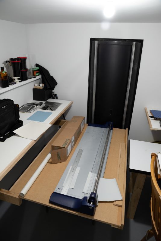

I have a few rolls of 20", 30" and 40" wide color paper in Kodak Endura and Fuji Maxima (in the freezer) that I cut down for use on a special built table. I do all of the cutting in the complete dark and can handle rolls up to 51 inches wide. Kinda takes up the dry area of my small basement darkroom, so I like to get all of my cutting done in a session and pack this setup away.
