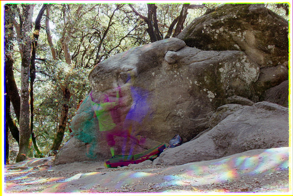

A self portrait combining my two hobbies, photography and rock climbing. :D
Nikon FM2n, AI Nikkor 50mm f/1.8S, Ultrafine eXtreme 400, developed in LegacyPro L110 at 1:31 for 5.5 minutes. Three individual black and white frames shot through Tiffen #25 Red, #58 Green, and #47 Blue filters, respectively, then combined using GIMP to create a trichrome color image.
