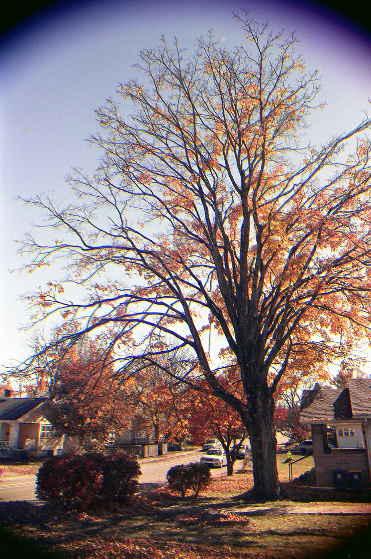

Kentmere 100, Xtol 1+1
R29, G61, B47B
Apart from colorizing and aligning the exposures, I had to squelch the final magenta levels on this roll presumably due to some imbalance in the original exposures.

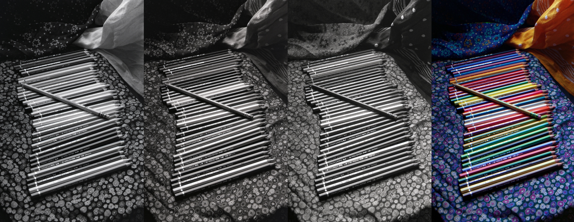

In case anyone else is using small, 49mm diameter SLR lenses like my Olympus OM ones, I designed and 3D printed a system that lets me magnetically swap between R, G, and B filters for trichrome work. Makes the whole thing a lot faster and more convenient, IMO.
Despite the limitations & 'defects' from having to take 3 discrete exposures, fiddling with the filters is really what will make or break one's enjoyment of photographing trichromes. I'm using 52mm filters and I think I'll embed them into a cardboard holder to help streamline the process a bit outside of a studio setting. In the meantime there's plenty of cursed photos to be taken...

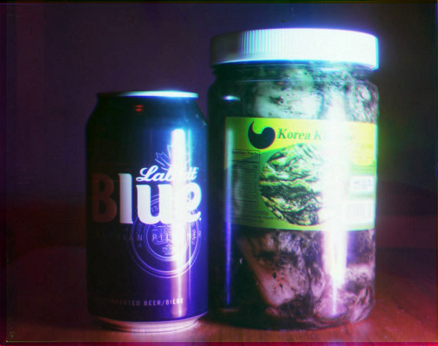

Fuji HR-U 4x5
O16 as RED
G61 as GREEN
Unfiltered UV LED as BLUE

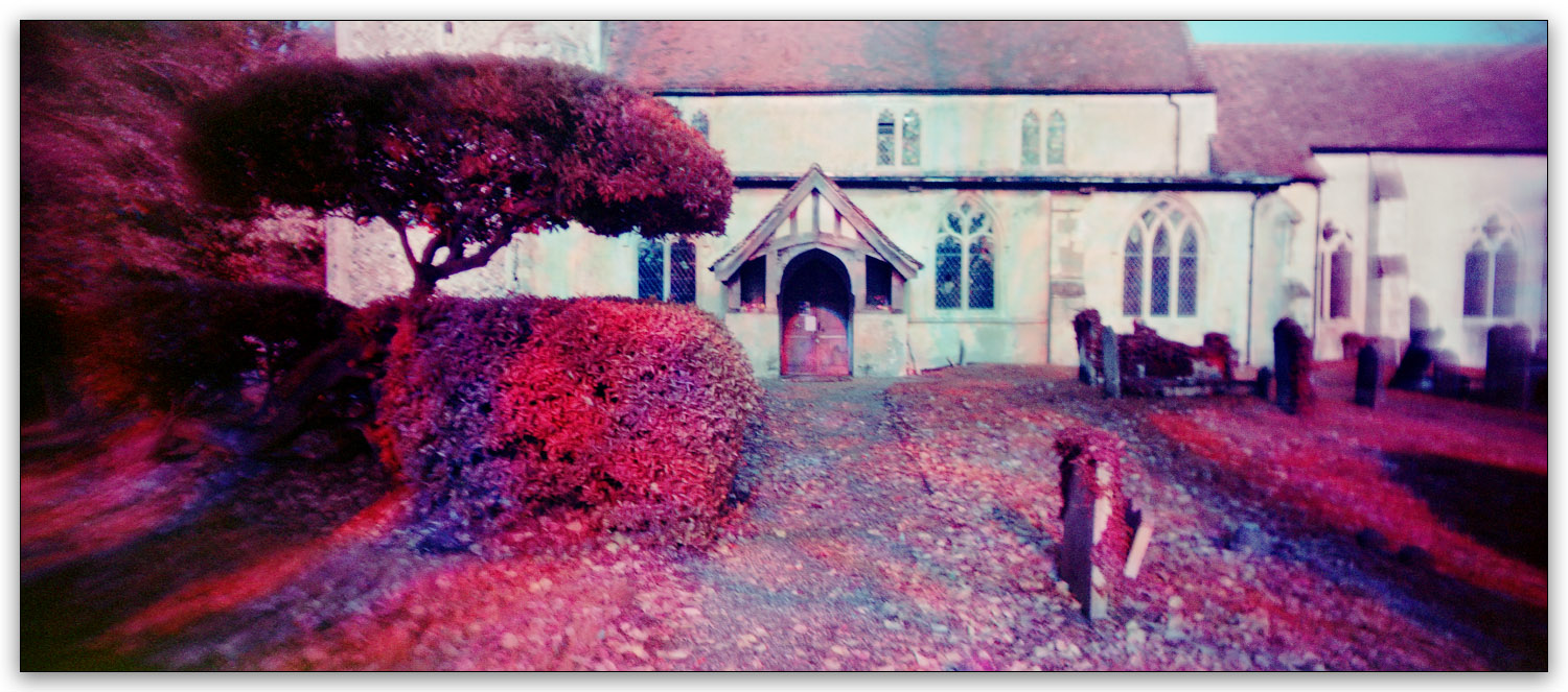

First attempt at an Infra Red Trichrome. No the UK weather has caught up with the seasons I had to wait a few weeks to get a useably sunny lunch time to try an capture some IR rays 😎
Holga Pan 120
Ilford SFX
720, Green, Blue

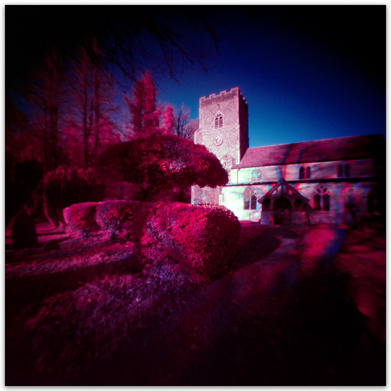

I've been making most of my Trichrome images over that last couple of years with pinhole cameras. I find the add another layer to images and also help with using extended exposure times to capture "Colour from Movement". There were no clouds or wind to take advantage of but I wanted to see how well an Infrared Pinhole Trichrome would come out. Quite nicely it would seem 😁
Chroma Cube 6x6
Rollei Infrared 400
720nm, Green, Blue filters

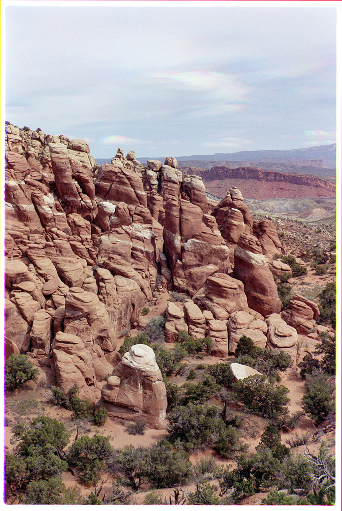

Arches National Park, Fiery Furnace Overlook.
Nikon FM2n, AI Nikkor 50mm f/1.8S, Kentmere Pan 400, developed in LegacyPro L110 at 1:31 for 5.5 minutes. Three individual black and white frames shot through Tiffen #25 Red, #58 Green, and #47 Blue filters, respectively, then combined using GIMP to create a trichrome color image.
by dourbalistar, on Flickr
<snip>
2022.04.18 Roll #304-07085-positive-trichrome.jpg by dourbalistar, on Flickr
Fantastic! Is that Skyline arch? I live in Utah but it's been too many years since I visited Arches. If that is Skyline arch, I remember being there as a little kid and running across a whole bunch of baby rattlesnakes hiding in between some boulders. My parents whisked us out of there very quickly after that discovery :D
Thank you, @BHuij! That's Double Arch on the left - I'm not sure if the cave feature on the right has a name.

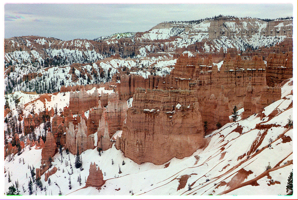

Along the Rim Trail in Bryce Canyon National Park.
