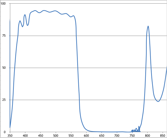

Eventually, Schneider optics made a filter to my specifications! 4x5" and 6x6" sizes for our camera's matte boxes. It passes light at >95% from UV up until 570nm, then suddenly hard cuts down to nothing. I got a true Ortho look and it cost me only a stop of light (actually 5/6ths stop).

I am not attempting a tint at all - the final film will be shades of true gray. I'm merely looking for orthochromatic response onto panchromatic film. Initially, I thought that strongly gelled lighting would be the way to go about it, but ultimately, I figured that a bright set and camera filtration is probably less distracting to the actors than a deeply cyan set. Additionally, there are many day exterior scenes where I would need the filter.
Does anyone have a spectral sensitivity chart for CC50? Or a blue 47 for comparison? I wouldn't be opposed to a "blue-sensitive" look with the 47 either - it's just that that filter eats too much light to be practical. Ideally it's 2 stops or less, while working as effectively as possible.

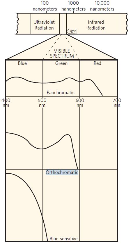

Here's an image that shows some typical response curves for panchromatic, orthochromatic, and blues sensitive films. I got it from a kodak document titled BASIC SENSITOMETRY AND CHARACTERISTICS OF FILM. I found it at the following website.
https://www.kodak.com/uploadedfiles...etters_filmEss_06_Characteristics_of_Film.pdf
Of course, links come and go, so I am posting the actual figure here.
It looks like a filter with a cutoff somewhere in the range of 610 nm would be a good bet.

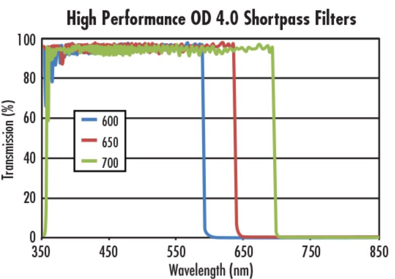

Edmund Optics sells some cutoff filters. For example, they make a short-pass filter with a cutoff of 625 nm. They come in three different diameters. They are very expensive, and you would have to figure out how to mount them into a threaded filter mount. They also make filters with 600nm and 650nm cutoffs. Here's a link to the page.
https://www.edmundoptics.com/f/high-performance-od-4-shortpass-filters/13534/
Here's a figure showing typical transmission curves for a few of their filters.
As you can see, performance is extremely good.
