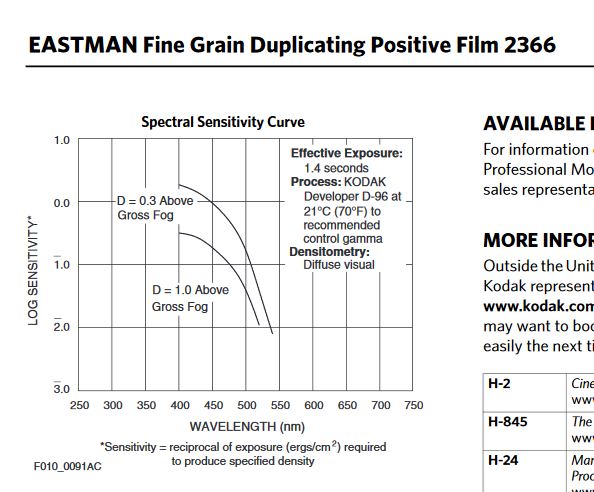

Someone didn't look at the spectral response curves of 2366, which clearly show it about halfway between being blue and orthochromatic response.
For a quick and near ortho response, it is suitable.

... Someone didn't look at the spectral response curves of 2366, which clearly show it about halfway between being blue and orthochromatic response. For a quick and near ortho response, it is suitable.
Kino,
Interesting. Yes 2366 seems to be about halfway between blue-sensitive and ortho. It would be interesting to compare all three with a multi-colored subject and see the differences. I'm not sure how much difference the extra sensitivity would actually make compared to blue-sensitive film, since 2366 begins falling off rather soon, already at 400nm, and density is pretty low at its highest sensitivity, about 530nm. Ortho emulsions are pretty sensitive up to about 580nm from where they fall off rather rapidly, i.e., a rather sharp, steep drop.
