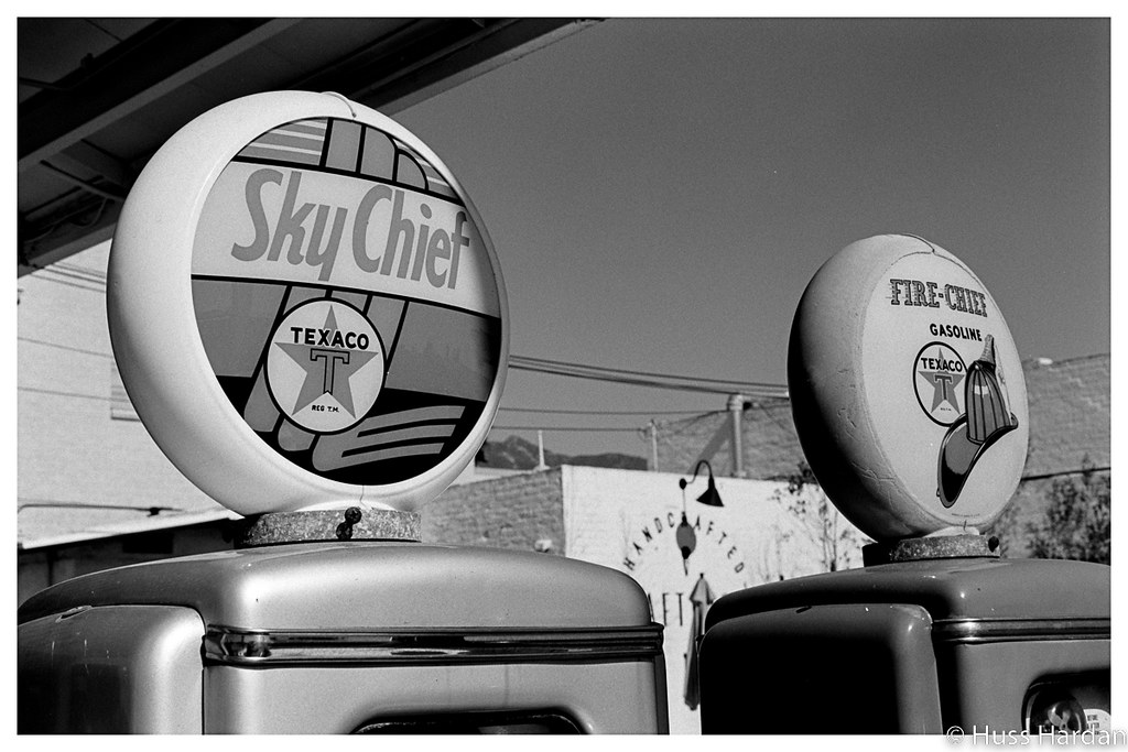

I don’t understand the ISO 40 claim. I shot this at ISO 200
You actually shot it at an EI of 200, and that difference of terminology is actually the crux of the matter.
You have a visual style that under-exposing and push processing is suitable for.
So that is what you have done, as shown in this and many other good examples you have posted. Each of those reveal exposures with reduced shadow detail and enhanced mid-tone contrast (from push processing), which appear to be the type of results you and many others prefer.
And you choose subjects and expose them in a way that takes advantage of the film used in that way.
For what you do, using the film this way suits your needs very well.
But the EI of 200 (or the 320 in the name) is a special use of a film that appears to have a much lower native light ("ISO") sensitivity, using the sort of tests that film manufacturers and marketers normally use to help customers compare products offered.
If this film was marketed as a low-mid speed (ISO 50?), fine grain film that also offered really good results when shot at EI 200 or higher when push developed, that would have been excellent and far more honest. That would be similar to how the Ilford and Kodak "3200" badged films are designed and bdged and marketed.
If CatLabs had chosen to describe the film that way, it would have been honest, while still highlighting a particular advantage of the film. And there would have been no controversy in this thread.

I didn’t push process anything w the image of the gas pumps. Shot it at ISO 200, gave it to my lab to develop w no instructions to push etc. They just developed it in Tmax as they do all their B&W film.
As for deliberately picking subject matter/lighting, on this roll I also shot a bunch of interior scenes for the very intention of seeing how it would perform. Again, as above, lab developed no push etc because it was the same roll of film!
The "standard" development recommendations out there are the ones from CatLabs - they are effectively push development recommendations.
An ISO development for the film, with metering at the ISO speed, would result in very different results.
And how were you metering? Some sort of special or critical metering seems often mentioned as a caveat for several lines of thinking in these threads. Additional clarity on your successes might help.
I don't mean to be flippant here, but I meter the way I would with any film given whatever the scene is. I do what I always do, meter for what I want 'correctly' exposed.
I didn't do anything special with this film, and that was my specific intention because I wanted to use it as a regular, unsuspecting, innocent buyer would, who has never heard of Photrio....
Which is also why I dropped it off at my lab, with no instructions as to how to develop it because I wanted the experience that a regular civilian would get. Not someone deep in the weeds uncovering the mysteries of this film that frankly no-one else outside the 10 or so people on photrio care about.
My take away? Do not develop it in DF 96 monobath as the results are very inconsistent. Regular developers like Tmax work great. If you want a punchy, very fine, ISO 200 film this is it. Bonuses are it is very easy to handle as nothing dries flatter. And it is only $6.99/roll.
