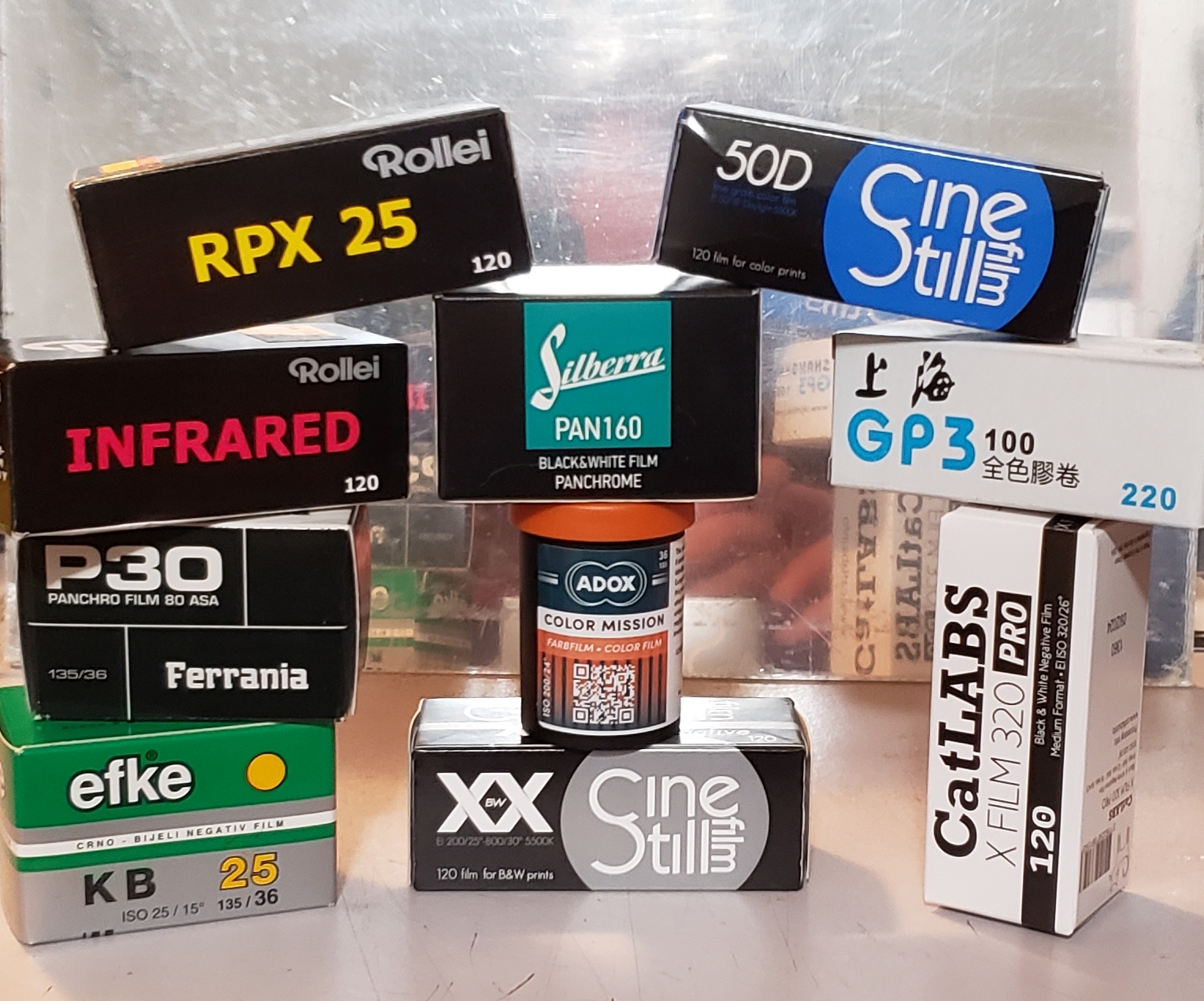

I have a boatload of film, everything I have from Kodak, Fujifilm, and Ilford has an ISO film speed rating. I have Portra 800, it is ISO 800. I don't have anything above 800.
Wrong answer, most likely. :smile:
I'm not sure "I can't understand what you are asking" is ever the wrong answer to any question - even in abbreviated form.
Would anyone have bought this film if they knew it was rebranded Agfa Aviphot 200?
