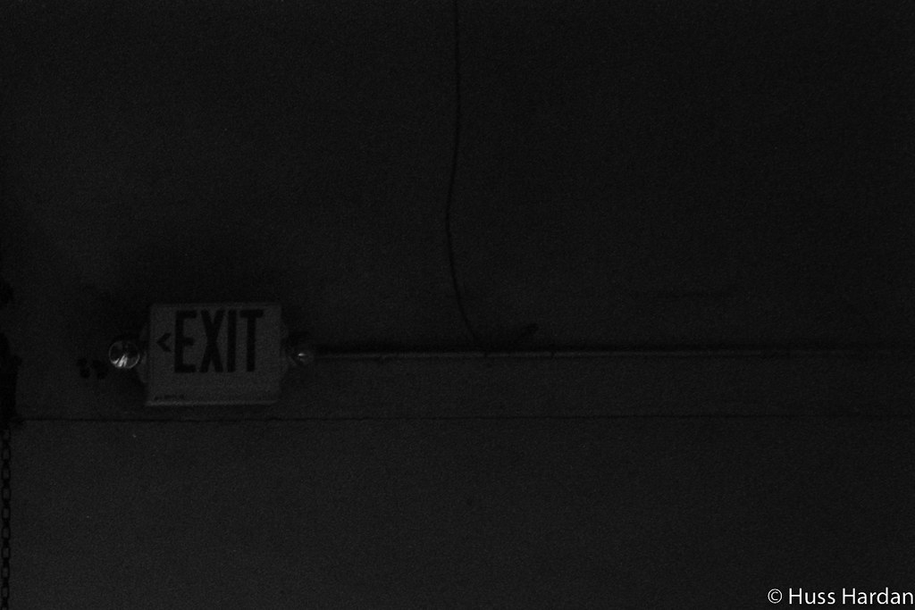

Shot at ISO 200, given to local lab to develop w no instructions, TMAX developer.
Metered off the wall just before the entrance. Full image, then 100% crop from highlight area, 100% crop from shadow area.

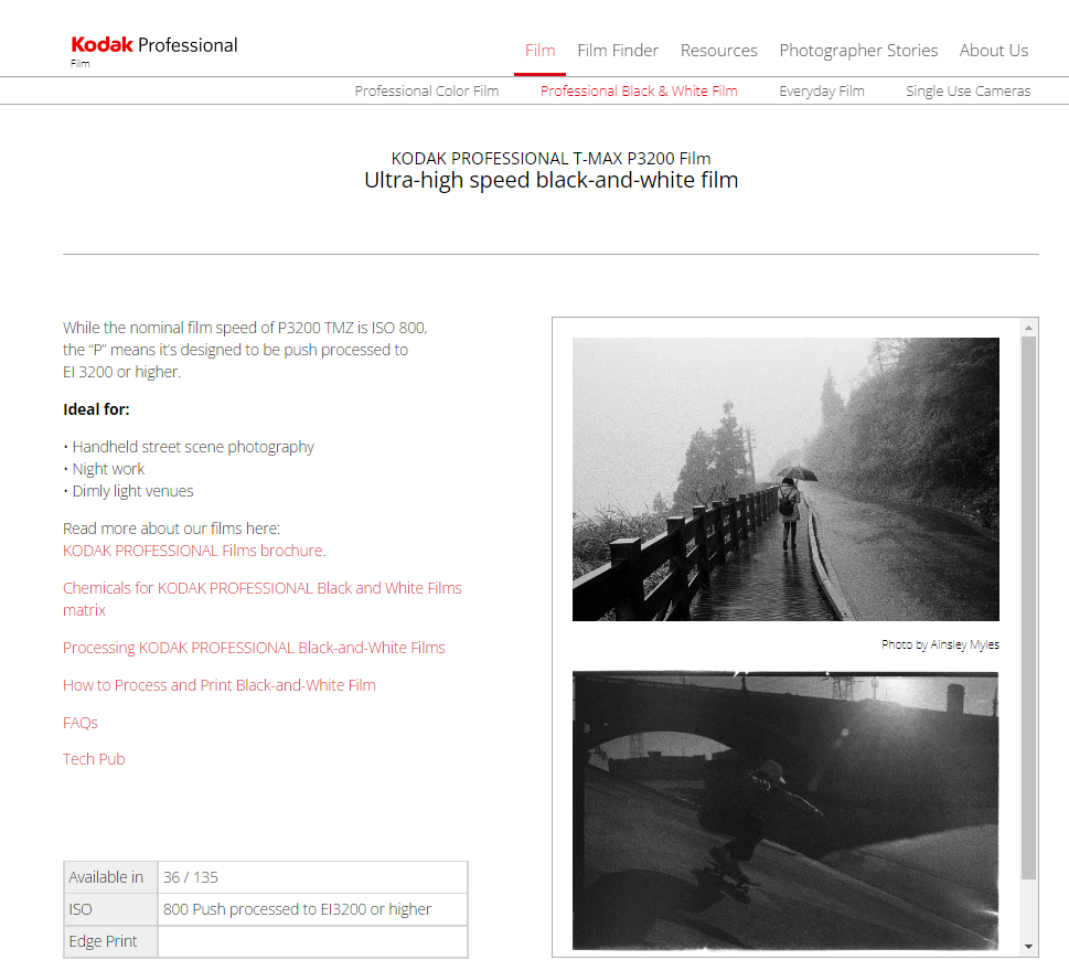

Here is the Kodak website information - how does the CatLabs compare?
The comparisons aren't that important though. The Kodak product is part of a family of film, with relatively extensive marketing and technical information available in many forms, from several sources.
One can relatively easily come to a conclusion about which Kodak or Ilford product makes sense for one's needs by reviewing the publicly shared information - both directly from the manufacturer/distributor, or from the legion of prior users.
The same applies to the Ilford product.
CatLabs chooses to share what CatLabs chooses to share.
