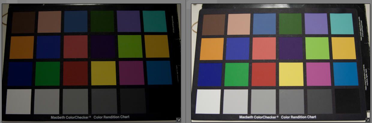

If the incident meter says ISO 100 1/100 f/16 in bright sun, you expose both color neg and color slide to that reading! If you want a little bit better color saturation in the slide, yes you might give -0.33EV or -0.5EV to that reading. And if there are shadows that you want to not get muddy color from color neg, you might add +0.5EV or +0.66EV to that reading. But ISO 100 1/100 f/16 in bright sun is correct for both.
But when you are taking a reading off a white target with a reflected light meter, you have to ADD exposure to what the reflect light meter suggests, or you will get grayish white wedding gown from the reflected meter reading unadjusted.
Example: left shot was one-degree spotmetered aimed at the White square (far left, lowest row), whereas the right shot was incident metered
If the left frame was filled with white wedding gown, it would have been simularly underexposed because the reflected meter assumed the scene/target averaged to a mid-tone (it got fooled by a bright target). One has to ADD exposure to the left shot meter (reading of white gown) to arrive at the 'proper exposure' where white is white and not gray...On left shot 1/30 f/5.6 was suggested by meter, on right shot 1/30 f/2.8 was suggested by incident meter -- MORE exposure is needed than what was suggested on left. Else we get the 'gray white' seen in the left shot.
