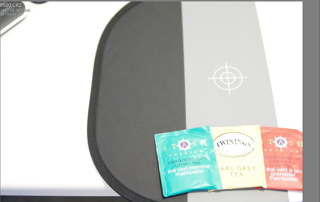

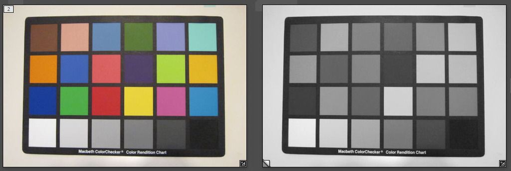

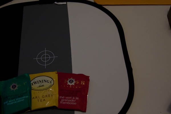

On this discussion of 'is my meter wrong?' let me offer this insight...
All too few amateur shooters understand that the meter is 'accurate' when the scene being metered AVERAGES TO MIDTONE density. What is 'midtone'?...
...square #4 of the bottom row of this card,
...or the center section of the above target.
If you read the white area of this target (instead of the grey area) with a spotmeter, it results in underexposing your shot by -1.8EV
If you read the black area of this target (instead of the grey area) with a spotmeter, it results in overerexposing your shot by +2.1EV
So you need to consider if the area read by a meter is brighter or darker than the 'midtone average', and if it is then you need to crank in a bit of exposure compensation (i.e. not center the needle in the circle as seen in post #51)

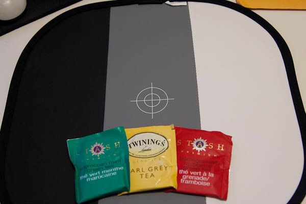

If you meter the white area and expose for it, notice how underexposed the grey area (with the bullseye target) looks
or if you meter the black area and expose for it, notice how overexposed the same grey area (with the bullseye target) looks
rather than looking like this...
We need to keep in mind that our brain may be fooled by the apparent brightness of different colors. Look at the same color chart, with the color content removed and only the relative brightness of the colors shown...

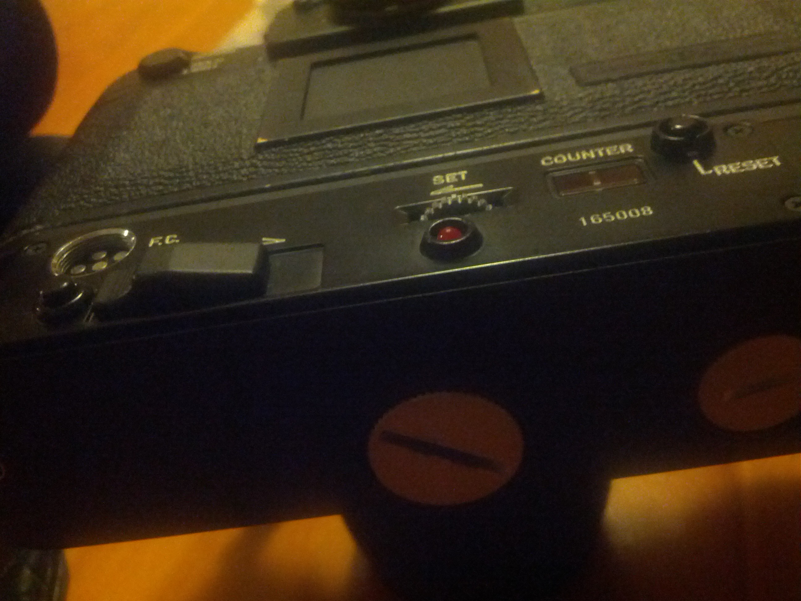

Yeah it's the external powered winder. Cannot find any such compartment when I last checked for it as saw it in a manual what you were referring to.

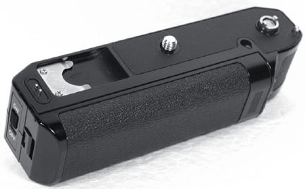

AgX
Apr 5, 2007
29,972
Germany

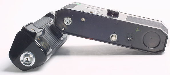

The Motor Drive F has got a round recess (might be threaded) at its top to (I assume) take that cap:
The Motor Drive FN has got a threaded recess at the rear of its body to take that cap:
Power Winder FN:
I don't know
A.-series winder A2 got has got a threaded recess:
A-series Winder A got that compartment with a clamp:
A-series Motor Drive MA got that compartment with a clamp too:

Cheers yes it's the FN winder. I knew the base plate to the right fitted however there was no cover on the back left hand side as I assume it was being used with these contacts being accessed.
Will take a photo of the base plate when film ended and I remove the winder.
Cheers for the help though. :smile:
apologies for the dodge camera phone job lol
