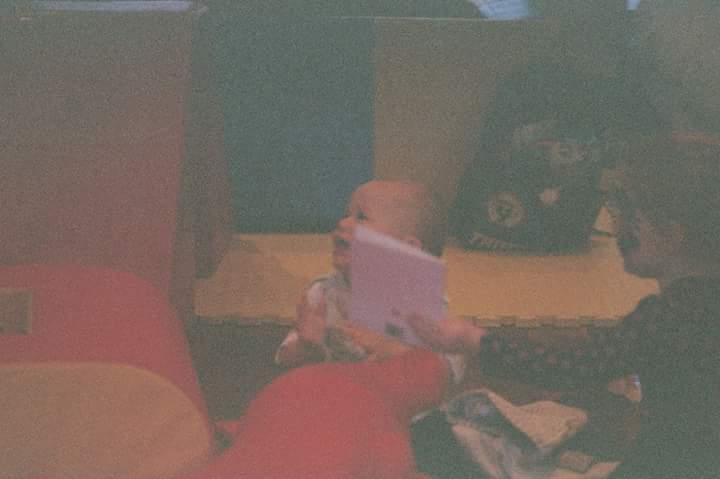

Here's some examples I was getting first one is the same for most of the roll.
2nd one towards end of roll.
Is this just caused by under exposure.
Were you shooting color neg? The first example is pretty typical of color neg which was underexposed pretty signficantly, resulting in 'muddy' shadow areas and poor overall saturation.
fujifilm superia 400 C41 colour

But screwed up processing would not have the result stated, "I was getting first one is the same for most of the roll. 2nd one towards end of roll."

With color negative film, you really want to avoid underexposure.
You can overexpose color negative film a few full stops and still have a decent image to work with. Typically, I overexpose one stop.
