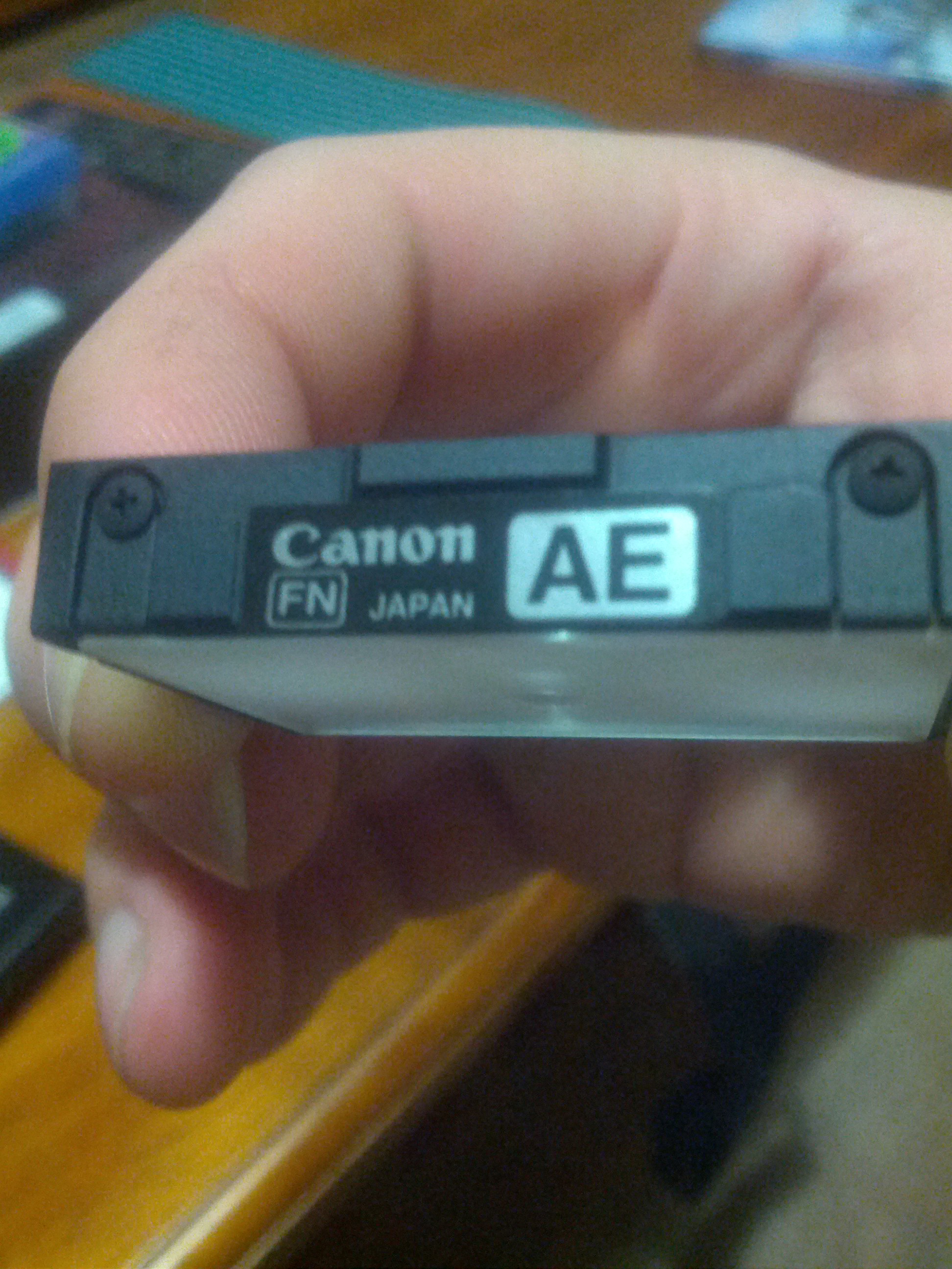

It's average metered, standard screen, it was stock with the AE prism but as I see I think you have the standard prism that should come with the PE.

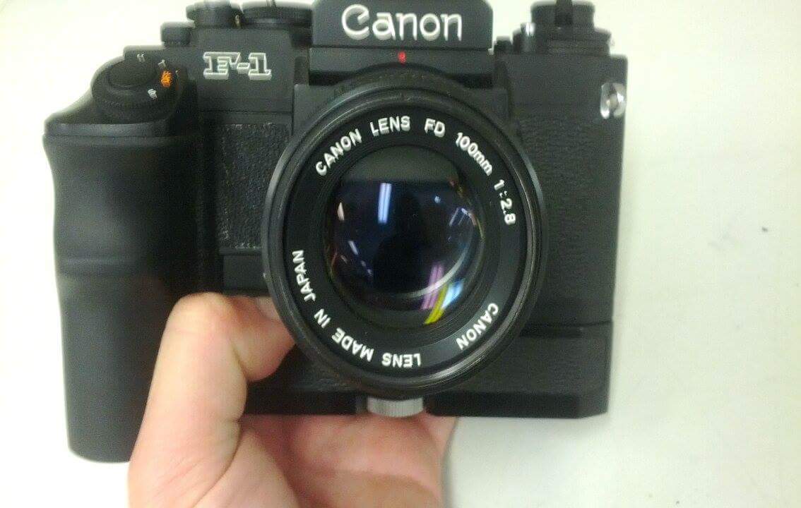

Yes you have the Canon F1N not the F1n you have indicated in your title of this post. A few changes were made on the new model such as the battery. The finders can be used on all 3 models but the winders are different in the first 2. I have never owned the N model of F1 but I think that the newer model you did not have remove the baseplate of it before installing the power winder. I maybe wrong about that but I have been wrong in the past ;o)
The F1N is mechanically a very different camera to the F1/F1n. Canon reworked most of the internals to include such features as silicon photocell metering and an electronically controlled shutter amongst many other component redesigns. Finders / winders / focussing screens are not interchangeable between F1/F1n and the newer F1N.

I not know too much about the winder other then looks to be the external power operated one. I not have the base plate screws because of this so currently have to have grip installed.

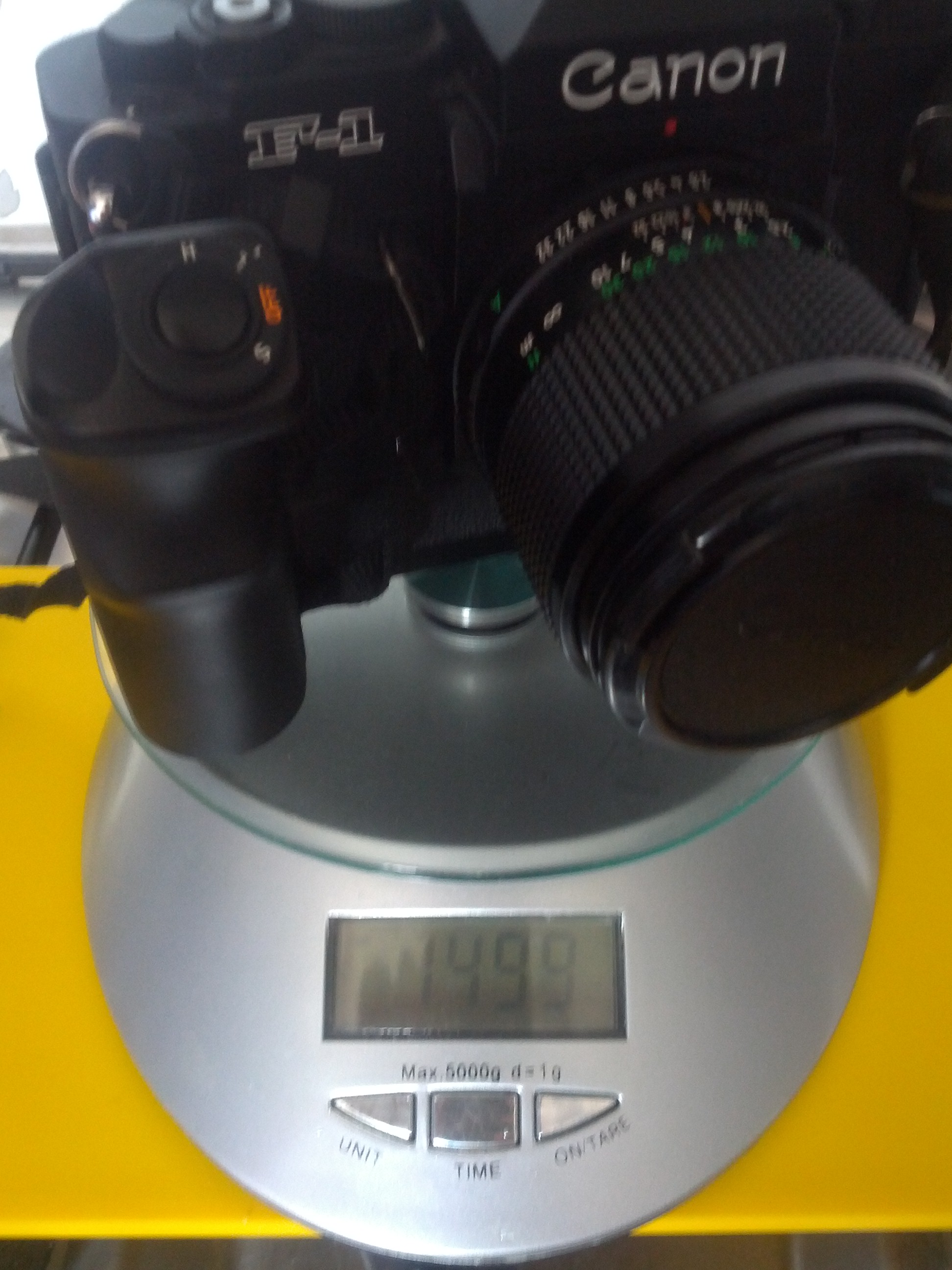

That's not too bad considering you have the winder attached. I have just weighed my F1-N with the non-AE finder and a Canon FD 35-105 F3.5 lens without motor / winder at 1.496 Kg. I don't have a winder and that probably contributes 600-700g to the total weight.
The sports photographers who use to schlep more than one body with the fast telephoto lenses, think 300mm / 400mm f2.8 lenses would have been toting quite a load in their day. Having said that, the current range of high-end d*g*t*l SLR's with fast tele's won't be much lighter and those AF lenses have motors in them.
Yeah I would like to drop the winder off for some trips but not have the base screw caps. Any way I can fix this as I think I would be able to find any now and winder only serves as a grip as currently have no power for it.
I have both styles of F-1. Bought my first New F-1 a couple of years ago after many years using the original F-1. I figured I just had to have one to see why so many people thought it was such a great camera. And I've come to understand -- mostly because it is built to an unbelievably rugged standard. Even more so than the original, which I would have found hard to believe until I owned a New model.
Anyway, shortly after buying the camera, I bought a motor drive for it. I was surprised by the number of port screws I had to remove to mount the motor drive. It was like four or something? Sorry, the motor is mounted to my F-1 and there's film in it, so I can't dismount it to count. I do have the screws put away somewhere inside a film canister so I won't lose them though. But given your predicament, should you ever want to dismount your winder to forego the added weight, first go to your local camera shop and ask if they sell "gaffer's tape." They should, if they're a real camera shop. If not, you can find it online. Basically, gaffer's tape is like black masking tape, but better quality than masking tape. So all you have to do is use some gaffer's tape over the holes that are left in the baseplate when you remove the motor or winder. This should block all light and prevent damage to your film. And in the mean time, keep your eyes open on eBay for anyone selling the baseplate port screws you're missing.
As for your exposures -- and wondering if your camera is metering correctly. This is also easy to determine and is something I do whenever I buy a "new" camera. Assuming you have some sunny weather going on, take the camera outside with a lens mounted and point it to a quadrant of the sky away from the sun, where it's a nice, deep blue color. Meter this open blue sky. If your meter is accurate, it should agree exactly with the "Sunny f/16 Rule," which is the shutter speed closest to the reciprocal of the film ISO at f/16. E.g., at ISO 100, this would be 1/125 @ f/16. If your camera's meter is accurate, it will read exactly that value. Chances are very likely, it will. My experiences with the original F-1 are that its meter is very accurate -- always. And I suspect the New F-1's meter will be just as accurate and just as rugged. If, on the odd chance, it is reading a bit off, I'd have a repair tech do a CLA and be done with it.
