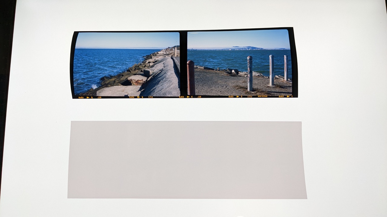

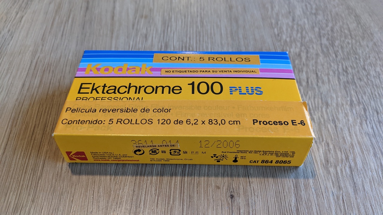

Hi, I'm puzzled by a batch of expired Kodak EPP 100 slide film I bought off eBay recently. After development, they turn entirely clear without any images. I have used tons of expired film, both B&W and color, slide and negatives. Even super expired film can produce images, albeit grainy, has base fog, losing sensitivity, has strong color cast, etc etc. This is the first time I got absolutely nothing from a roll of expired slide film. They are all sealed and have expiration date of 2006. Have you ever experienced this? Any possible reasons? I still have 7 rolls left and it will be a shame to waste all of them.
I ruled out the camera issue or the development issue because
- I used the same Rolleiflex 2.8C (most trusted mechanically) for two rolls of film: one Ektar 100 turns out great, but EPPP100 turns out nothing
- I developed two rolls of film in one tank (Unicolor Rapid E6 kit): the Velvia 50 turns out fine, but EPP 100 turns out nothing
- I developed yet another two rolls of film in one tank again (Tetenol Colortec E6 kit, fresh): the Fuji Provia 100F turns out great, but EPP100 turns out nothing. See below image: top is Provia 100F, bottom is EPP100

Some film packaging images. Expiration date 2006, all sealed, never opened.

Looks it was exposed to light.
Yes, in its entirety. Very odd, given that the foil wrappers seem to be intact.
fogged by x-ray in shipping?
Well, the pattern would be atypical in the sense that there's no pattern...typically with xray fog, you get some kind of pattern with variations in how badly a particular film segment is affected. Could be wavy lines, straight lines, more or less sharply defined, etc. But I've never seen an x-ray damage example where the fog was absolutely complete.
I'm stumped!
Both of you might be right: DEA super x-rayed it, and then burned it. 🤣
CIA used it for target practice with their super advanced & secret high power death-ray infrared laser experiments.

So where are the trace images on this film? Also, this expired in 2006. You'd expect the clear film with trace images on film stock from the 1980s or early 1990s at the latest. Film from 2006 will generally yield a recognizable image. Unless it was stored on top of a bread oven in a bakery, I suppose. Or a south-facing windowsill. Either way, storage conditions must have been phenomenally bad for the film to be essentially entirely fogged all across.
