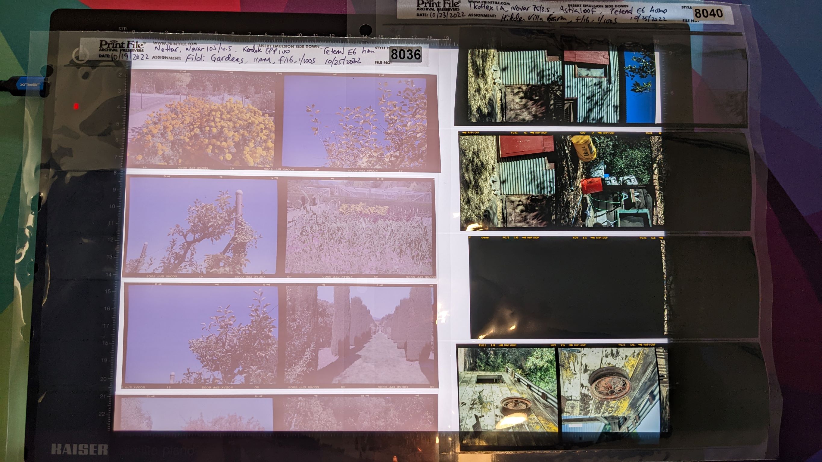

In the name of science and self torture, I got a few Ektachrome Plus EPP100 film from another expired batch. And this batch seems to be half way from usable to totally lost. You can see the color dye is definitely fading, e.g. some of the blues are missing so the sky has this purplish tint. And overall there is this milky haze. Even the edge of the film, which should be jet black, now has a purplish dark gray tint. With some tweaking in scanning software (levels), I can still get usable images. But there is quite strong color shift, which is difficult to totally remove in post. Of course, you can always use it as is for its unique pastel color palette.
Side by side comparison: left is expired EPP100, right is fairly fresh Fuji Astia 100F. Both processed in the same tank.

I bought a small lot (20 or so rolls of 120) shortly after they were discontinued, and kept in cold storage since. The expiration date is 2006-09, but they are "fresh" in terms of image quality and ISO ratings. I particularly like their rendition of skin tone and people, both in natural and flash lighting. But since there is so little choice in fresh chromes nowadays, I use them for general photography as well.
