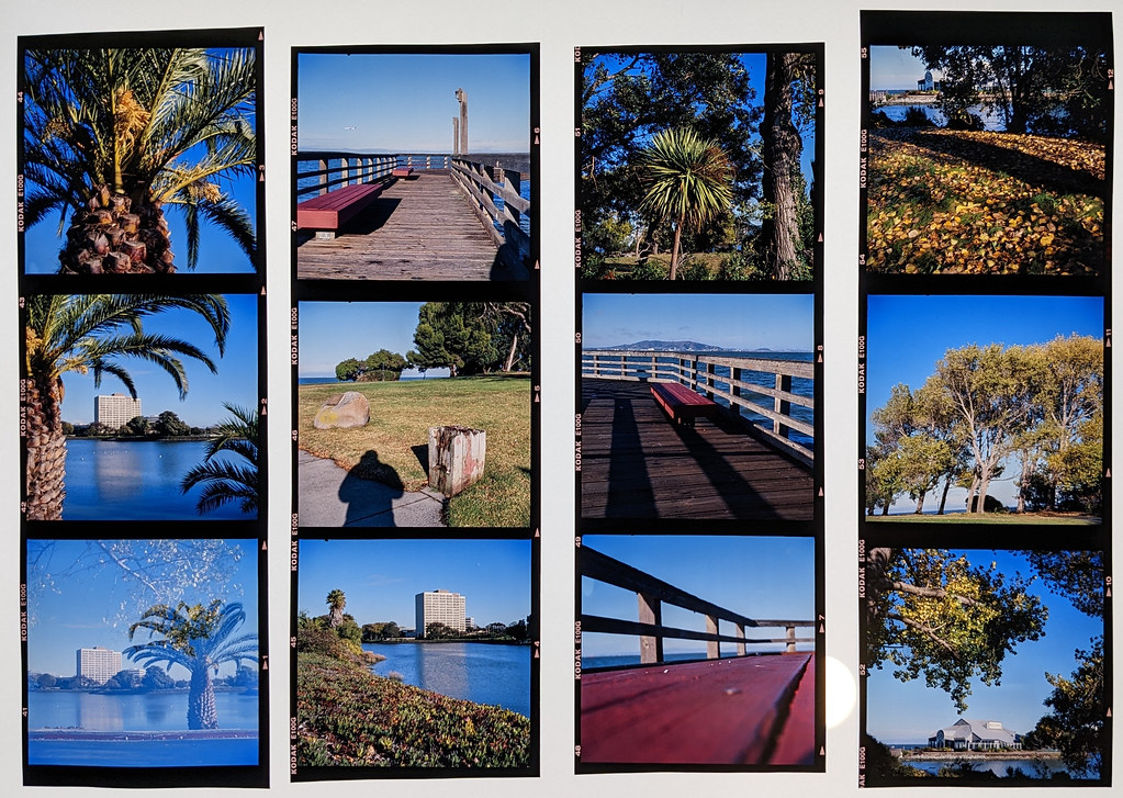

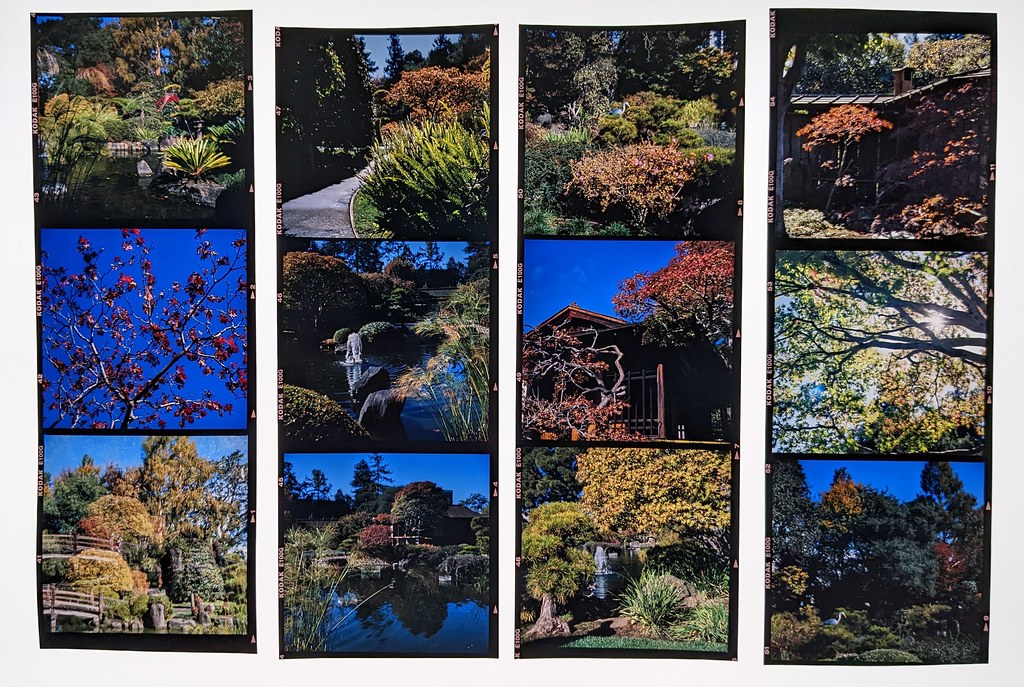

I was lucky to get 10 rolls of E100G (exp 2013-01) recently that turns out to be gorgeous! In full sun, the fall colors and blue sky just pops. I prefer E100G over Astia 100F for landscape, especially in the vibrant fall color season. A few contact sheets of late, both home processed in Tetenal E6 kit.
Contact sheet Ricohflex E100G second roll by Zheng, on Flickr
Contact sheet Ricohflex E100G first roll by Zheng, on Flickr
