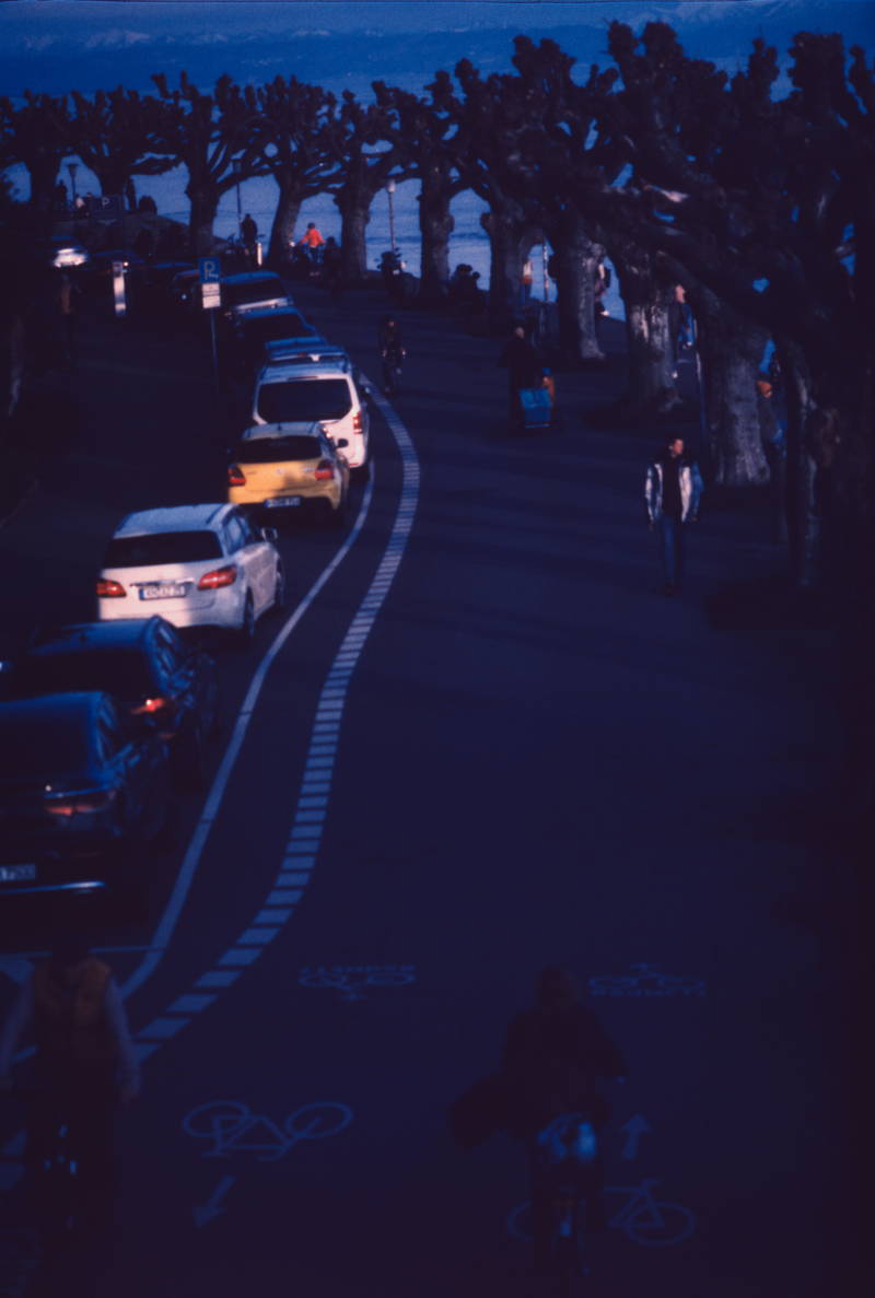

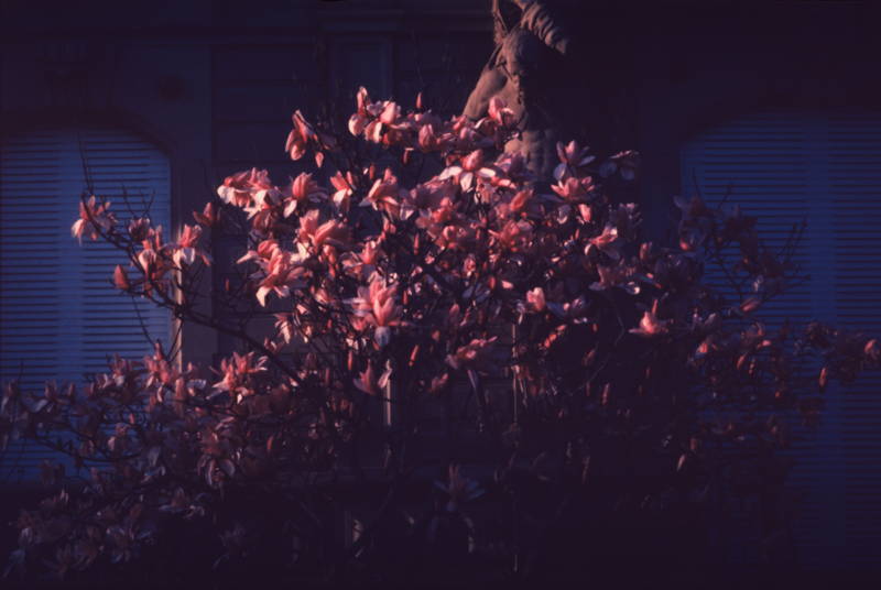

So now i have developed it 20 minutes in HC 1:11. I could have paid more attention to the temperature, but thanks to you i think i am on the right track now...
For the next film i will lower the ASA setting
still a bit dark,
I don't know how the slides could be anything else than "a bit dark" -- using cyan dye to offset the orange base is like including a ND filter in the film.

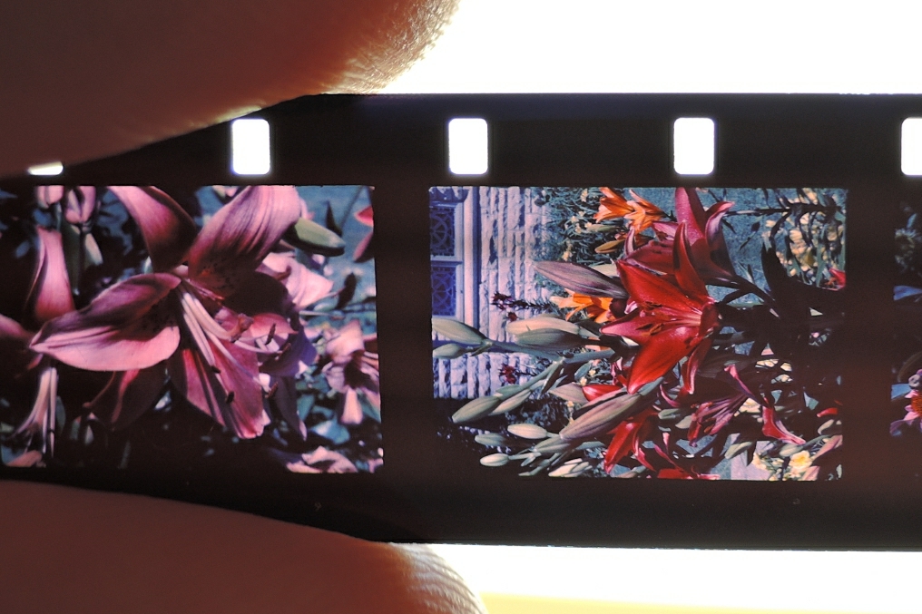

After lots of tries with little sucess i think this evening i got the break through..
I tried with richer developer (Fx-39 1:9 for 25 minutes), bracketing and a doubling of bleaching time and in the first time i got some promising results.
I will show the scans when it has dried.
I have the impression the bleaching time was way to short in my last experiments...
