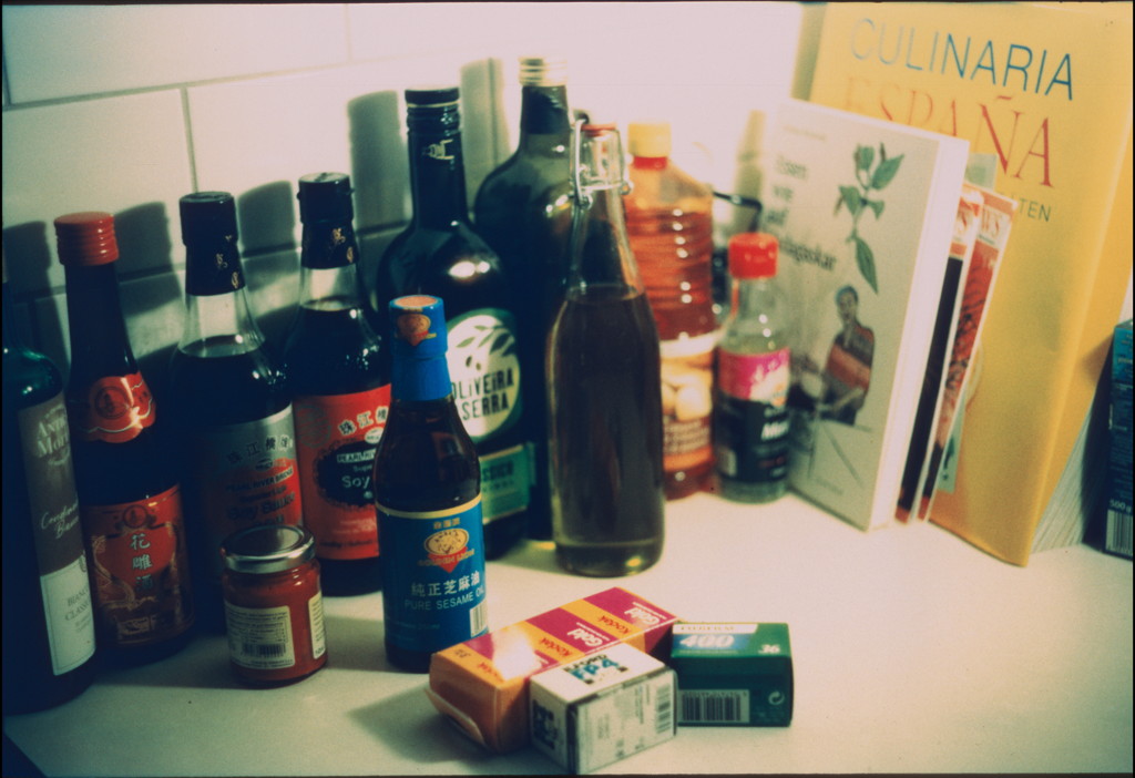

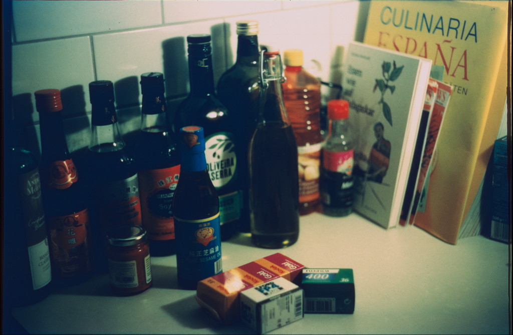

I got as far as this:
... after playing for a few hours some years ago. I can't find notes on filtration and first developer used (I think I used Dektol).
There's a single print example @Photo Engineer in this specific post here: https://www.photrio.com/forum/threads/printing-color-slides.117418/#post-1554979 (fifth image)
The best result I've seen was some guy in I think the US a couple of years ago who printed his Ektachrome slides onto Kodak Endura. The caveat is that only a few landscape images were shown, and they mostly had fairly low dynamic range. IDK how well his process would have gone with more contrasty slides and things involving more critical stuff like skin tones. To be honest, I'm skeptical. The process is inherently difficult to control.
A compounding problem is that the bleach you'd have to use would almost certainly destroy the antioxidants embedded in the emulsion. Those are there to protect the dyes against the influence of stuff like ozone, so reversal processing will generally result reduced archival stability. For most home printers I guess that won't make all that much of a difference, but for anyone embarking upon this with an eye on using this for serious art that will become part of collections, it's a problem.
That's pretty good; I've not seen all that much better to be honest.
That's a scanned reversal RA4 print from a slide?
Yes.
It's very high in contrast and there is a prominent cross. I didn't think it would be good enough for prints from my slides so I didn't pursue the matter further. And I lack chemistry knowledge to tweak the first developer which I'm pretty sure is needed to get better prints. I might try some other BW film developers, but that would be just going in blind and hope for a lucky break (which usually don't happen for me)...
Yes.
