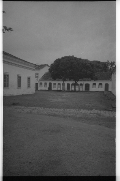

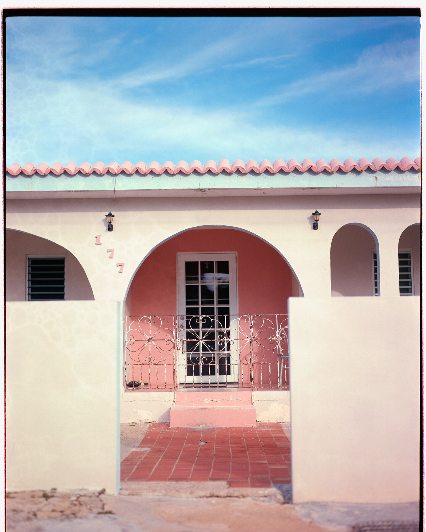

Well, just developed a few more C-41 rolls and this was the first one, tad underexposed Portra 400 shot by a friend, bubble marks in one picture closer to the start of the roll.
as before, 650ML developer in a 2520 2-reel Jobo tank, rotary processed, in this specific case only this roll was loaded but two reels were used, 2x 30 seconds pre-wet before the developer step

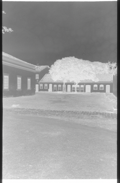

attached below is the same frame as inverted in NLP and i tried to show the bubbles in frame two. it is less noticeable than before.

There is a difference with how the bubbles form in your example than mine. They are all across the frame in yours. This makes me think that somehow the bubbles are remaining in place as your film spins rather than sitting on top of the liquid. I am assuming you do not tap the tank to dislodge any bubbles while it is in the jobo. If you are replenishing developer it may be that the solution has become overly foamy to the point of longer being workable. Did someone say replenished developer is not "recommended" for rotary processing? Perhaps the developer enters the tank quite foamy and sticks to the negative for long enough to create this effect.
Then again, only mildly visible on one frame of one roll? That margin of error isn't bad.

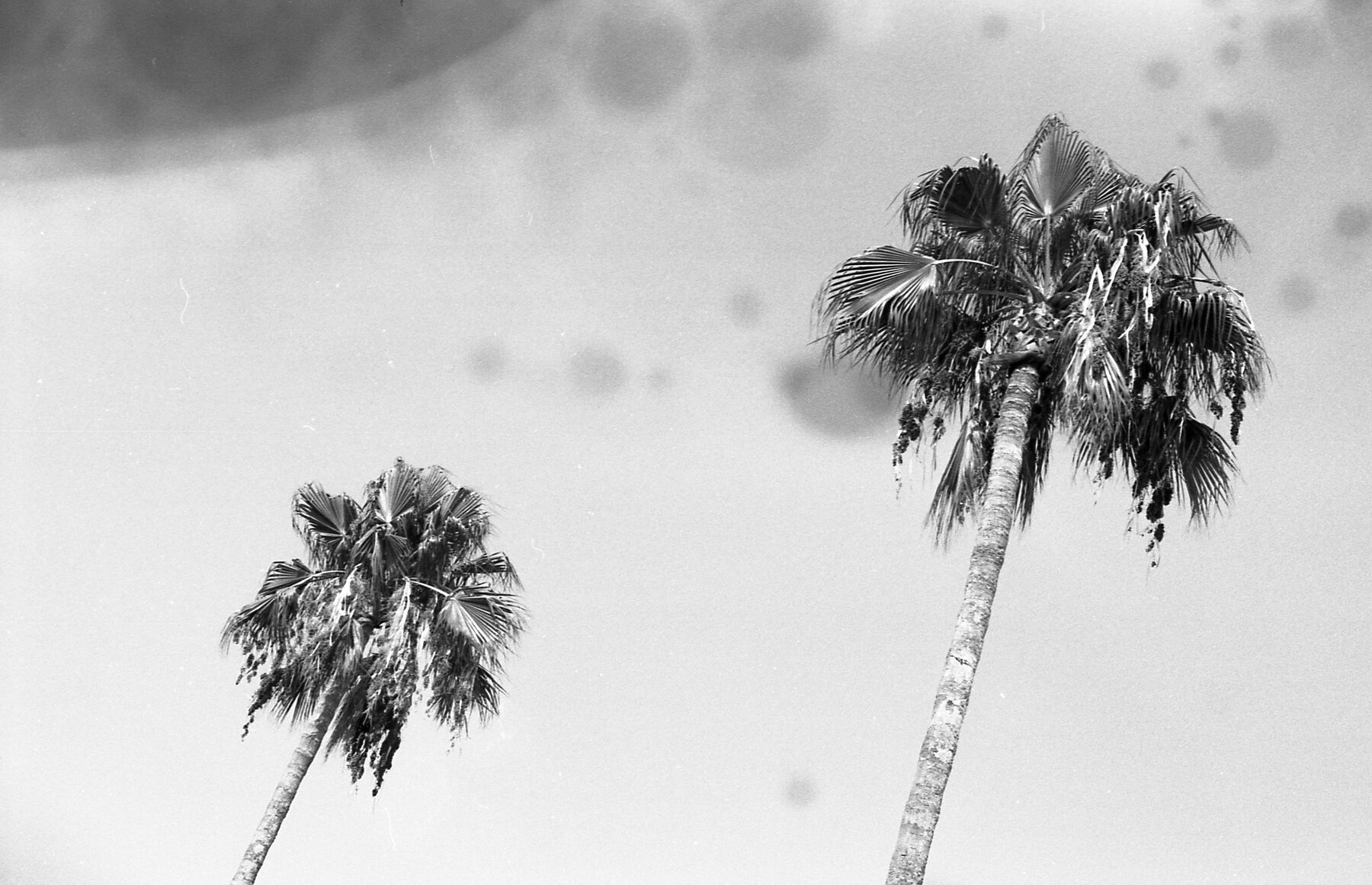

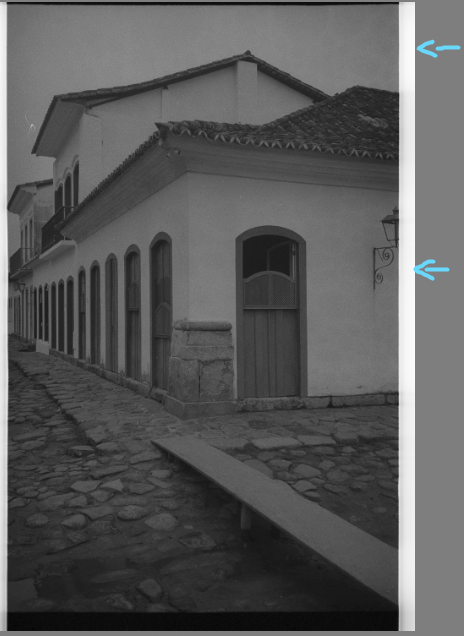

Well.. good news doesn't last. my issue with C-41 returned and now i'm facing it with black and white too. washed everything with citric acid and a toothbrush. a few days ago i did 2 rolls of black and white and then C-41, got marks in both. after cleaning i did a few more bw rolls and i see the marks again.. a friend suggested that i try using filtered water instead of tap. i wonder if something in my
water changed and could be causing this.

thinking hard i'm still pretty sure the foam happens in pouring out. i understand why it happens with my C-41 developer but i don't get why it's happening with D-76 1:1. the developer doesn't foam too much and as said it has never happened since i started using the machine 6-7 months ago

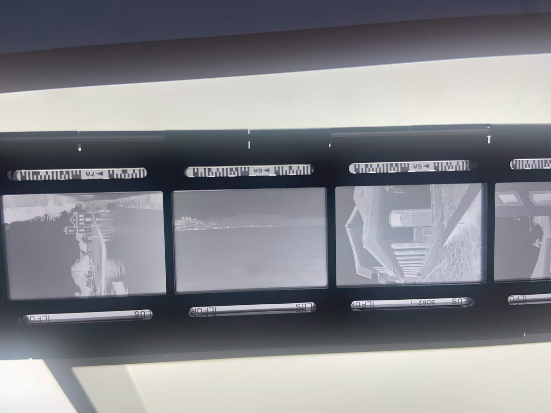

this is the best i can do, i took a picture with my scanning setup with the camera but it seems my card reader stopped working. i could also send the coolscan uninverted file or scan it on the v700. it's hard to see in the picture but i can see the bubbles in the edge of the frame. the inversion posted previously was just inverted in NLP with default settings, it was the more obvious example but it also happened in other pictures of the roll, even towards the end

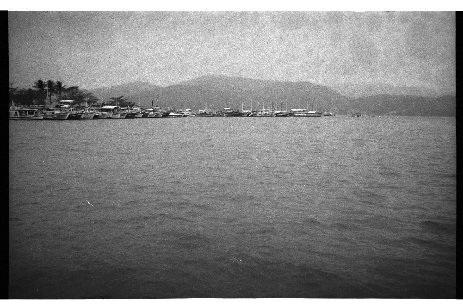

here's another example, this time inverted manually with just a curve inversion
Those negatives look a little on the thin side, but it's not an explanation for the bubble patterns.
I'd do a couple of sessions by hand (no Jobo machine) for B&W. I bet the problem doesn't occur in that case, but it would be interesting to verify.
