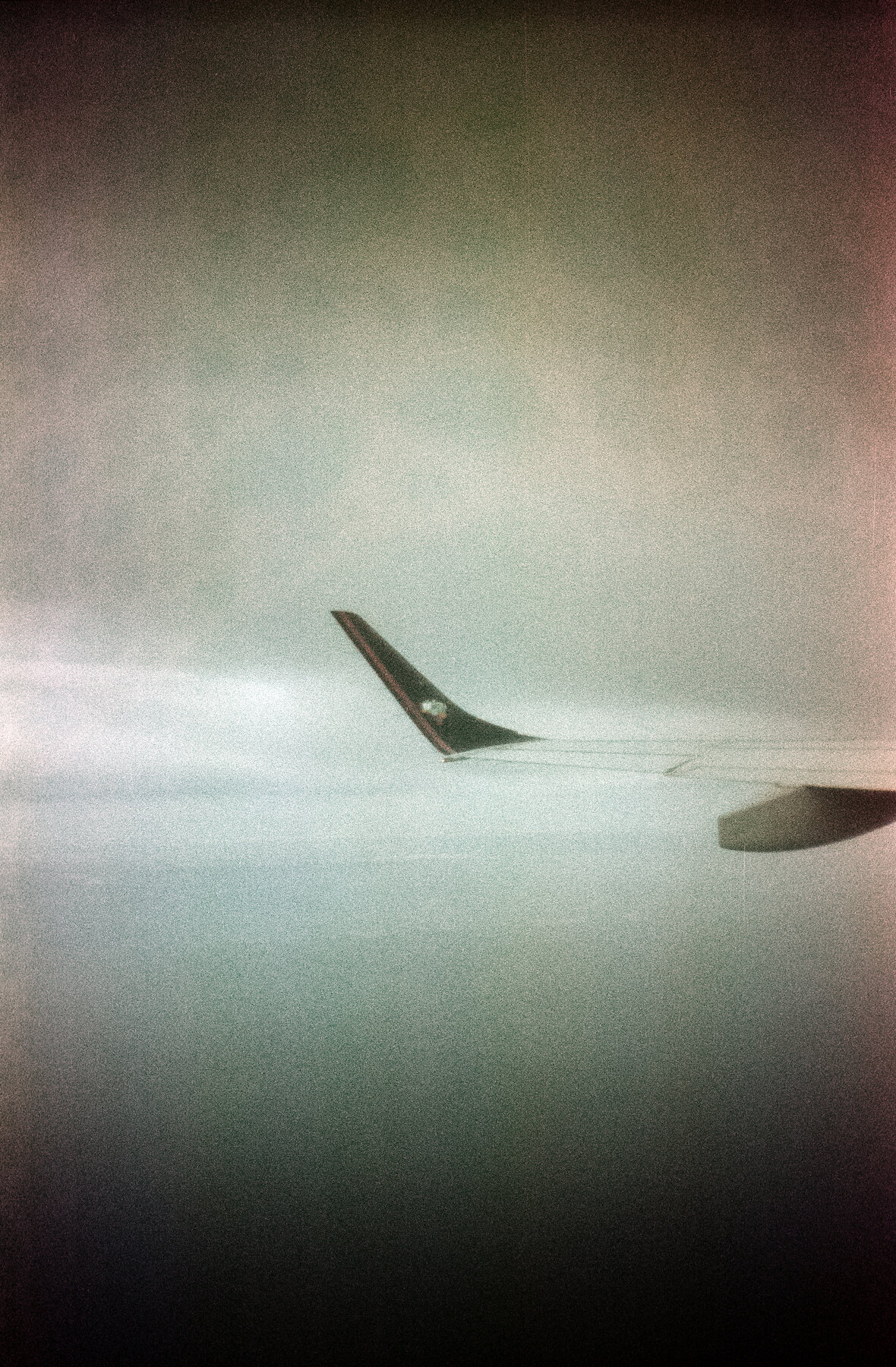

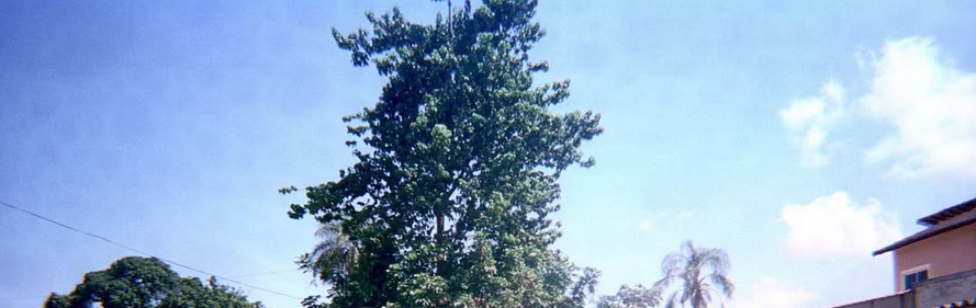

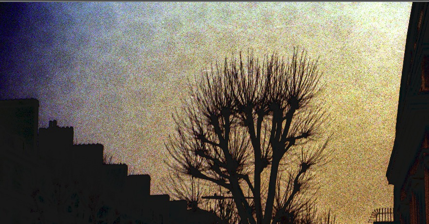

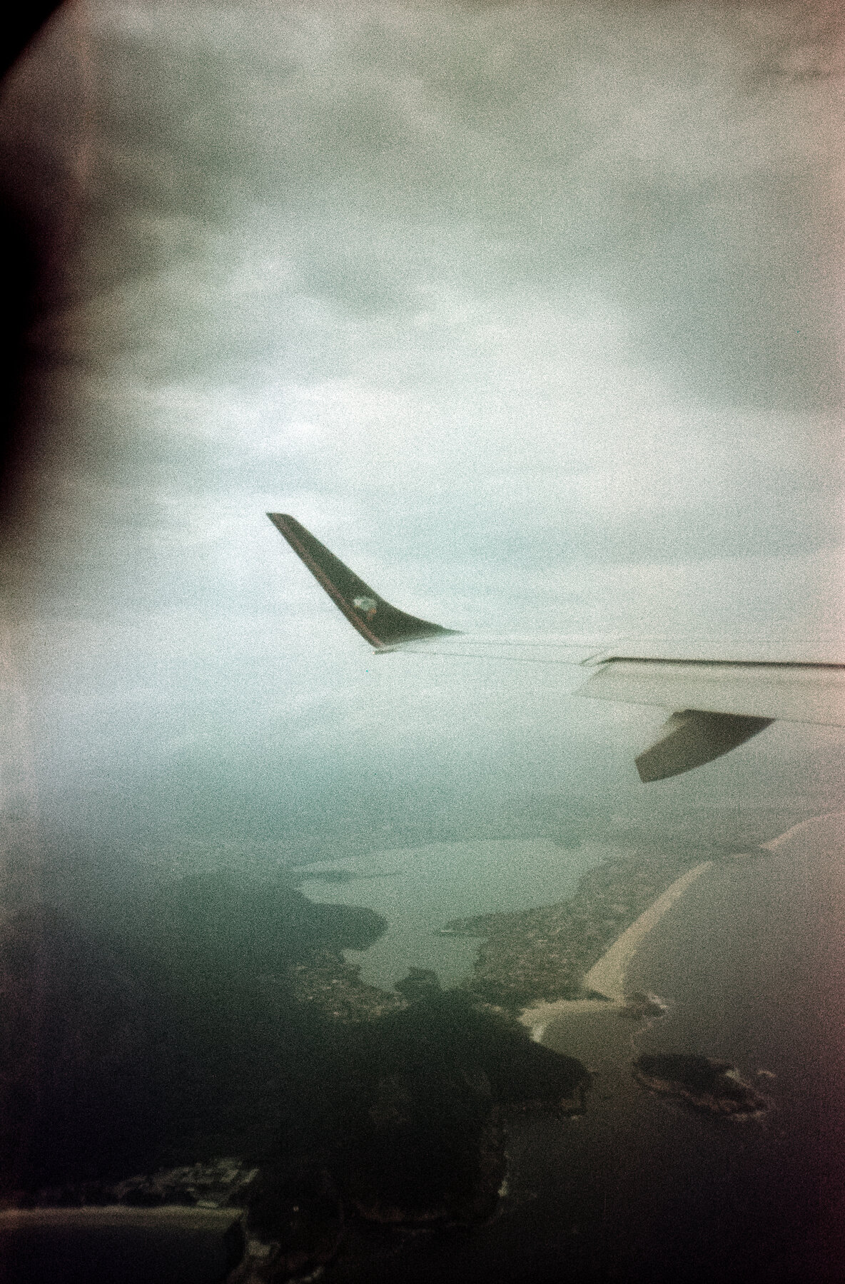

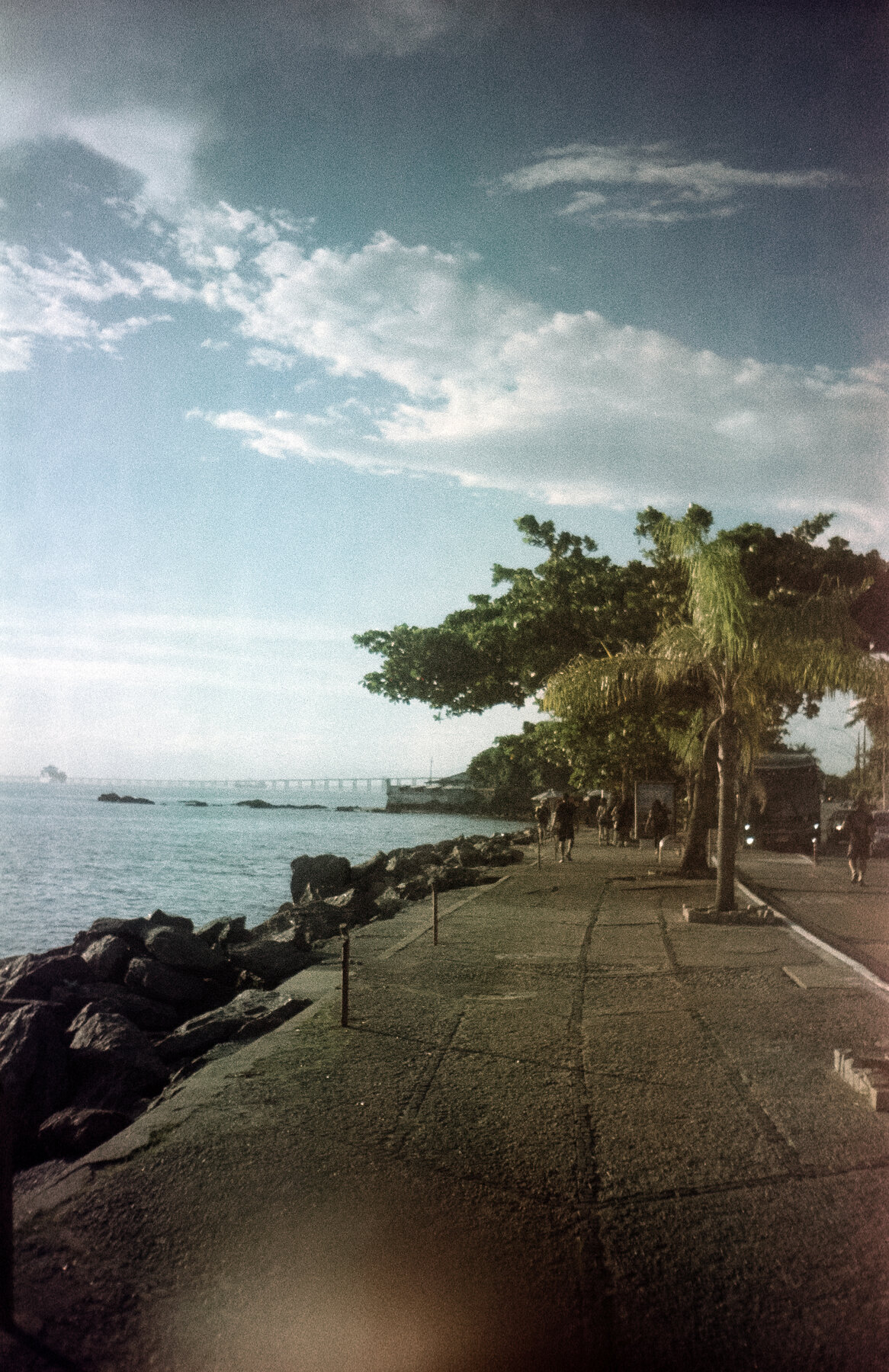

Here are some examples, generally it occurs in sky areas at the start of the roll, usually frame 9-11.
1st and 4th pic were exaggerated in LR to more clearly show it.
3rd pic is from an expired roll that had marks even on frame 36.
sometimes only one roll out of two will be affected by it.

Thanks for posting the examples. When you say they appear mostly in the sky areas, I assume they are present in other areas as well, but they go unnoticed due to the structure of the image itself. As to where they appear on the roll: it might be useful to be able to see a full section of the film so it's clear where they start and end, insofar as that's visible. I understand this may be difficult as it may involve clients' photos that you're not at liberty to publish.
My first guess here would be that these problems are associated with too much time between draining the developer and filling with stop bath or bleach.
FWIW I always pre-wet with 38C water and have never had this issue. This also rinses out the excess dyes (?) that many C-41 films shed. Expired rolls in particular shed much more dye in these initial rinses, and the rinse water can be quite foamy until it runs clear. Sometimes it takes 5+ fills for the water to finally run clear.
However, I run inversion cycles by hand and do not use a jobo so perhaps this is not relevant.

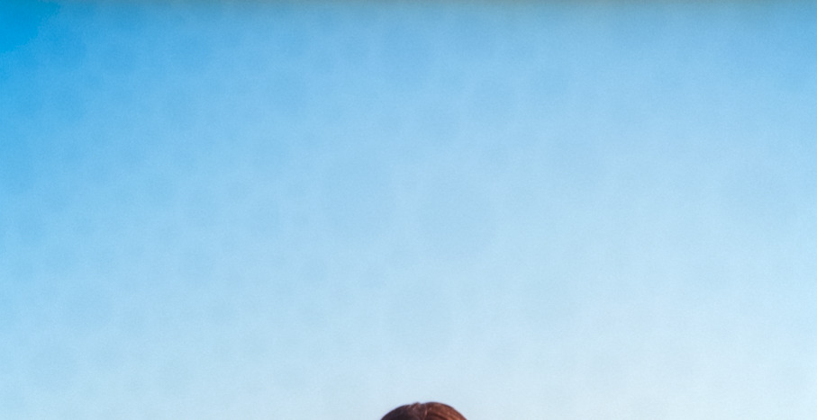

most of the rolls affected only had a mark in the sky. usually 1-3 frames at around frame 10 as mentioned previously. more recently it only happened in 1 frame per roll and the last batch that contained an expired roll had marks that more closely reassemble what OP had. not only in sky areas but also coming from opposite edges

The examples above look like the contrast was increased dramatically during post processing as the original negatives might have low contrast due to e.g. very high levels of fog. Is this correct? In this case I wouldn't worry too much about the bubbles as the root cause of the problem isn't really there.
these last two examples are straight from the negative lab pro inversion using my usual parameters. the film is fogged as you said. only on the previous post i had two shots edited to show it
Given the excessively grainy nature and the severe color variations across the frame, it looks like Negative Lab Pro did a massive contrast boost on it. The problem here is really the heavy fog, not so much the foaming. Had this film not been so foggy, the foam would have been invisible. Arguably, it might still be a kind of theoretical/hypothetical problem, but you probably would have never noticed it...
that is likely. but i do notice it on non fogged films like a roll of portra 400 that was developed before that.

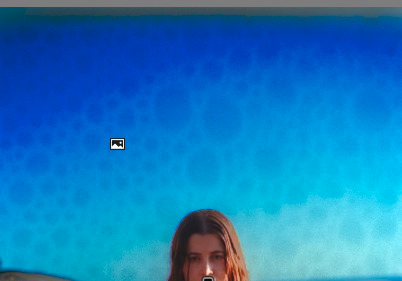

this is the #1 picture in post #66, only one affected in the entire roll.
before i moved to NLP i was using Nikon Scan and although it gives a lower contrast image it was still noticeable
