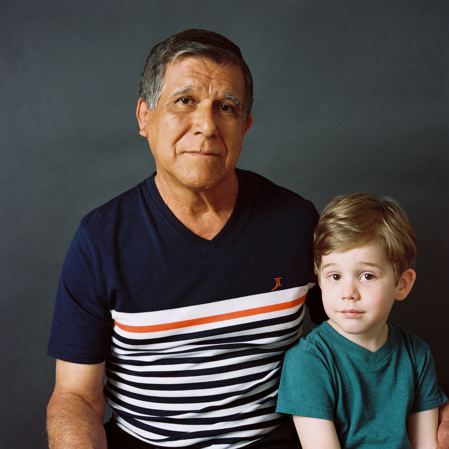

I'm using a Jobo CPE2+ and the stabilizer was done off the reel and in a separate container. I used a 2523 tank and used two rolls in one reel.
I did two presoaks of 30 seconds each and then pour in fresh developer, then a stop bath (it came off very foamy), then bleach, rinse, fixer, rinse and then a final rinse for 10 minutes using tap water. The stabilizer was with distilled water.
One roll was nice and clean and the other one had the issues on the last 3 frames or so.
Thank you!

This is the result of foaming chemistry during one of the process steps, potentially development. Check the following:
* Is the volume of chemistry used correct? --> if the volume is too low, the film isn't entirely covered during processing.
* Is the cap placed correctly on the processing tank? --> incorrectly placed cap will result in loss of chemistry during processing.
* Is the rotation continuous; i.e. doesn't it stop somewhere during the process (defective processor)? --> if rotation stops for some period of time, uneven development will occur.
* Does re-blecahing and re-fixing solve the issue? --> if this helps, you know that the problem manifested itself during either bleaching or fixing and your negatives can be saved. Still you'll have to figure out what the source of the problem is.
In general, C41 chemistry in a rotation setup will foam, but this is not necessarily a problem as long as the volume of chemistry and agitation are sufficient.
The fact that the last few frames suffer from the problem, combined with the assumption that these frames were closest to the center of the tank, points into the direction of insufficient chemistry used. I think the 25xx tanks require 285ml minimum, but I round this off to 300ml. Err on the high side in case of doubt. It probably doesn't hurt to run these tanks with 350-400ml.

* I used 300ml and it calls for 270ml
* Yes it was placed correctly, no light leaks or anything
* I stayed with the jobo the entire time and it never stopped.
* So, just re-bleach and re-fix normally? Do those need to be at 100.4F or can be used at room temperature? I've never done that so no idea how to go about it.
Thank you for the reply!

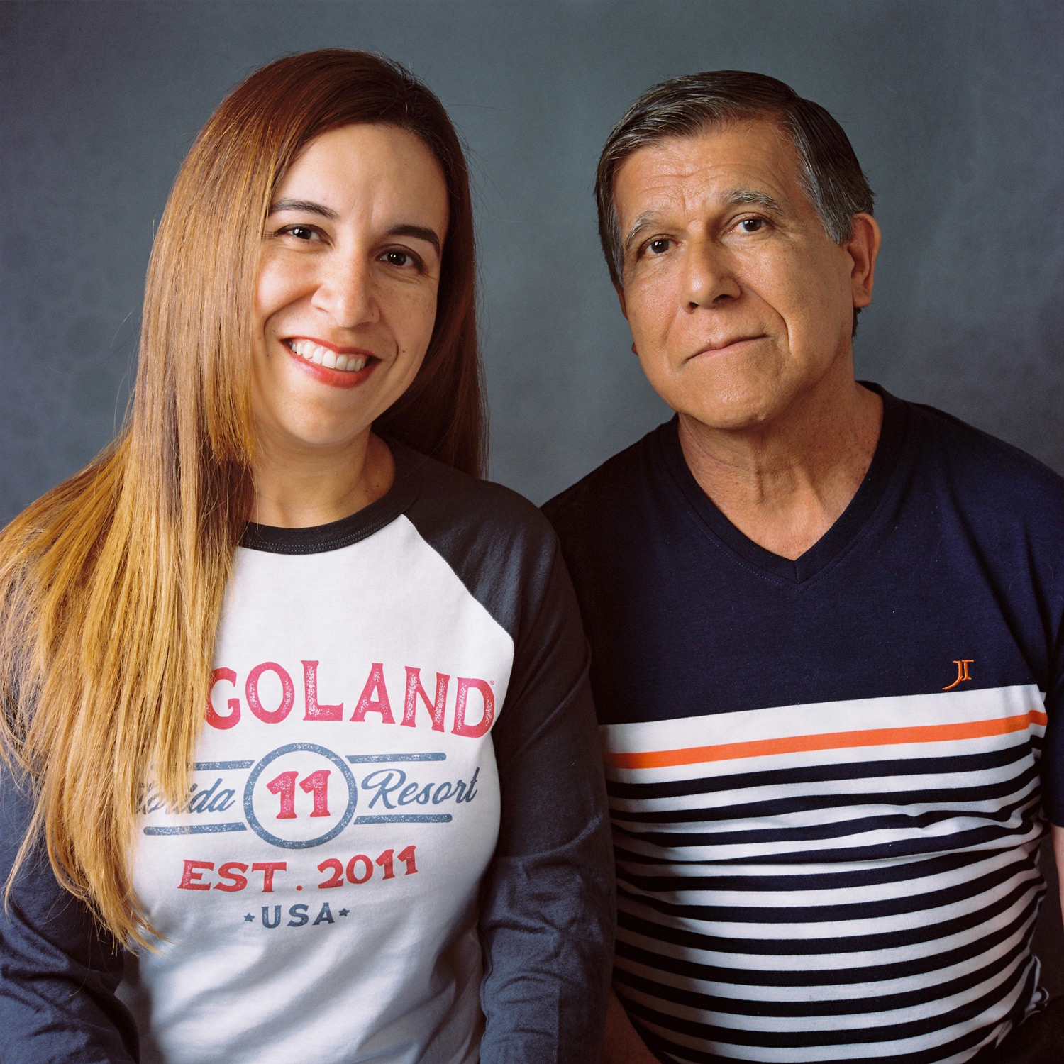

why are the bubbles seemingly limited only to the backdrop? They seem to stop immediately once they hit the subject. Just playing devils advocate, but could your backdrop have that pattern?
I shot two rolls with the same setup. The previous frames didn't have any marks nor the first roll, or second roll depending on how it was loaded.

That all seams to be quite correct what you stated koraks. BTW : I can'tremember ever to have a bubble problem with a single development I made.
In case oft foaming chemistry (what I remember for sure:wink:) I never had an impact to the resulting negatives.
But I may imagine that with "stand developing in bw" such issues could happen.
But where are the bubbles (I am not able to identify it from OP's picture) - the photo looks Ok:cry:???
Where are the bubbles Dani?

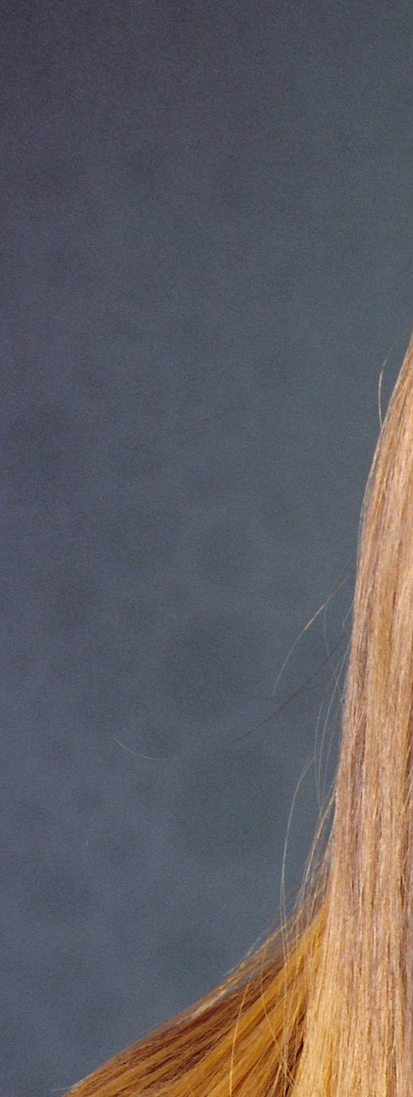

Near the hair of them. Here's a closeup
Ahh - the background is affected?
Yes - if this is the "bubble problem" it would be clear that it is more to be seen there. Because the more colored and saturated areas oft the picture let it not so clear seen!
There the bubbles have a Vetter "camouflage".
hmmm - OK ....and you also identified that from your negatives via visual inspection?
with regards
PS : The devil is often within details:sad: - Bad issue if is also onto your negatives:pouty:!

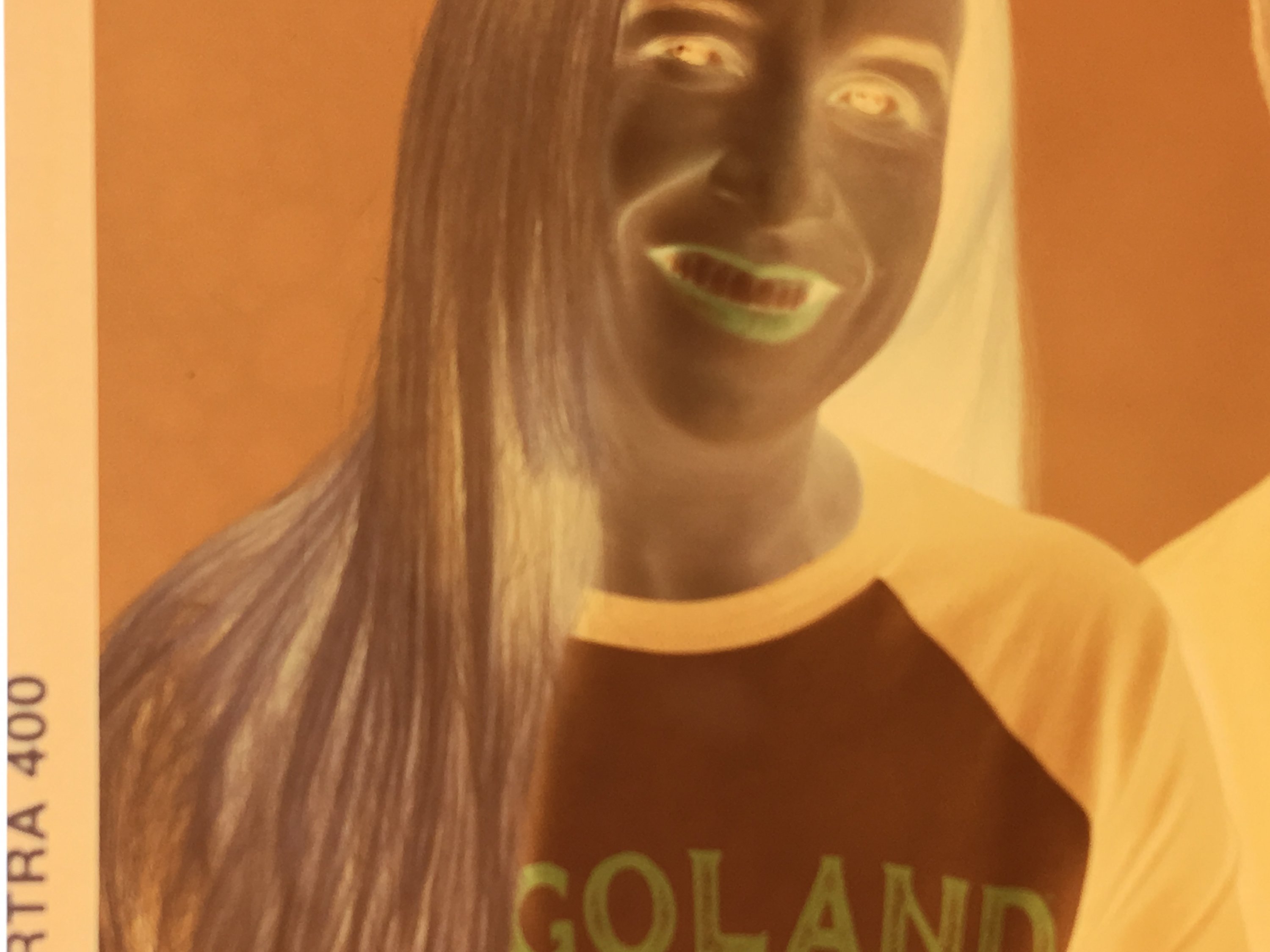

Yes, you can see it in the negative and both sides look shiny when reflecting light so it seems it happened during developing. You have to stare a it for a little bit but it's there.

OK at last Dani - you should avoid this next - from using a bit more c41 developer . I guess you have allways fresh c41 soup in use (insufficient developer causes a different kind oft problems in comparison you have shown Herr - I am well remembering from own experience:sick:...but I never had bubbles:cool:)
with regards
That’s what I’ll do next. Measure how much is the maximum I and put and try more rolls like that.
Thank you!
more developer in regard oft volume (350ml for example):wink: I guess koraks matches that point best from his analysis.
with regards
Are the bubbles visible on the film itself?
Otherwise, this might be a strange scanning artifact.
Yes they are visible on the film itself.
It appears to be from foam in the process. One of the active solutions (dev, bleach, fix) foamed up. If you did not use the "real" final rinse, then this might also be a problem, but if you did and the final rinse was overly foamy, this might also cause a problem if the film is not properly wiped afterwards.
PE
