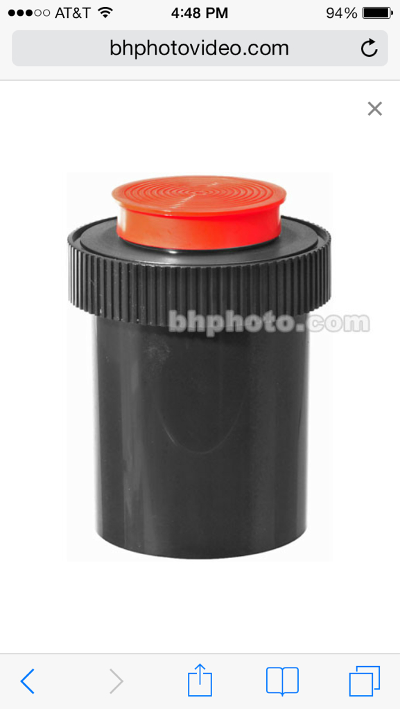

so an effort to show you the Jell-O hand processing tank that I was thinking about, I went to Google it, and discovered all along that the product that I had even though the lab at the time told me it was a JOBO was actually an Omega style universal tank... #stonefail ....
At the time, I was completely new to developing, and obviously the representative used the word JOBO as a general term for processing tanks... I never checked into it, and obviously throughout the box way before I found APUG so it never occurred to me to doublecheck my knowledge on that, so for that I apologize I feel like a doofus :/
This is what I had at first, it leaked and sucked and I replaced it with a Paterson...
