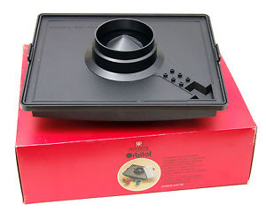

Where do you get the orbital?
Just did a quick search, and found only 1 on the auction site, in europe. Searching completed items brought up all but one out of the US and none were really "cheap" or cheaper then any of the currently available options (Jobo/MOD etc), which can be used straight out of the box.
4 sheets at 500ml does not seem like the most economical way to go as well.
I got mine from eBay. I simply saved a search for "Paterson Orbital" and when one came up bought it for about £140 (about $224). If you do want to use it for colour work then you simply go back to the 50ml and use the orbital base to agitate the films throughout the process. With normal (non-C41) B&W film the processor is used without the orbital base. It is used as a tray. It just happens to have a light baffled lid on it. 500ml makes a safety level to ensure the film is covered during stand and semi-stand development.
I noticed in your own store you are selling a second hand 20x24 drum on its own for $329 and your new 3006 drum is going for $499 plus shipping add in your foot pump at $65 and the Paterson Orbital is looking quite cost-effective and it is so much more versatile, especially when processing black and white.
RR
Wow, £140 for an orbital, I bought two (separately) for less than that together and then paid a further £35 for a motorised base (never actually used it).
If I am processing Semi-stand I use an Orbital without base in a 10" x 12" tray with a water bath which is sat upon a 11" x 14" dish warmer to keep the temperature constant over the long processing times that ensue. I have found that 400ml is more than sufficient to cover 4x 4x5 or 2x 5x7. To agitate I lift one end of the Orbital slightly to rock it in the water bath.
Apart from the Jobo Expert tanks, sheet films processed in the Orbital are as good as they get, no scratches, streaks or other blemishes.
Well done on the purchases! I suppose I was anxious to win the auction at the time because I had sheets waiting to be developed. My developer is so low cost, 500ml gives a nice safety margin for me. I wouldn't risk my films to any of the other methods now I have modified my Orbital. My agitation is a little bit like yours but I do it in groups of four left to right tilts and four back to front lifts. My motor base is like yours, unused...

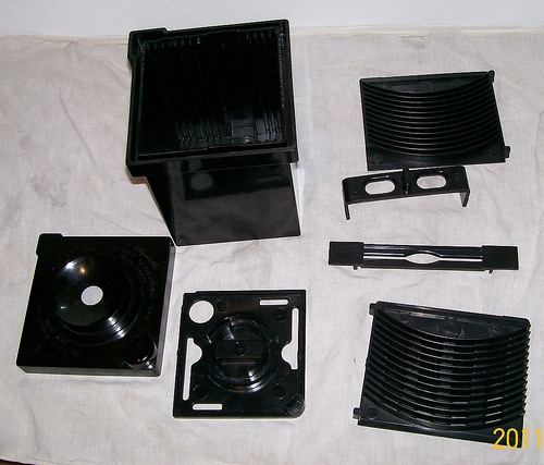

Fink-Roselieve cut-film-pack developing tanks, man here... ;-)
They are adjustable for 4x5 film on down to medium format.
It has a 'loading' sleeve, and at this time I have adjusted the film 'holders' to fit the 3.25 x 4.25 film I am using, and have to cut.
Life is good... been using them for years...
You do realize that's not helpful to the OP since he wants something different from FR tanks right? Lol
