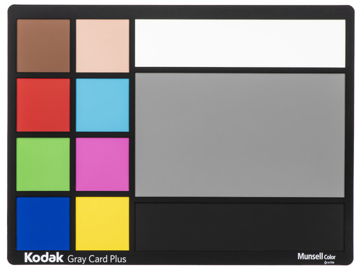

Can someone share a photo of the Kodak Gray Card Plus taken with an ADOX HR-50 film
I am using this film (SCALA 50 / HR-50 with Speed Boost technology, as well as the original base film) for almost 20 years now. So I know this stuff very well 😉.
The film has extended red sensitivity (super-panchromatic), and therefore the main difference in colour reproduction is that red is recorded a bit lighter, and blue is recorded a bit darker (which I like in landscape photography, because it improves the differentiation between clouds and the blue sky).
The differences in colour reproduction to panchromatic film are visible in certain scenes, but not dramatic.

Thanks. I guess using red or orange filters would have an even greater effect compared to panchromatic film.
Well, I found it online - left Adox HR-50, right Kodak Tri-X :
There are unfortunately three problems with that test:
1. The film is not a copy film, as said in the introduction.
2. The HR-50 sample is significantly underexposed, and therefore you get a wrong impression of the differences in colour on the colour chart.
3. He is using generally the development times of D-76 from the data sheets of the manufacturers for the test series of different films. But these times are often not correct, or evaluated under development conditions which are different to the conditions the customer is using.
For example let's assume the manufacturers are using very precise, calibrated thermometers. But how many customers are doing the same? Very few. And from my own experience running a test lab I know that variances of more than +/- 0.5 °C are resulting in visible differences in density of BW films.
So for the idea of his test-series it would be much better to test and evaluate every film-developer combination with a densitometer to get the right development and consistent density and contrast. Then you can compare the films properly.
Yes. The darkening effect of blue sky with this film is roughly comparable to the darkening effect you have with a medium yellow filter on a panchromatic film.
