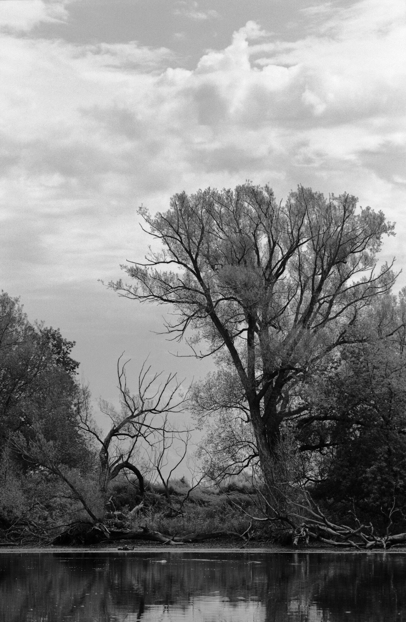

Update: I tried 3 films of the Scala 50 in Rodinal. 1+25 10 minute 22C semi-stand with a gentle turn at 5 minutes.
What jumped out at me:
Film is quite curly (actually can tie itself into a knot, something I've not experienced before)
High detail
One of the 35mm casettes had a very loose cap that you could remove without any tool and it did leak a little light
Even as a negative, exposure latitude is quite limited. For example in the shot below, I was just on the edge of being to expose for the trees and sky in the same picture.
Overall, enjoyed it and would use it again! It worked especially well for infrared. I'd like to purchase the reversal kit from Adox for it but it's a little expensive and I didn't see a response on if it can be stretched beyond its stated capacity with reasonable results.

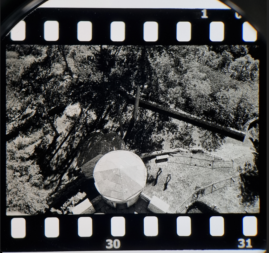

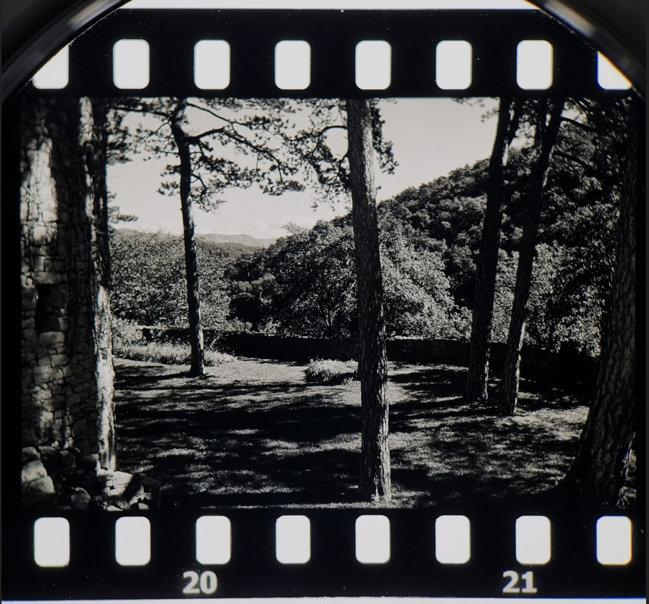

I have just developed the first roll, rated at EI 100, and everything seems to have gone perfectly. I exposed the film using my Canon A1. According to Foma's instructions, gentle agitation is recommended, so I performed five inversions every 30 seconds. The temperature was closely controlled, though it was held at 21C instead of the suggested 20C.
For the second exposure, the film was on a white plastic JOBO reel, exposed for 60 seconds with a 150W opal bulb at a distance of 50 cm. So far, the results look great, and the film appears to have developed beautifully.
Some recent snaps (EF 28-80L, and FD 50 f1.4 - the very last frame), smartphone through a loupe:

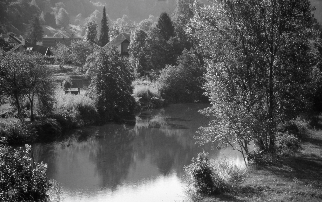

I'm still amazed at what Foma R100 can do. The photo below was scanned on the cheapest scanner I have, an Epson V370 Photo, yet it still shows a great range of gray tones that this film is capable of. I'm also positively surprised by the Foamd developer kit, I opened it back in october last year, and 10 months latewr, it still works just as it should. Really solid and reliable chemistry.
That's a very lovely result!
