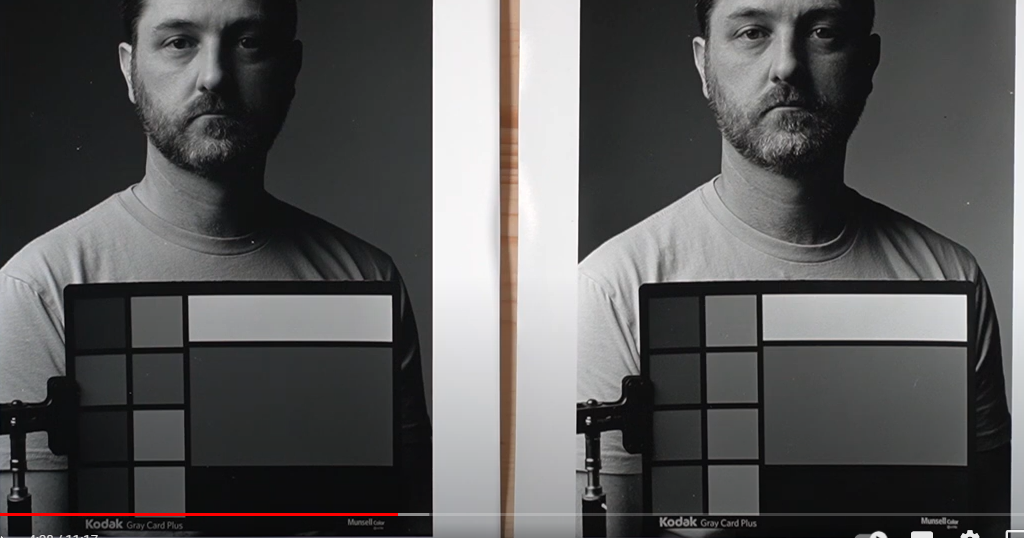

Can someone share a photo of the Kodak Gray Card Plus taken with an ADOX HR-50 film
Well, I found it online - left Adox HR-50, right Kodak Tri-X :
Link: (The Naked Photographer)

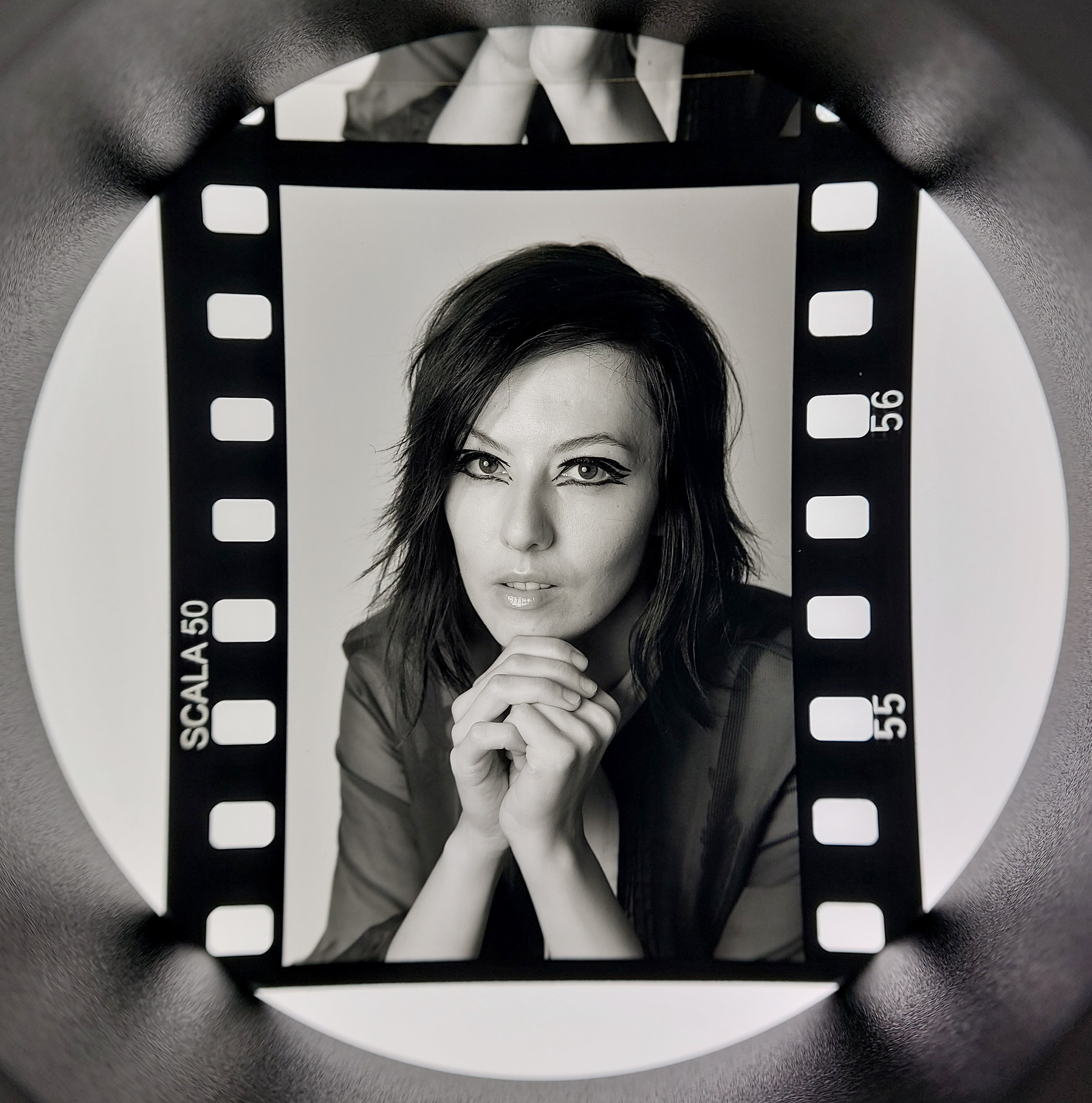

Portraits of Ukrainian artist Dasha.
In real life under the loupe and in projection the quality is of course in a different league compared to these phone snapshots.
But I think they give you at least a certain impression what the film is capable of.
