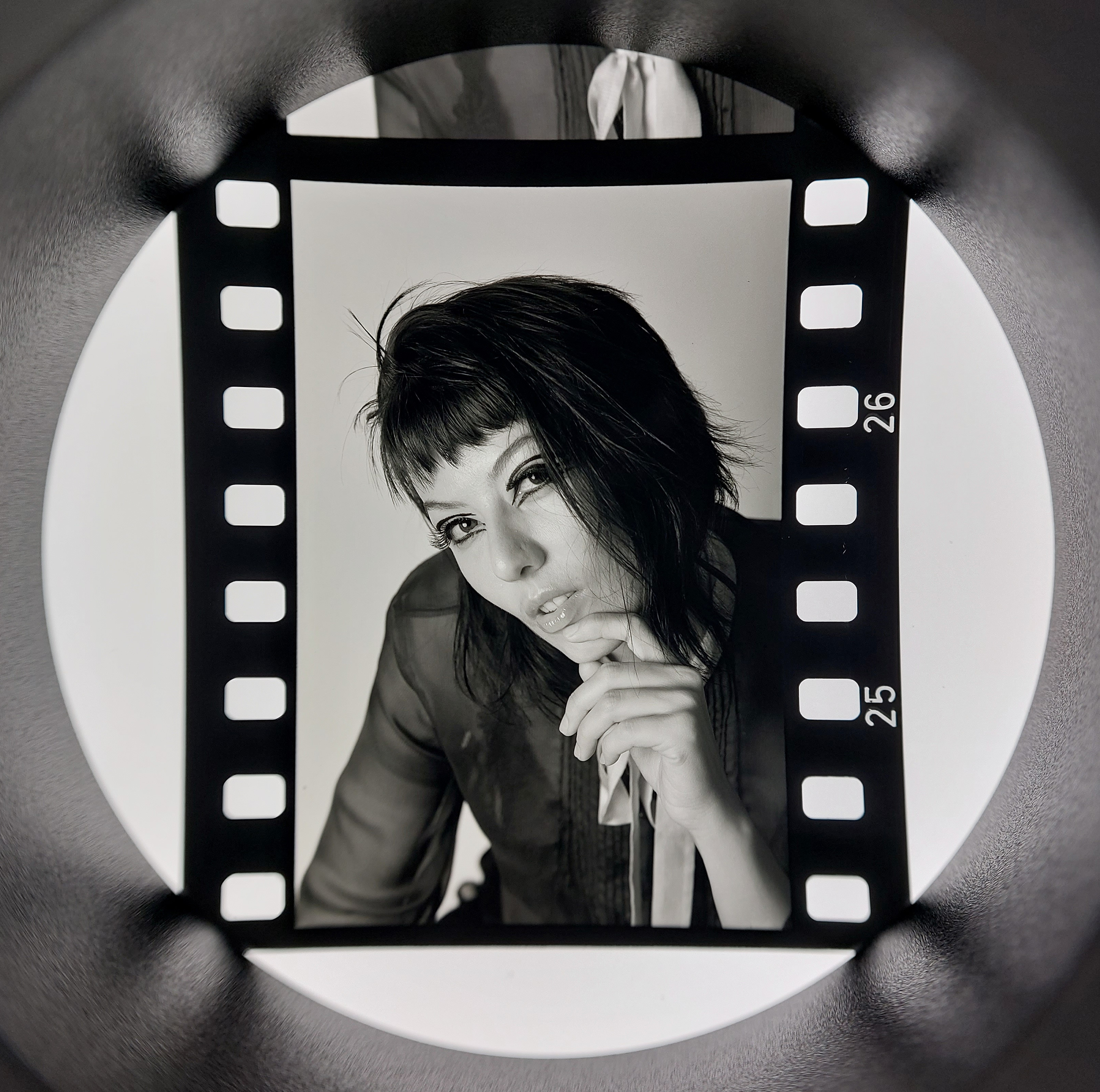

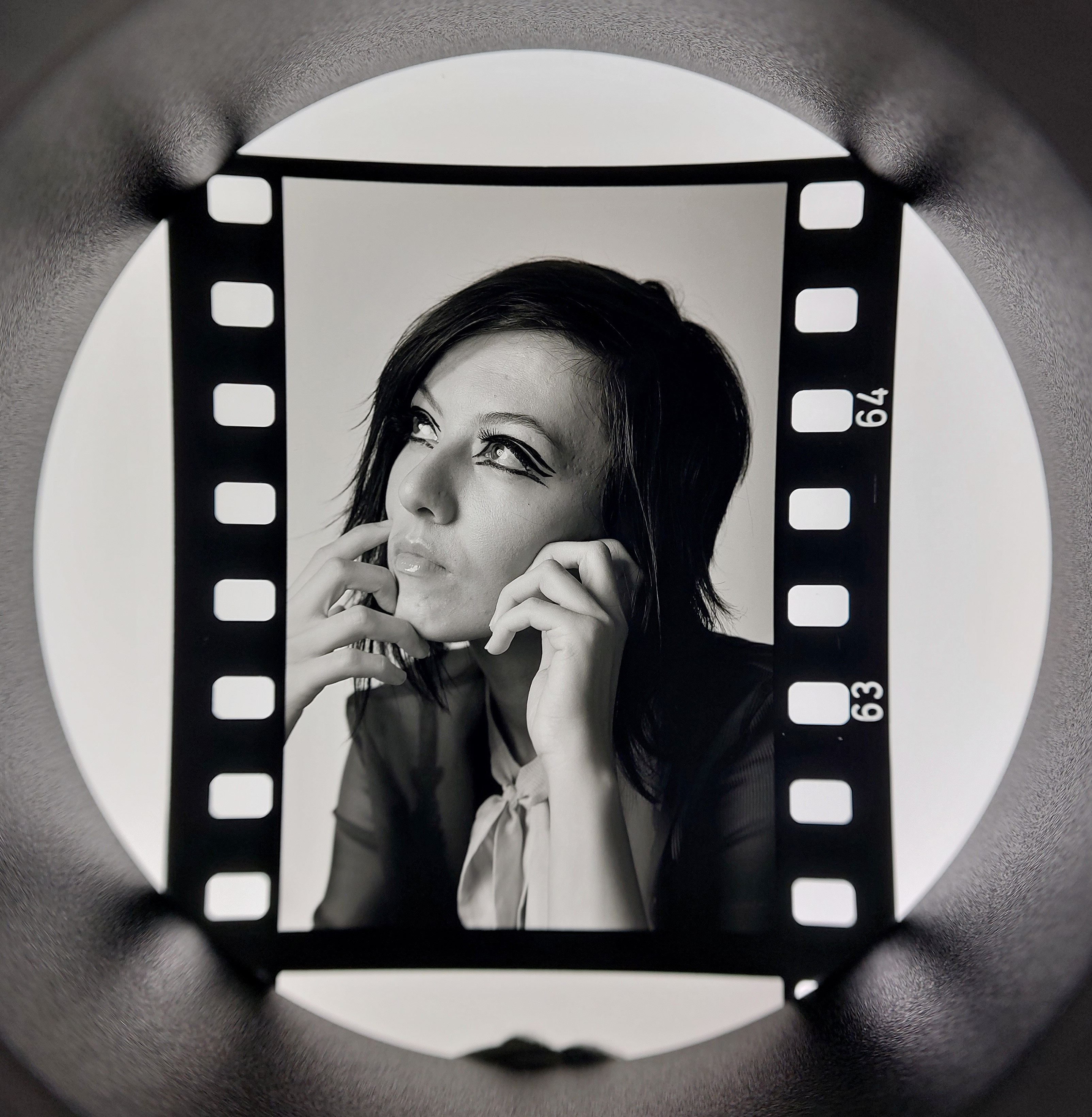

For a quick, rough impression below snapshots from the phone through a loupe:

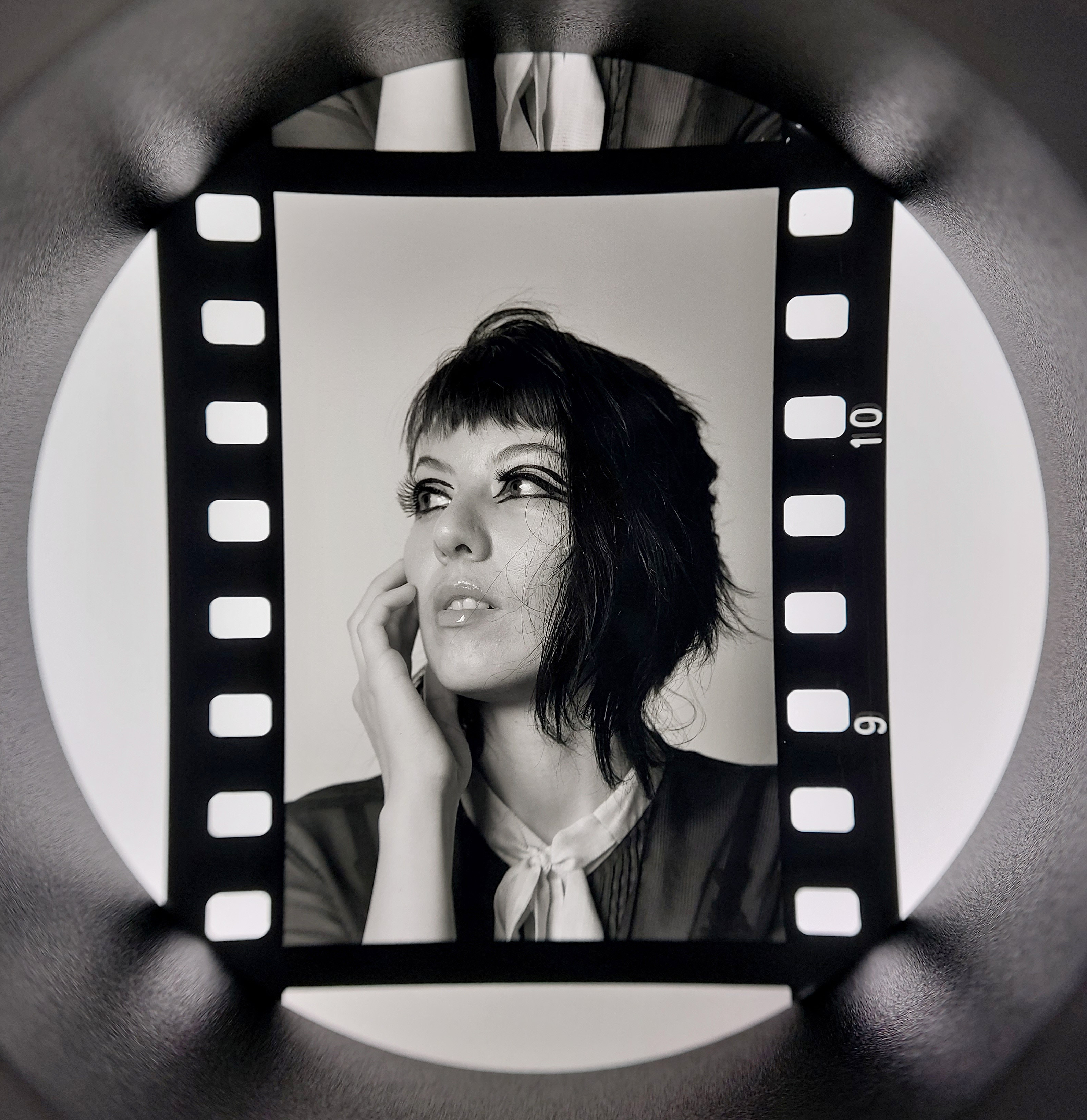

Another one:
Excellent, you've made me want to take out Scala 50 as my next film...

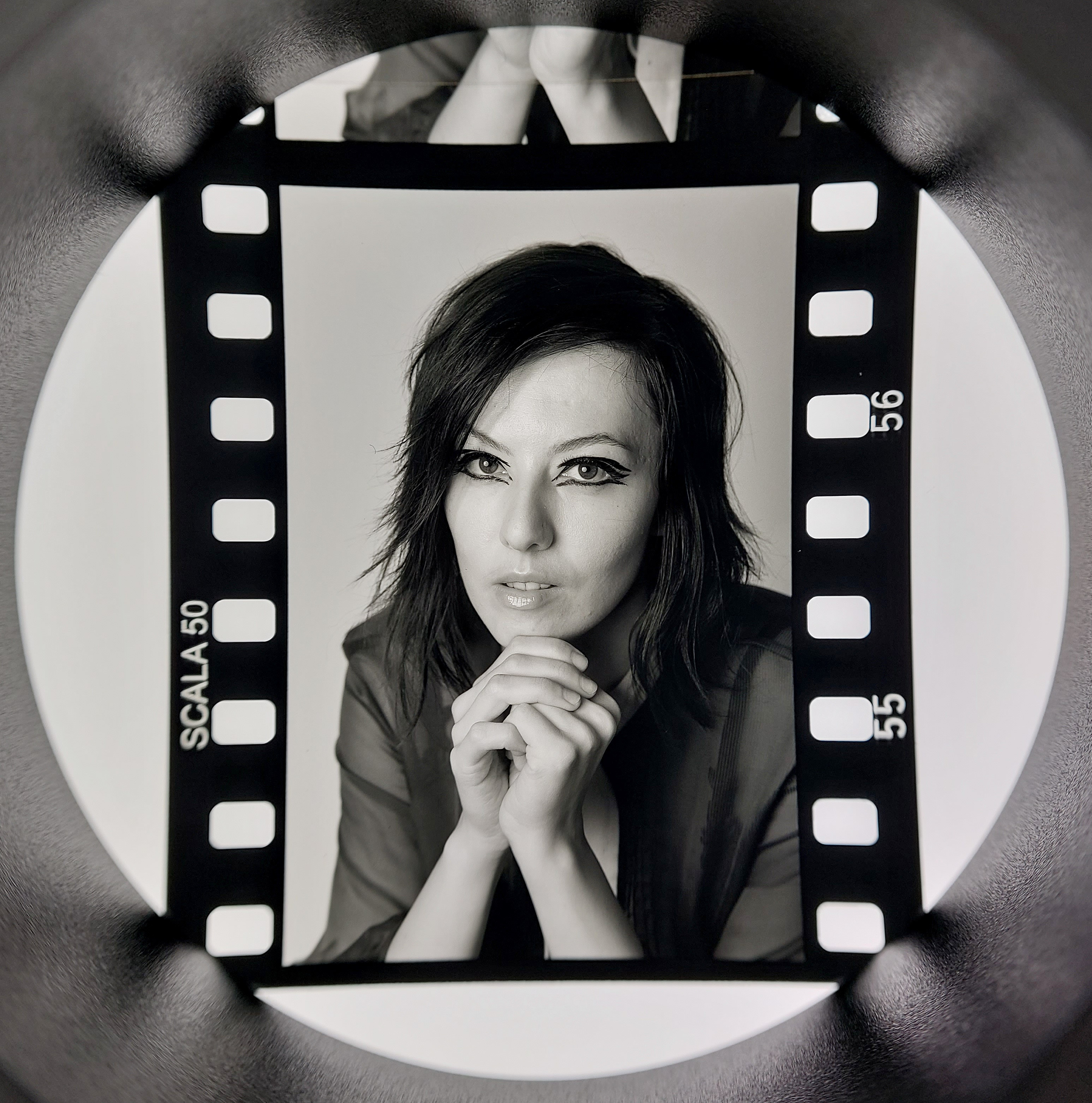

Portraits of Ukrainian artist Dasha.
In real life under the loupe and in projection the quality is of course in a different league compared to these phone snapshots.
But I think they give you at least a certain impression what the film is capable of.

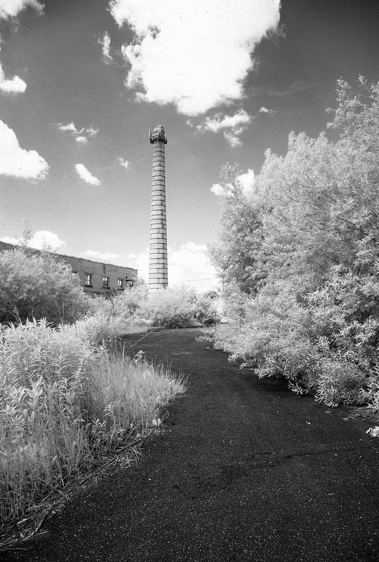

100% - a brilliant film that can be used for IR too, making it simply my fave :smile:
Have bought some bulk rolls of it (all long gone), will buy some more!
URBEX LV by Ivo Stunga, on Flickr
