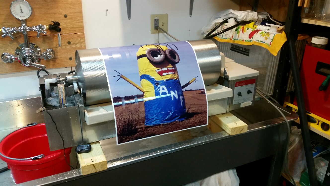

Well, mshchem - that looks like a DIY copy of one of those Old Kodak external rim drum processors. I've always wondered how well one of those would work with large fiber-based black and white paper, which tends to collapse inside a drum. Not that I'm going to test the idea - just buying a box of 16X20 b&w paper has gotten awfully expensive these days; and my notion of using an external net drum would hypothetically apply to more like 30X40 inch b&w prints. Still - worth pondering.
This is the Kodak external drum machine. 16k Kodak Rapid Color processor
Keeps temperature dead on. Internal water, roughly 5 gallons, circulation pump. Print floats face down on the chemistry. Takes about 10 minutes to warm up. 45s developer, I use a stop for about 20s, blix 45s, wash on machine for 90s. Run print through my Ilfospeed dryer, 45s max.
Clean up is rinse off machine, hang up the net blanket, turn off the machine and your done. I always swish out the sink underneath. I add maybe a mL of an antimicrobial humidifier treatment so the tank stays fresh between runs.
That system deserves its own thread. :smile:
And it has one. https://www.photrio.com/forum/threads/anyone-run-a-kodak-16k-rapid-color-processor.141703/

The old Kodak external net drum system wouldn't work for me because the chem is on the outside, exposing one to the vapors in the darkroom, just like open trays or tanks. I have to work with enclosed drums outdoors to minimize the risk of respiratory sensitization. I have a nice big porch awning just outside of the darkroom complex for sake of that, along with a portable cart bearing the big rotation device.
Would you mind sharing some photos of your construction? Would be fun to se how it looks.

I haven't linked pictures before. I might be able to do it with a cell phone; but this old platform I'm using is getting pretty far out of synch.
Not to be a know it all but I can confirm that you could produce fibre base prints with a unit like this and yes if you had a huge drum you could do 30 x 40 inch
The model 30 was a enormous tube ( not drum 😊 ) similar to the Jobo scheme. And the Kodak machines were designed to use Ektacolor Professional fibre base color paper. 7.5 minutes with 5 chemical solutions. These could also process Ektachrome prints and transparent display film.
