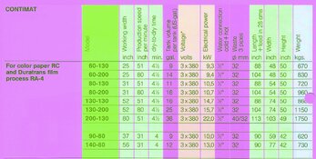

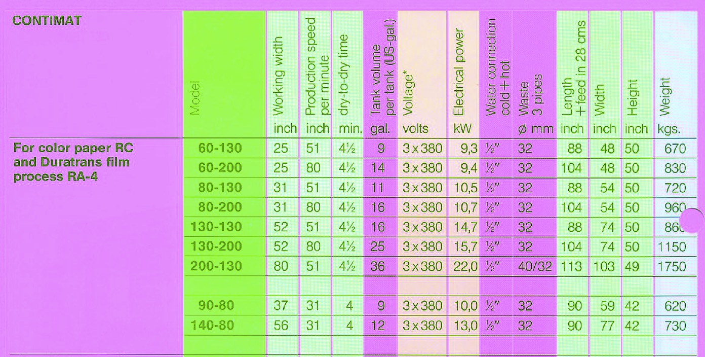

The smallest 130 cm autopan has 16 gallons (60L), the longer one 25 (94L) tanks. 100L of Fuji developer is 110 EUR in shop.
Depending on the machine I calculate a total cost of around 4-500 EUR to start the machine. It's not that expensive considering what a professional Lambda print cost nowdays.
Since I dont know the size of the machine I will buy, it's a theoretical. But I find the prices resonable.

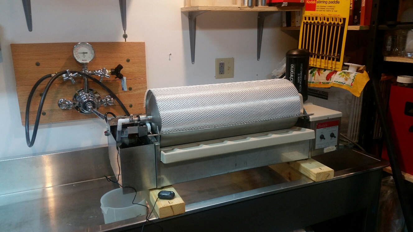

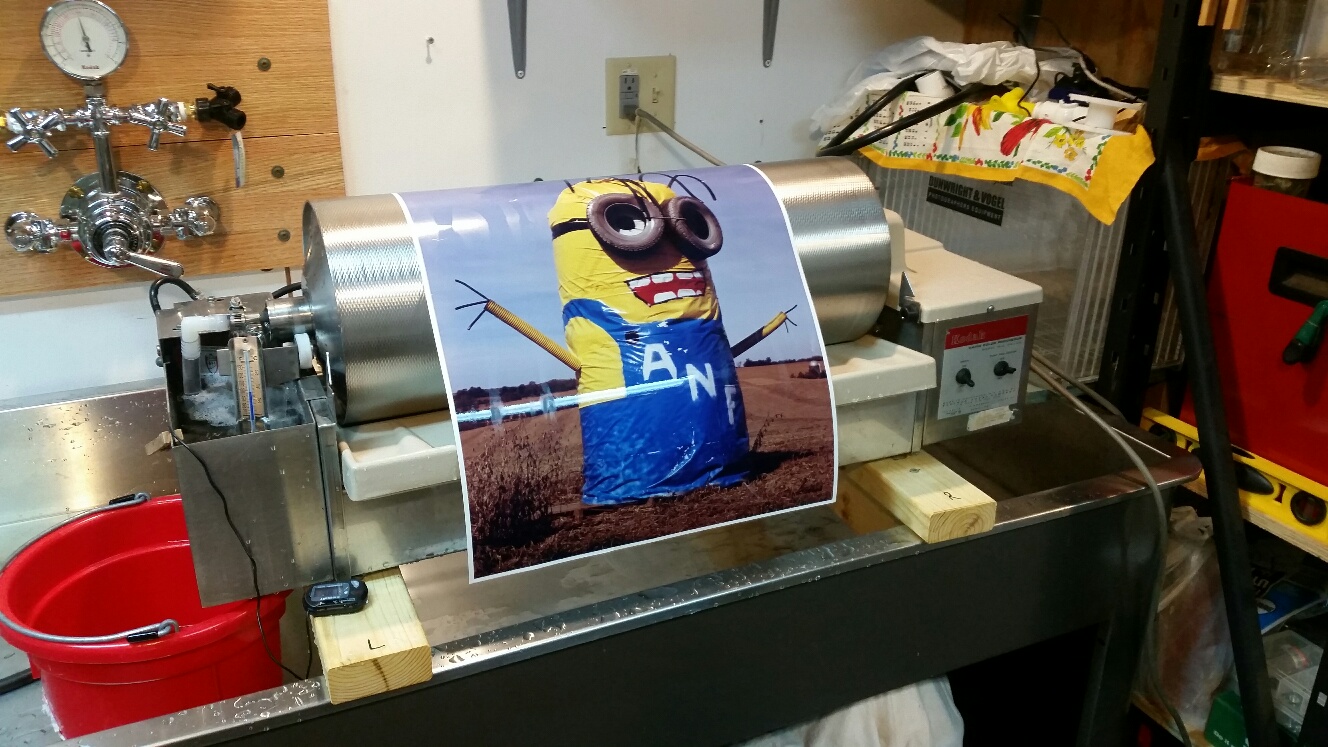

How I print 16x20 ra-4
Lachlan - I live six blocks from the infamous Hayward Fault, which has produced worse quakes in SF itself than even the fabled 1906 San Francisco earthquake due the parallel San Andreas fault. I have ZERO vibration on any of my Durst 138 or 184 columns. Simple - they're wall bolted and floor fixed just like they're supposed to be. Living in earthquake country just adds to that common-sense necessity. My really big custom color enlarger, 14 ft tall, is built like a tank. I can actually stand on the baseboard without flexing it. Some of its components actually are military surplus. Tall columns have their advantages, like working with longer than "normal" focal length lenses more often. I have my luxuries, having begun darkroom work in a spare bedroom and bathroom, and knowing exactly what I wanted next, and building it while I could.
And there's sure as heck nothing imprecise about any of my Durst enlargers. Like any other piece of fine equipment, one needs to tune them up and not merely install them. I have precision levels and squares to check other levels and squares, and had access to industrial lasers to check my personal lasers - sheer overkill with no real difference in even a large print; but I like working with fine equipment.
Another problem with low ceilings is being too close to hot colorheads. Fire hazard is one obvious risk; the other is just having too much ambient hot air surrounding the head. My ducting inlet is above the head, and the ceiling is covered with FRP (fire-resistant fiberglass panel). That helps if there's any insurance or business zoning issues, plus being common sense with high-wattage halogen light sources. Back when I had a hotter than hell 200W Durst colorhead, I used it in horizontal mode. But that took up too much floor space once I added several other enlargers.
Well, mshchem - that looks like a DIY copy of one of those Old Kodak external rim drum processors. I've always wondered how well one of those would work with large fiber-based black and white paper, which tends to collapse inside a drum. Not that I'm going to test the idea - just buying a box of 16X20 b&w paper has gotten awfully expensive these days; and my notion of using an external net drum would hypothetically apply to more like 30X40 inch b&w prints. Still - worth pondering.
