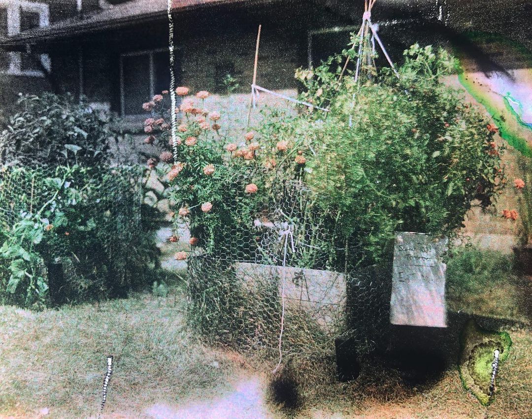

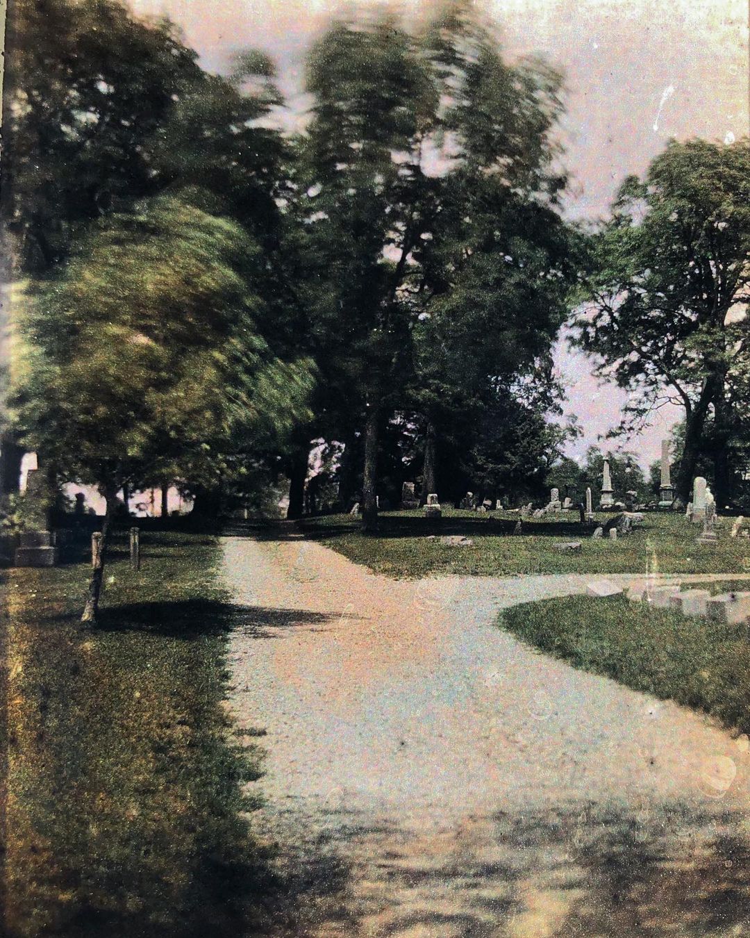

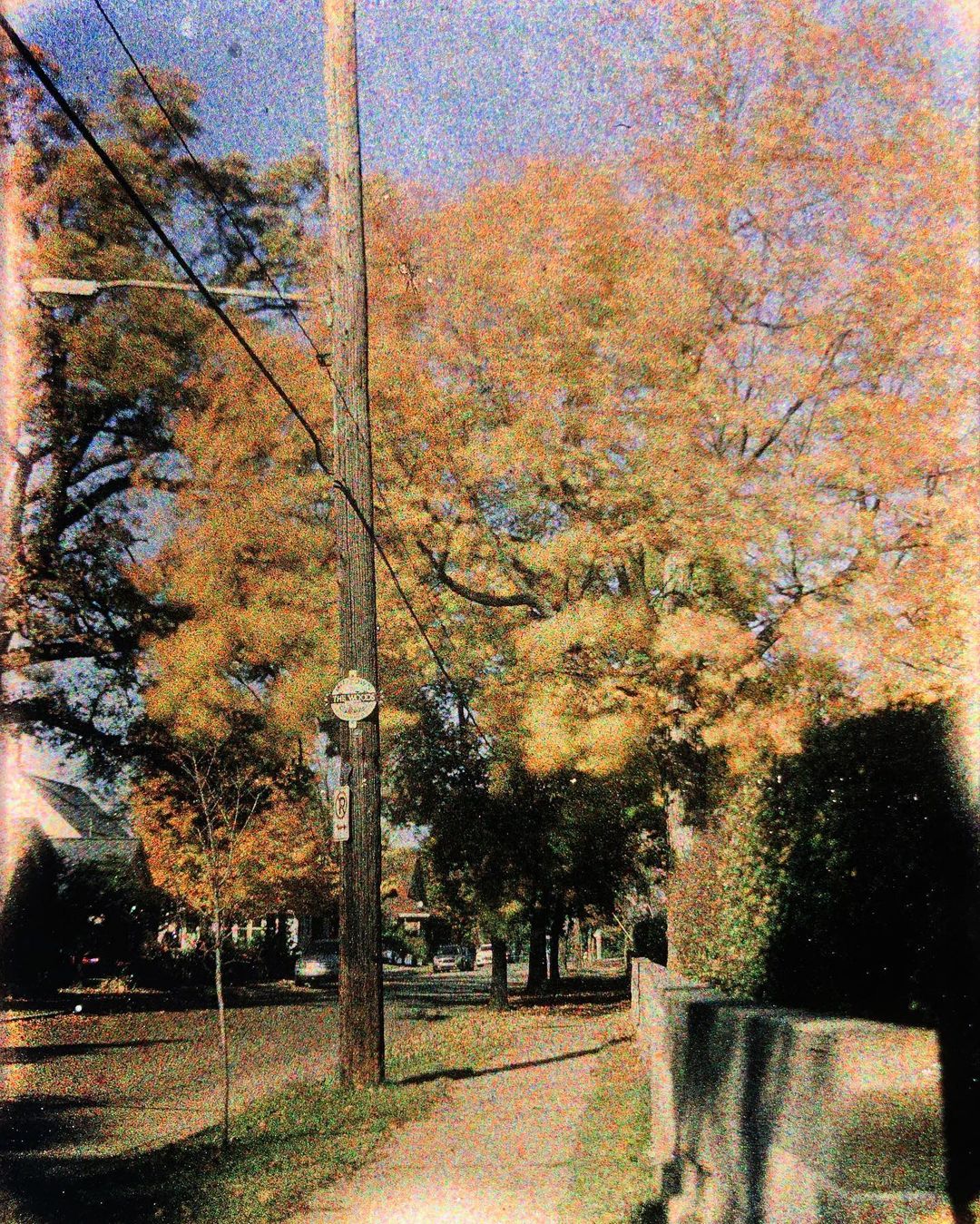

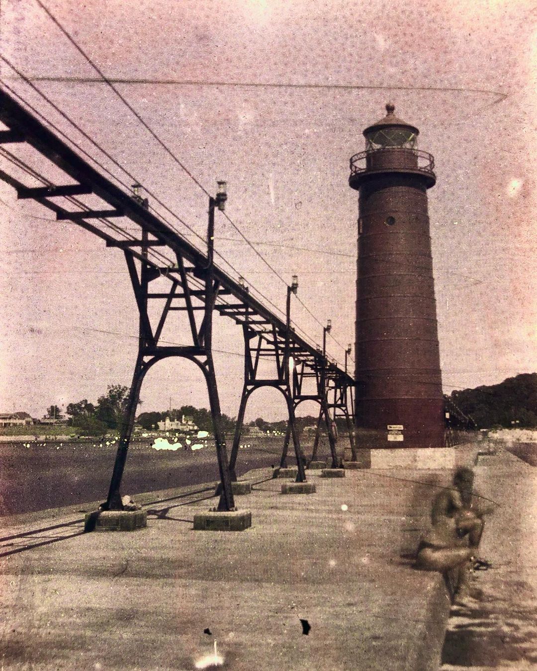

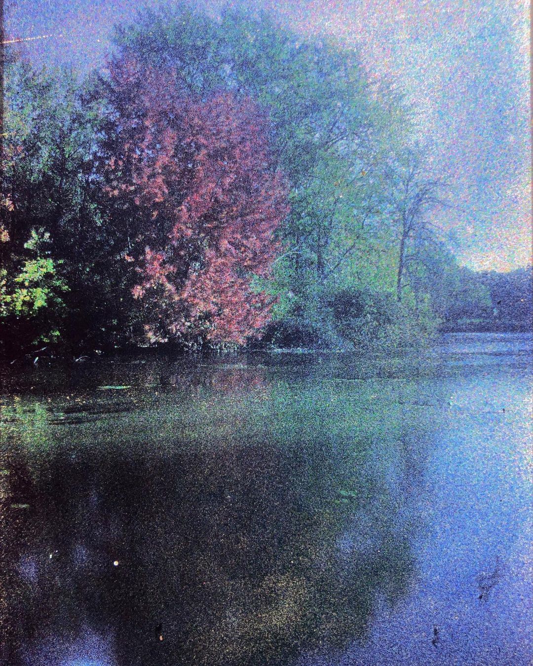

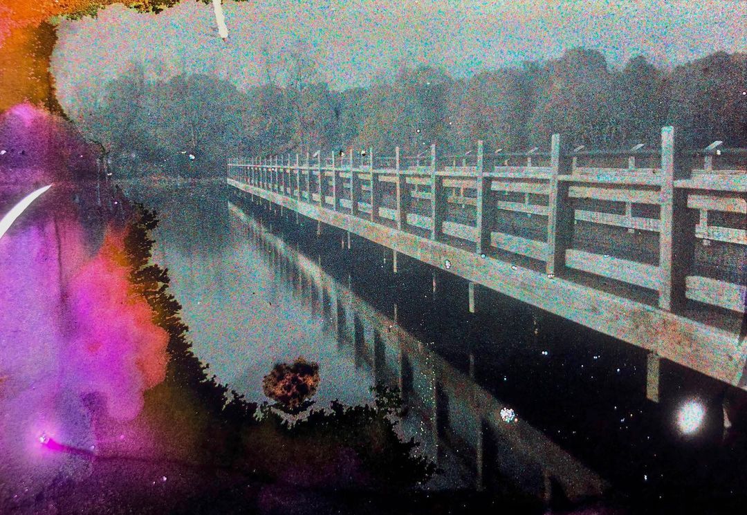

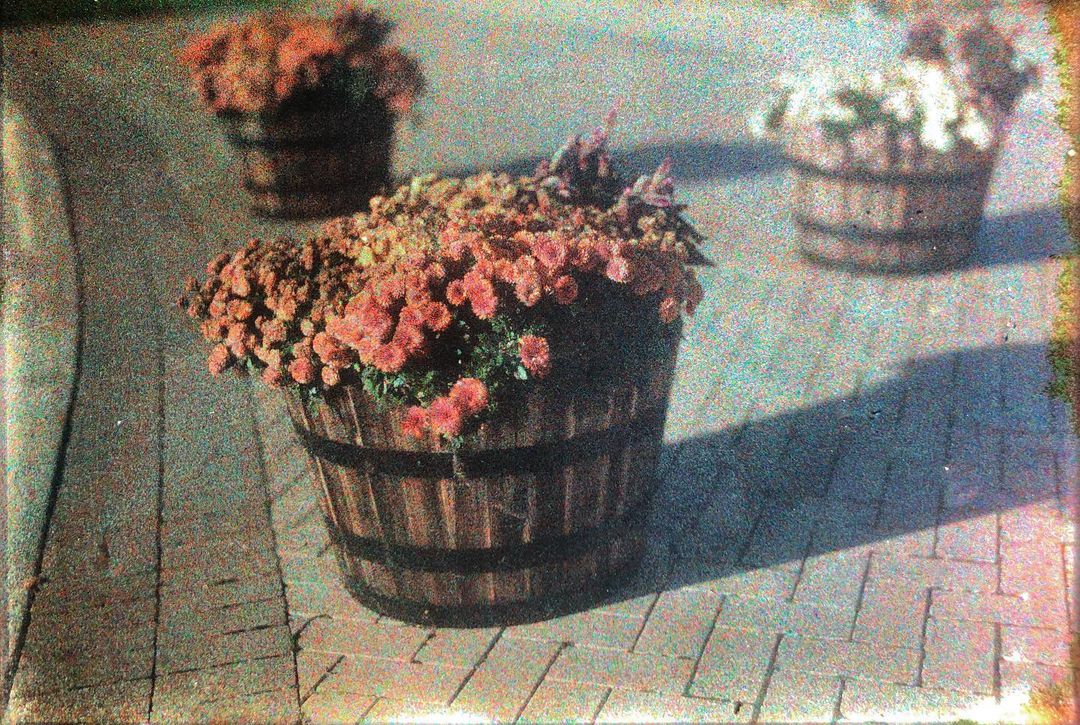

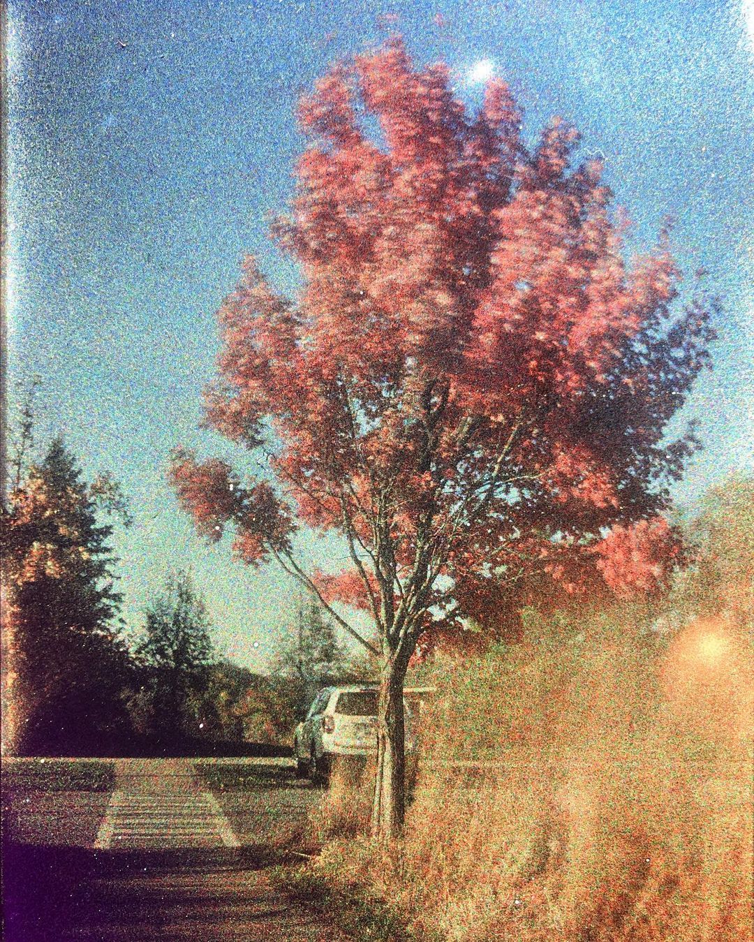

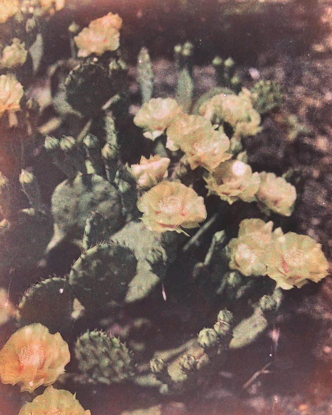

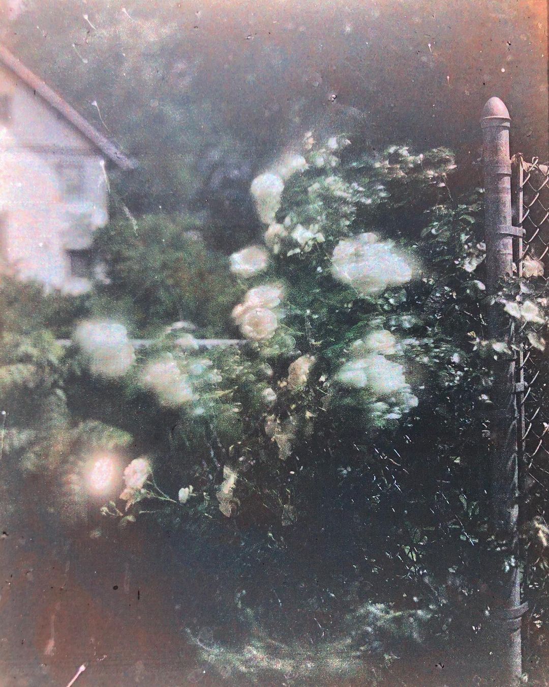

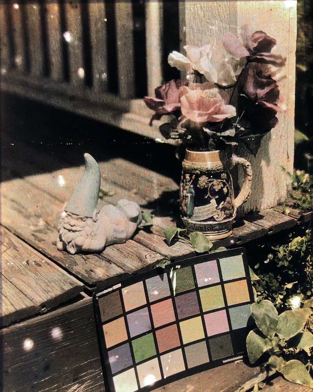

Woah, hey, I'm still making these! I took a bit of a break over the winter, but now I'm getting back into the swing of things and experimenting again!
Here are some of my first real successes with fine-grained screen plates. I'm struggling a bit to get to the same degree of color saturation as my large-grained plates, but I'm making some progress. In the meantime, these look much better than any other small-grained plate I've made yet! The "resolution" of these is right on par with original Lumière plates. The speed... is still quite lacking. About 2 minute exposure with all of these, with a 50Y filer over the lens!

What underlying emulsion are you using? The screen plate is surely costing you three stops or so, and then the 50Y probably another stop. That brings ISO 100 film down to about EI 6 (give or take a stop) -- which should still be hand holdable in full sun, even at f/8 or so...
I make my emulsions from scratch, and it's a custom recipe. They're usually about ISO 1 or so, though I don't actually know what it is because I don't shoot it as conventional negatives. This batch came out really slow though, for some reason. Usually an unfiltered plate takes about 5-10 seconds to expose, but these are closer to 25s right now.
It is a bit crazy though. In between using an AmBr and Steigmann's solution, I'm really not seeing nearly as much of an increase in speed as I would have thought. I'm not sure if I'm seeing any at all, tbh.

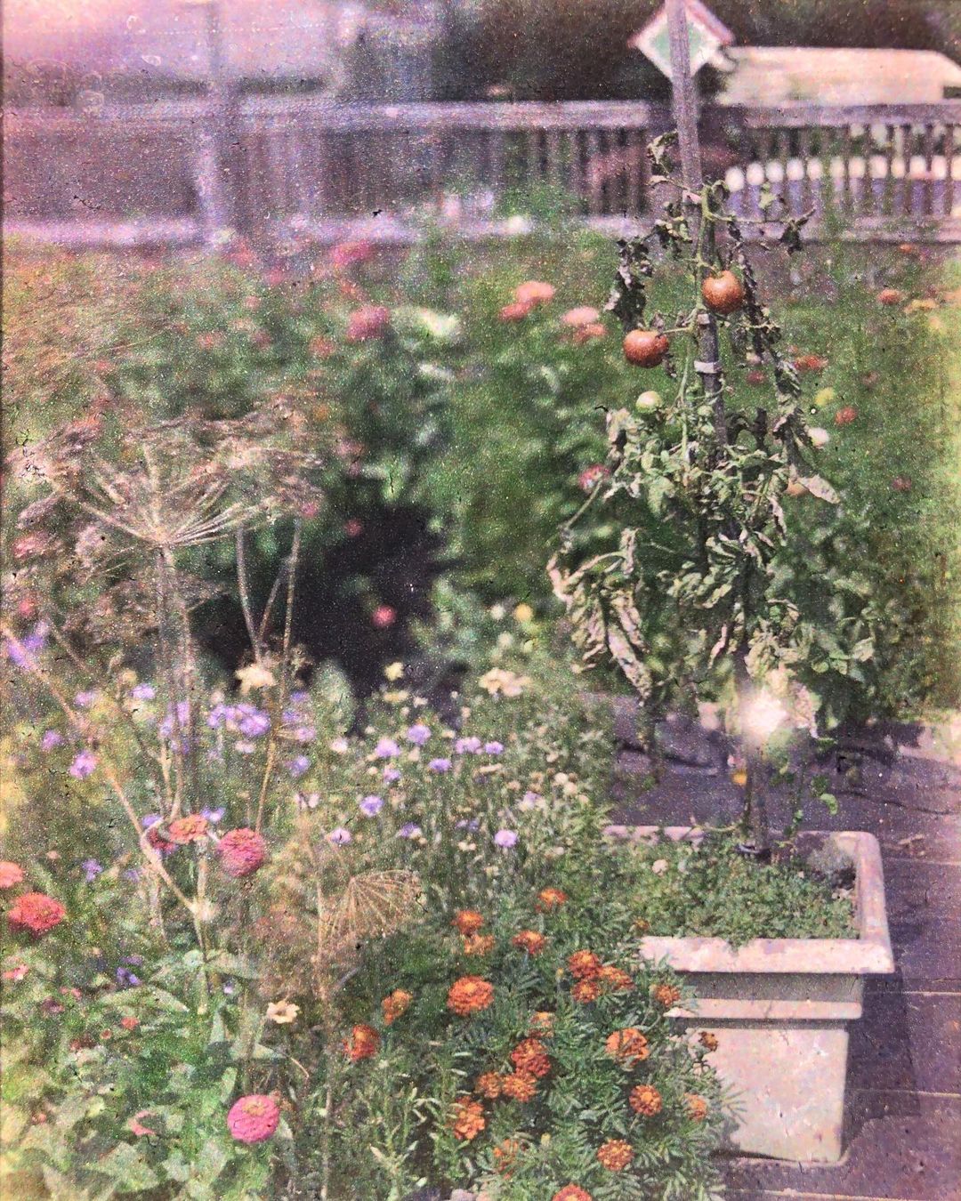

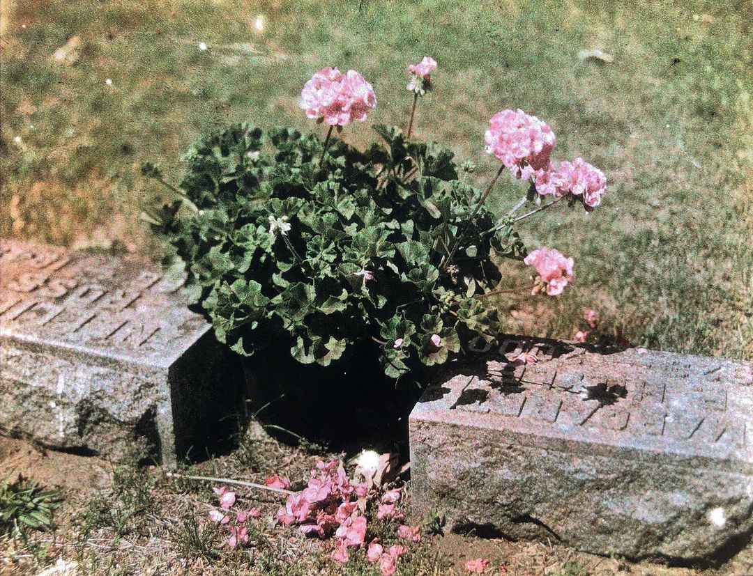

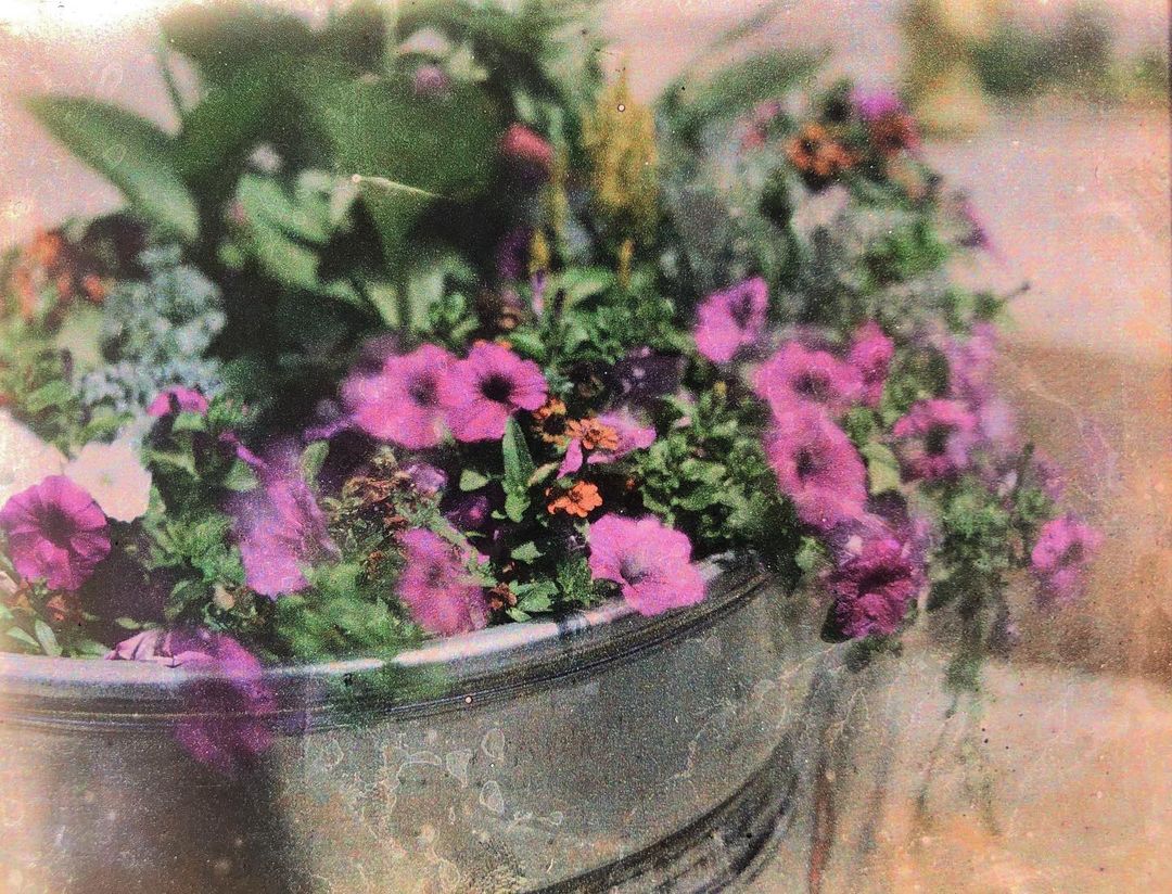

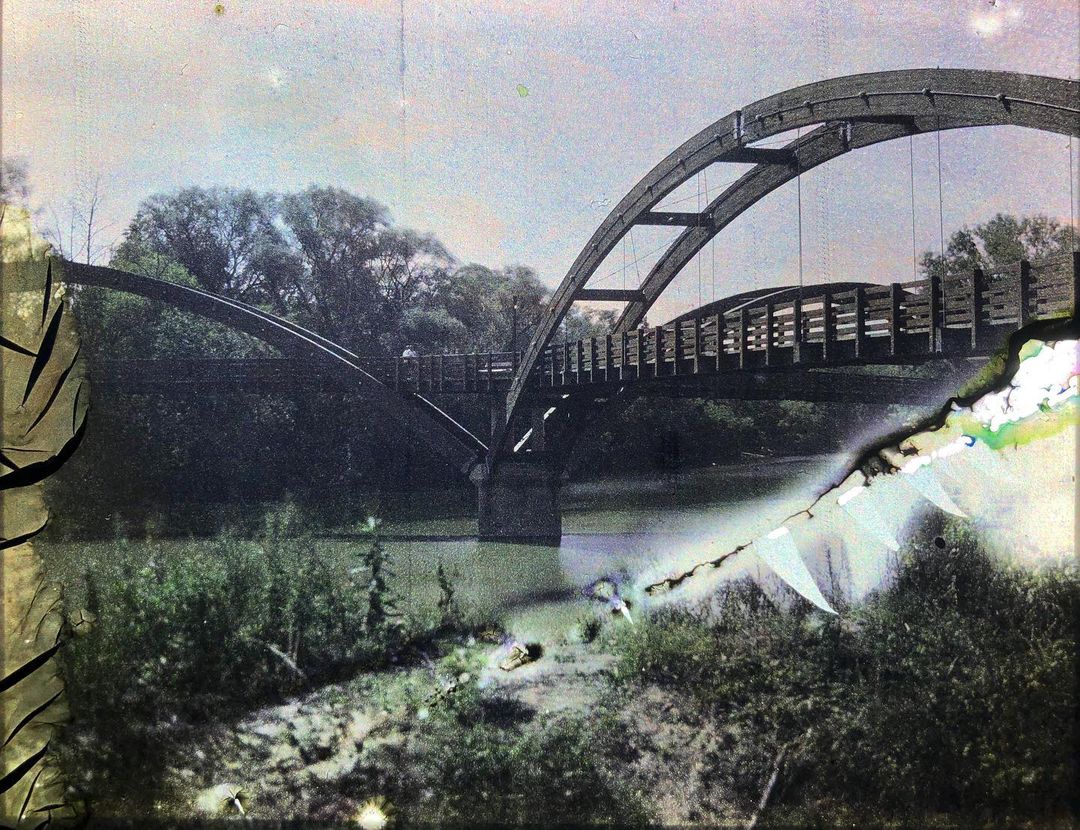

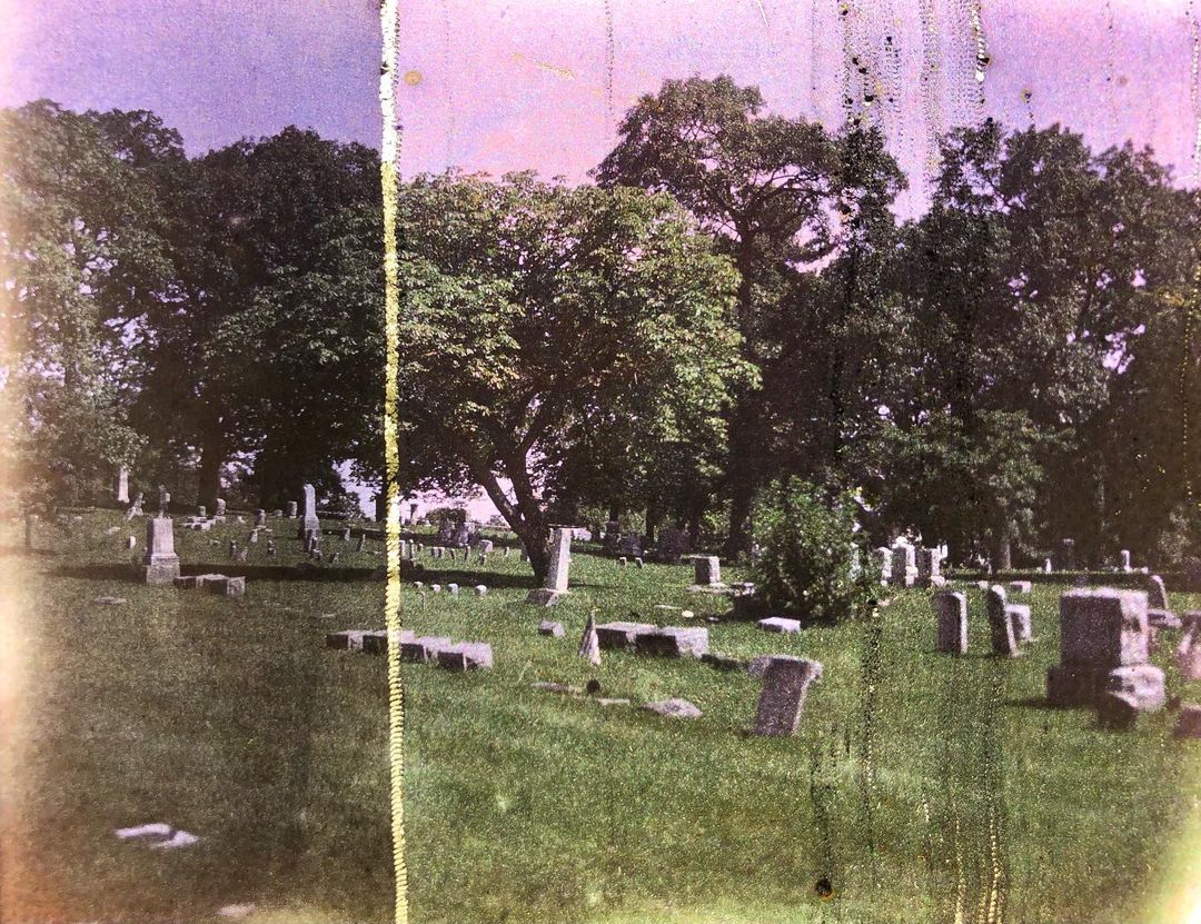

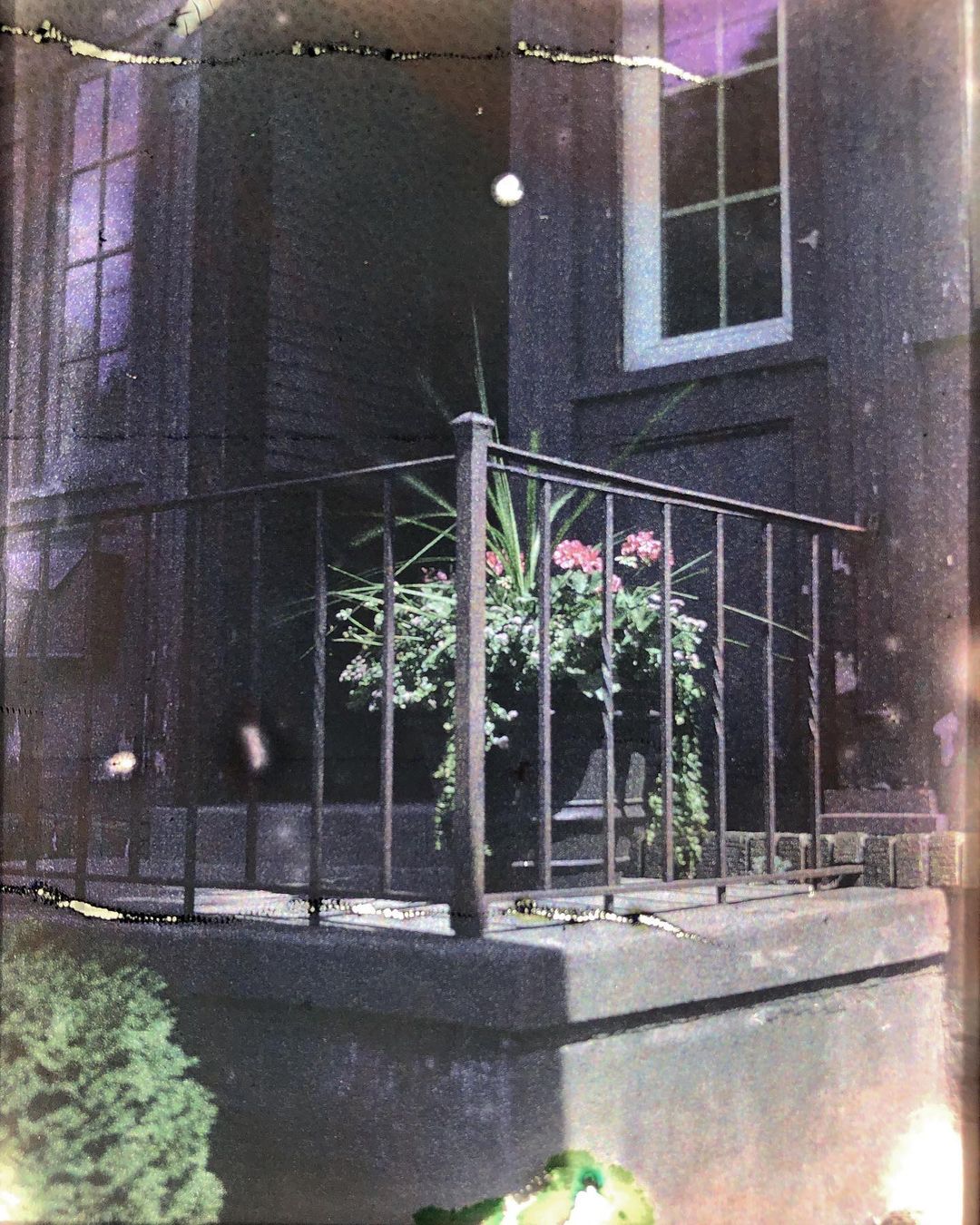

Thanks for the kind words, everyone! Here's a few more from this past Sunday. I backed it off to a 40Y filter, which seemed to balance the colors out a lot better. The plate with the purple flowers was exposed pretty well, and seems to have the most vivid colors yet. The others were a bit underexposed and needed some reduction, but I'm happy with how those turned out too. Now that I'm seeing decent colors are obtainable, I'll probably really start cranking out more fine-grained screens to play with.

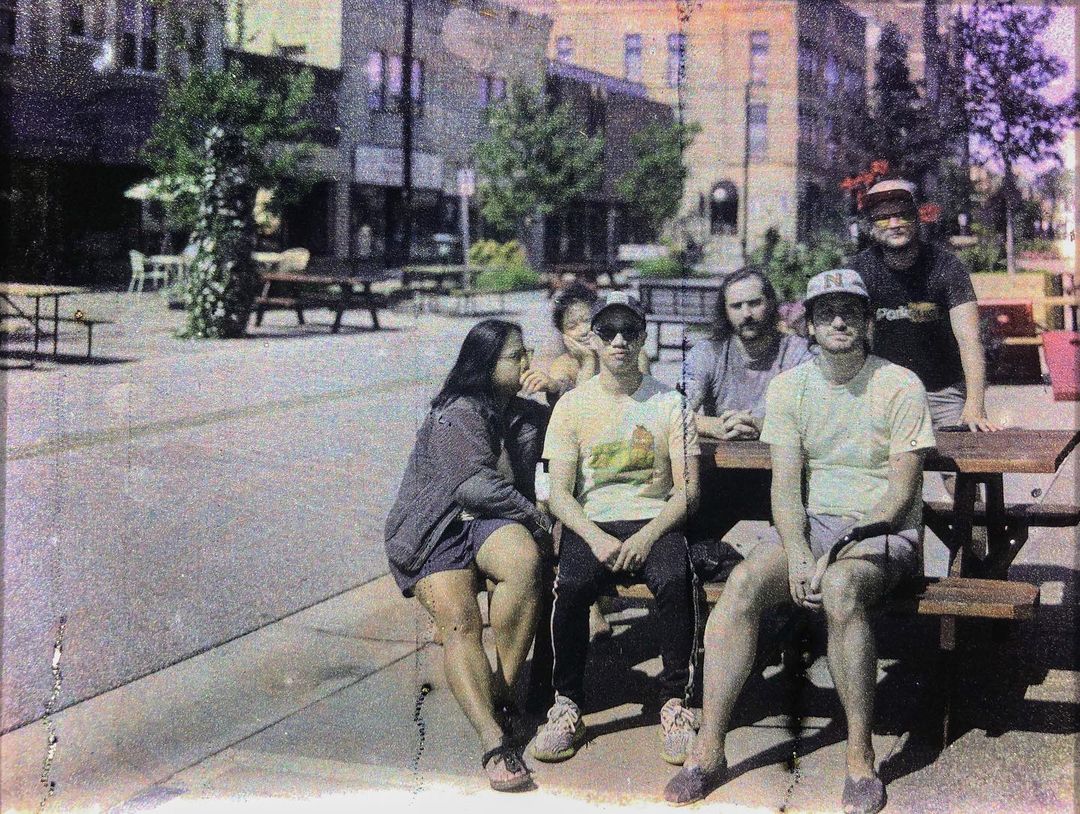

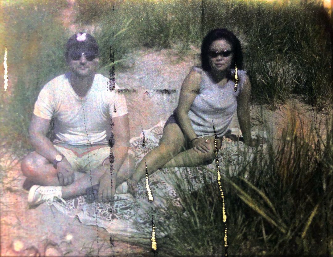

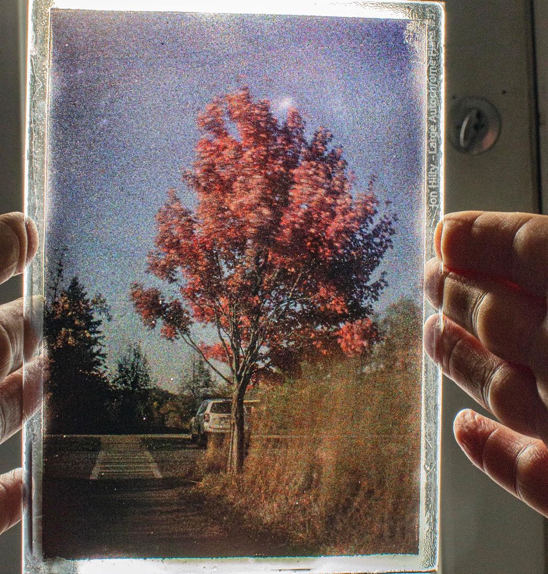

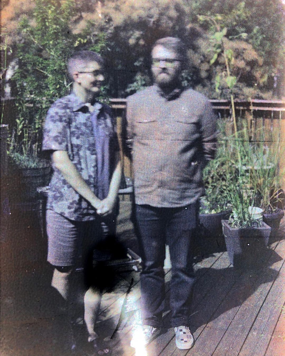

Some more plates! These were all shot at f/5.6, 2min exposure, with a 50Y filter. I only made a small run of experimental small-grained screens, and I'm gearing up to really start cranking these out. After an alcohol wash, the starch mix looks quite a bit more... yellow now. But still close to neutral gray. I'm hoping this naturally decreases oversensitivity to blue, so I can back off the yellow filtration and decrease the exposure time.
Major props to the subjects who were willing to hold still for two minutes!
