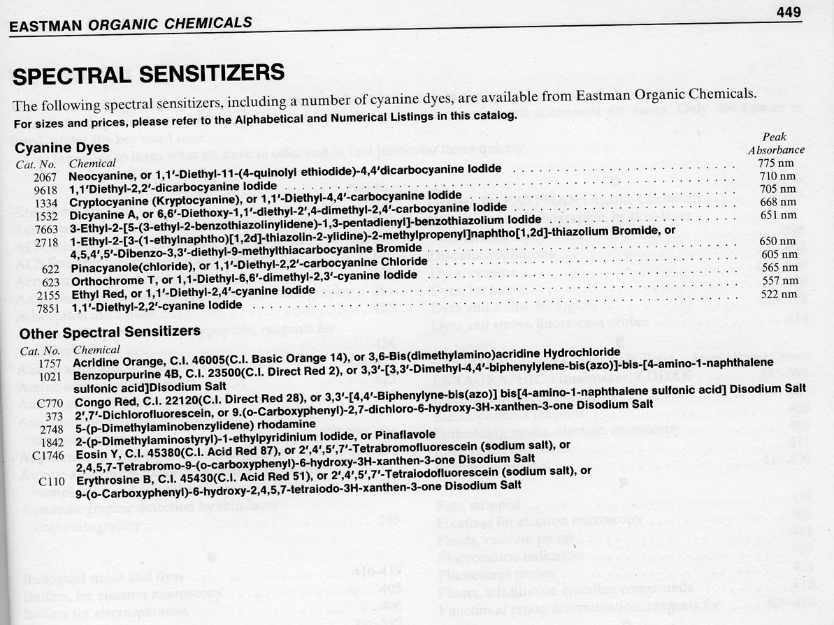

PE, do you ever hunt eBay or lab closeouts for cheap(er) dyes that might be suitable for sensitizing? If you were to make a comprehensive list of useful & practical sensitizers, about how long would it be??
Shaz, I'd love to hear Mssr. Lumiere's method. What is Orthochrome T though? A dye?
The list is about 15 names long. Orthochrome T is probably not on it as it is NOT a very good sensitizing dye.
It seems to me that I posted the list of available Kodak dyes here on APUG back a while ago, upon just such requests. I'll repost it here for you all. The top set is best and the bottom set is quite marginal but they work. They are a lot less expensive.
PE

I am sorry for you PE, but Orthochrome T is on the list. Perhaps you want a scan from the Lavédrine Book.
In your list, i don't see the "vert solide nouveau 3B", it's in the list.
If you don't use the same dyes like Louis Lumière then it will be a PEpanchromatic emulsion and not the Louis Lumière panchromatic emulsion. :smile: . And Louis Lumière was one of the best in his time for the panchromatic emulsion.
Where can i see on the Eastman organic chemical website the page where you can buy Orthochrome T please ?
I don't find it.

The dyes in the second list are very poor sensitizers and that is my only point. Eastman organics is now part of Tennessee Eastman and no longer list those dyes. That came from one of the last catalogs published.
PE
