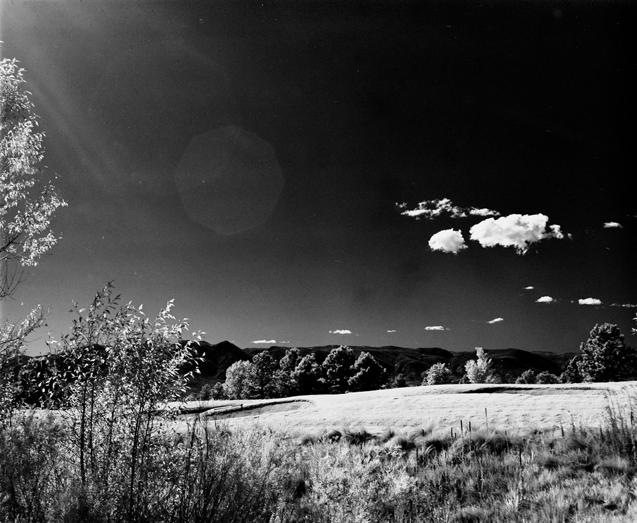

These look really spectacular! You shoot at ISO50 with these along with an R72?

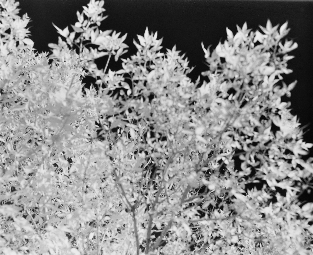

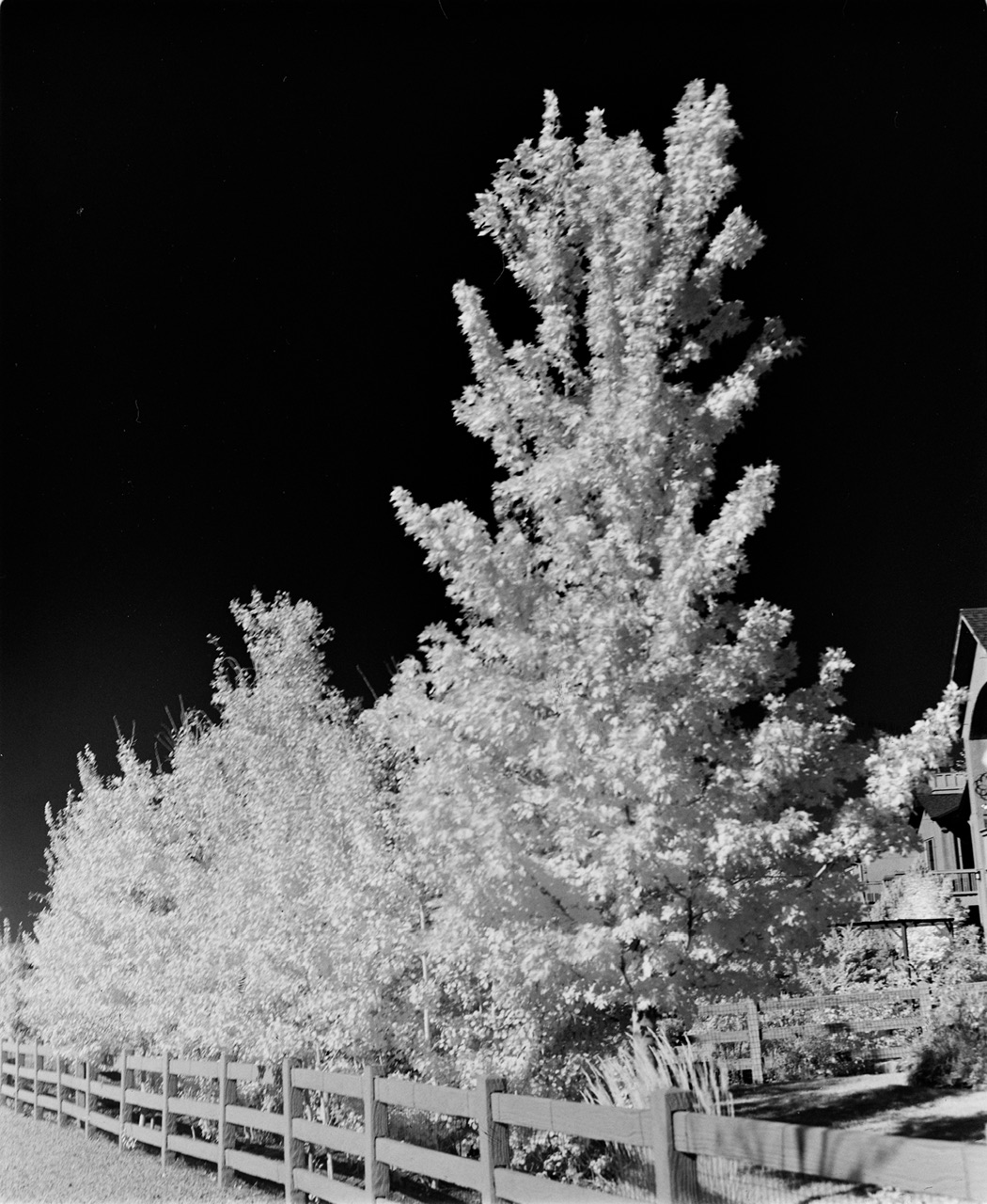

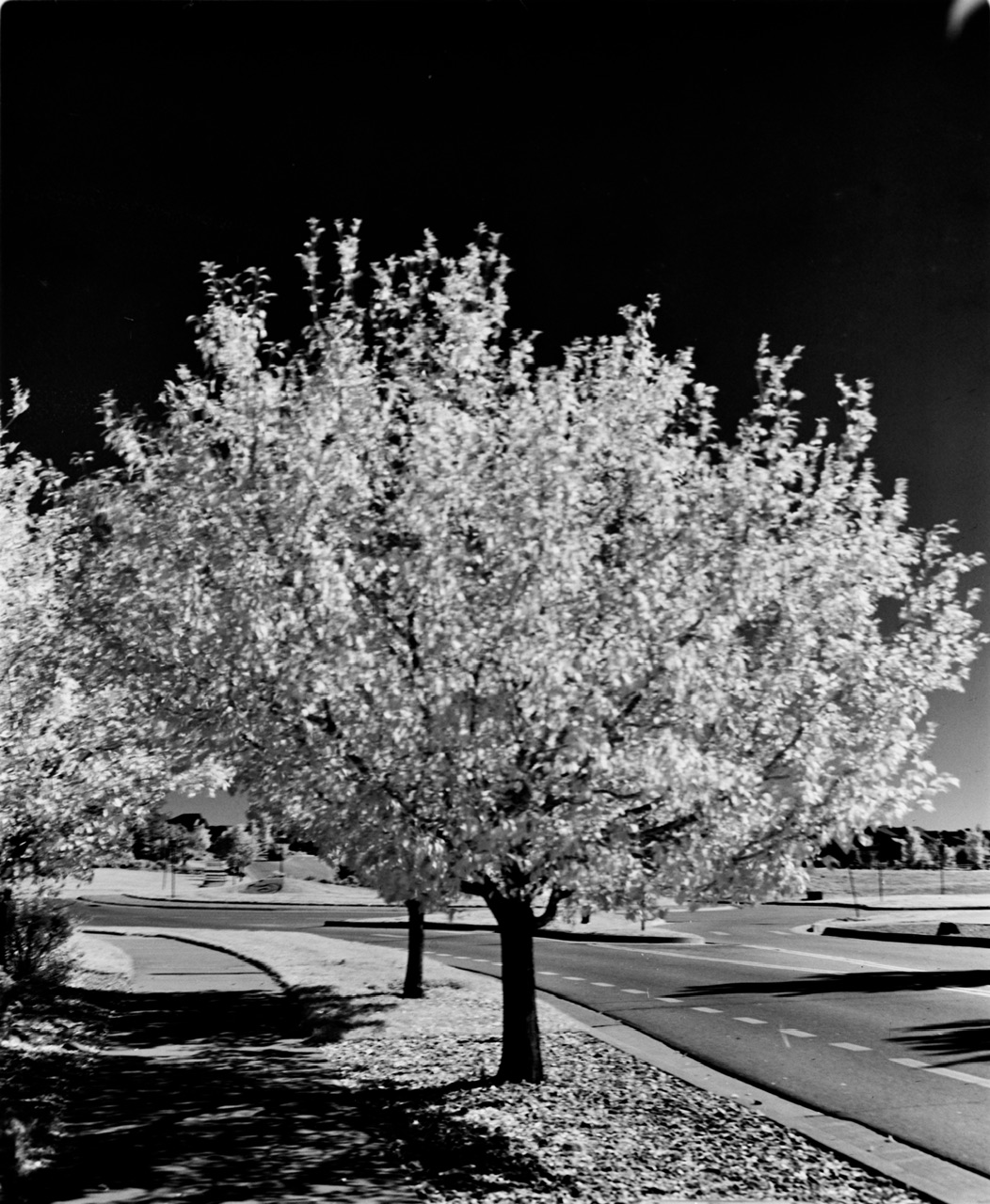

Shot in the RB67 with a 90mm f/3.8. Exposed at EI 50 w/ 720nm filter. Scanned with D5300 / Nikkor 55mm f/3.5. Some super nice results.

Do you need to adjust focus using the IR focus mark, or do you just use the normal focus mark?
I think technically you’re supposed to, although the RB67 doesn’t have an IR focusing mark, so I just kinda didn’t. I don’t remember what a lot of these were shot at, but I think I tried to stick around F8 to account for this.
They're gorgeous! When you shoot at EI 50, how are you picking aperture and shutter? Are you just metering the scene as if it you were shooting a normal ISO 50 film, or is there some extra peculiarity to shooting IR that I am missing?
You got it right! I metered without the filter on for 50 ISO, then put the filter on and took the photo!

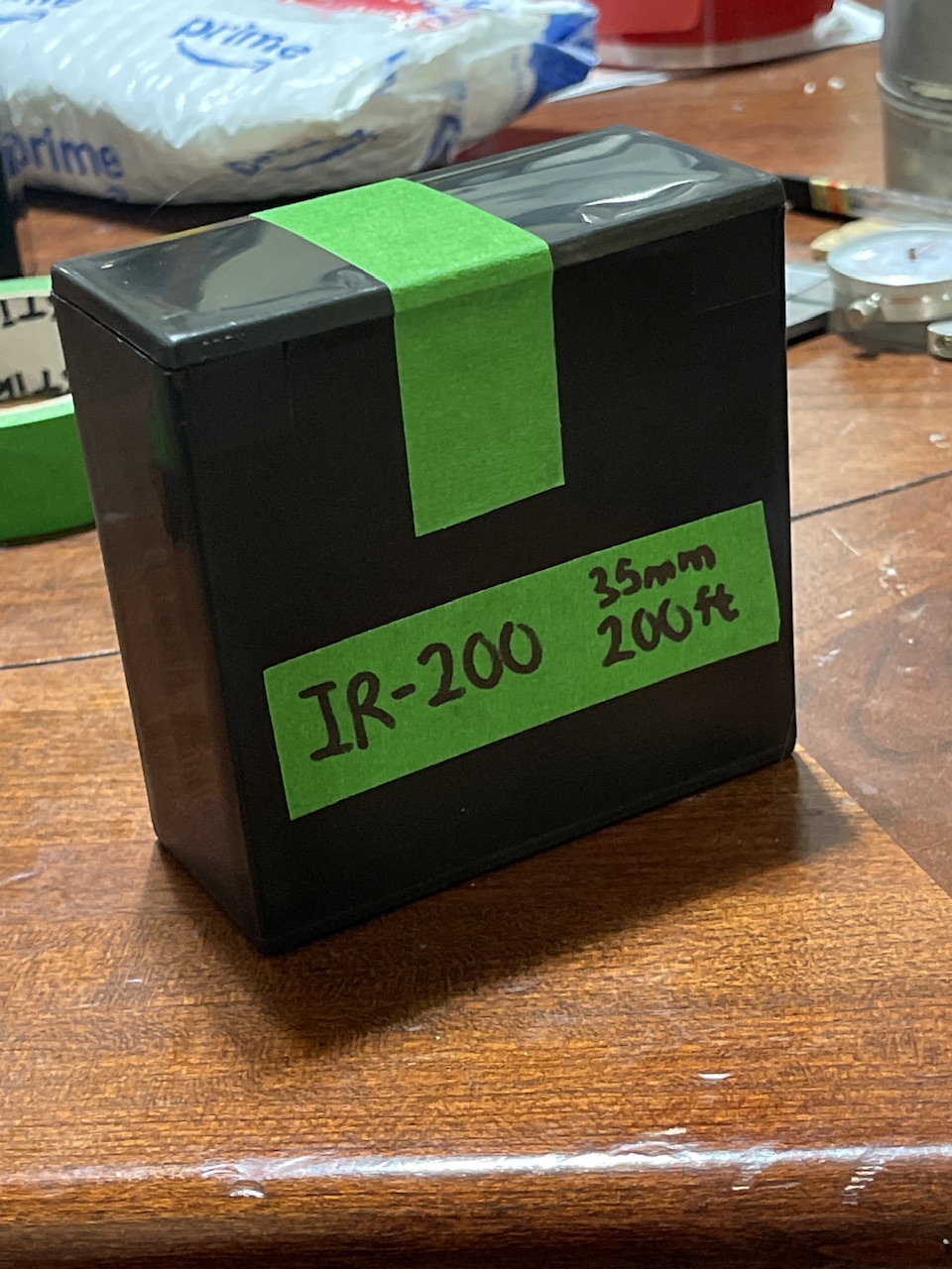

The IR-200 came in last week, I got all the bulk rolls and 35mm cassettes finished, will be working on 120 for weeks though.
I actually bought 200 ft for myself for making an Eyemo load, can’t wait to shoot it later this summer!

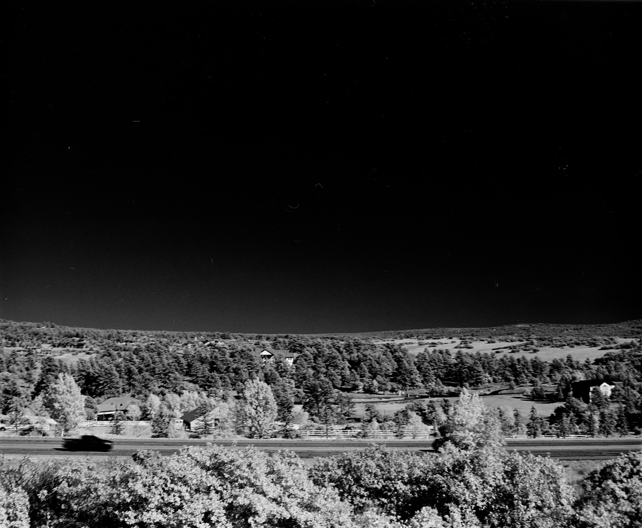

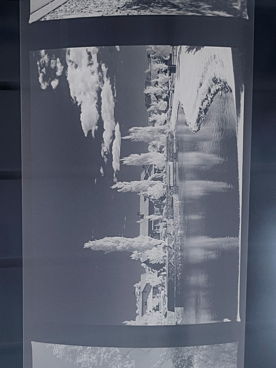

Scans are back, and holy crap this film is super awesome.
All taken on an RB67 with a 90mm lens and Zomei filter. Unless otherwise noted, all images are IR.
Visible light, EI 200 (control, to ensure development was correct)
EI 50
EI 25
EI 12
EI 50
EI 25:
EI 12
EI 50
EI 25
EI 12
  • 12 to me looks almost overexposed. But maybe that’s just me. You can see some of the shadows get crushed. There’s a bit of that with 25 as well, but to a lesser extent.
  • 50 looks absolutely stunning, and I would have zero issues using this as a 50 speed IR film, but the sky isn’t quite as dark as I’d like.
  • 25 seems like a nice sweet spot in my opinion.
What thoughts do you guys have?
This thread has reminded me that I have some 35mm IR film in my fridge salad draw. I'm waiting for some constant sunshine here in the UK before using it... It might be a while... :smile:
I love the tones in your images, but I actually prefer the ISO 12 images, but then I do prefer darker prints and the others could be printed that way.
As for exposure, when I've used it in the past with my Pentax MZ5N 35mm camera, I exposed with the IR filter on the lens used and bracketed the exposures over 2f's in 1/2f stop increments. Surprisingly the cameras meter did really well and I got a good set of negatives.
But on both film and digital exposures, I never used the IR red line on the lens, but used a middle f-stop of about f8 to be on the safe side. The red line was only slightly different than the 'normal' focus mark on the lenses anyway.
