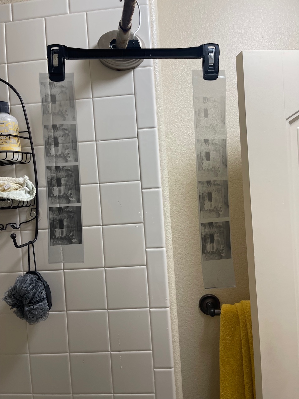

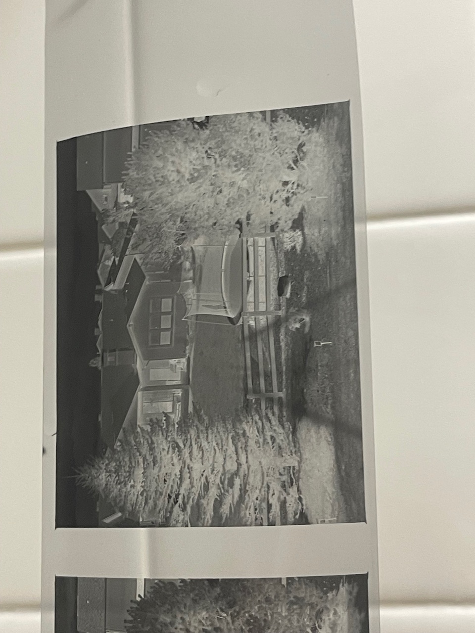

Hi all!
I recently bought some “Astrum IR B+W Negative” film (I’m just going to call it IR-200), and was told it was very similar to Foto-200 film, but with a 775nm upper limit into IR as opposed to the typical 750nm. Honestly I thought it wouldn’t make much of a difference, but I bought some just to see. I decided to do an experiment with IR-200 and Foto-200, to see if IR-200 is actually more IR-sensitive like they claim. Right out of the tank, I do think I see a difference. Maybe it’s confirmation bias, idk. Looks like the IR-200 (left) might be like, half a stop faster than regular Foto-200?
These films were shot in 2 different film backs on my RB67 within minutes of each other in the sun with no change in lighting conditions. The film was loaded into the same development tank and developed at 68°F for 8.5 minutes, as suggested by massive dev chart and FPP (who sells the IR film under their own brand). EI from bottom to top of both rolls is 25, 50, 100, 200. (Yes I know, that’s a bit high, I meant to start at EI 12 but accidentally set the wrong shutter speed when I started).
Do you guys have any thoughts on this?

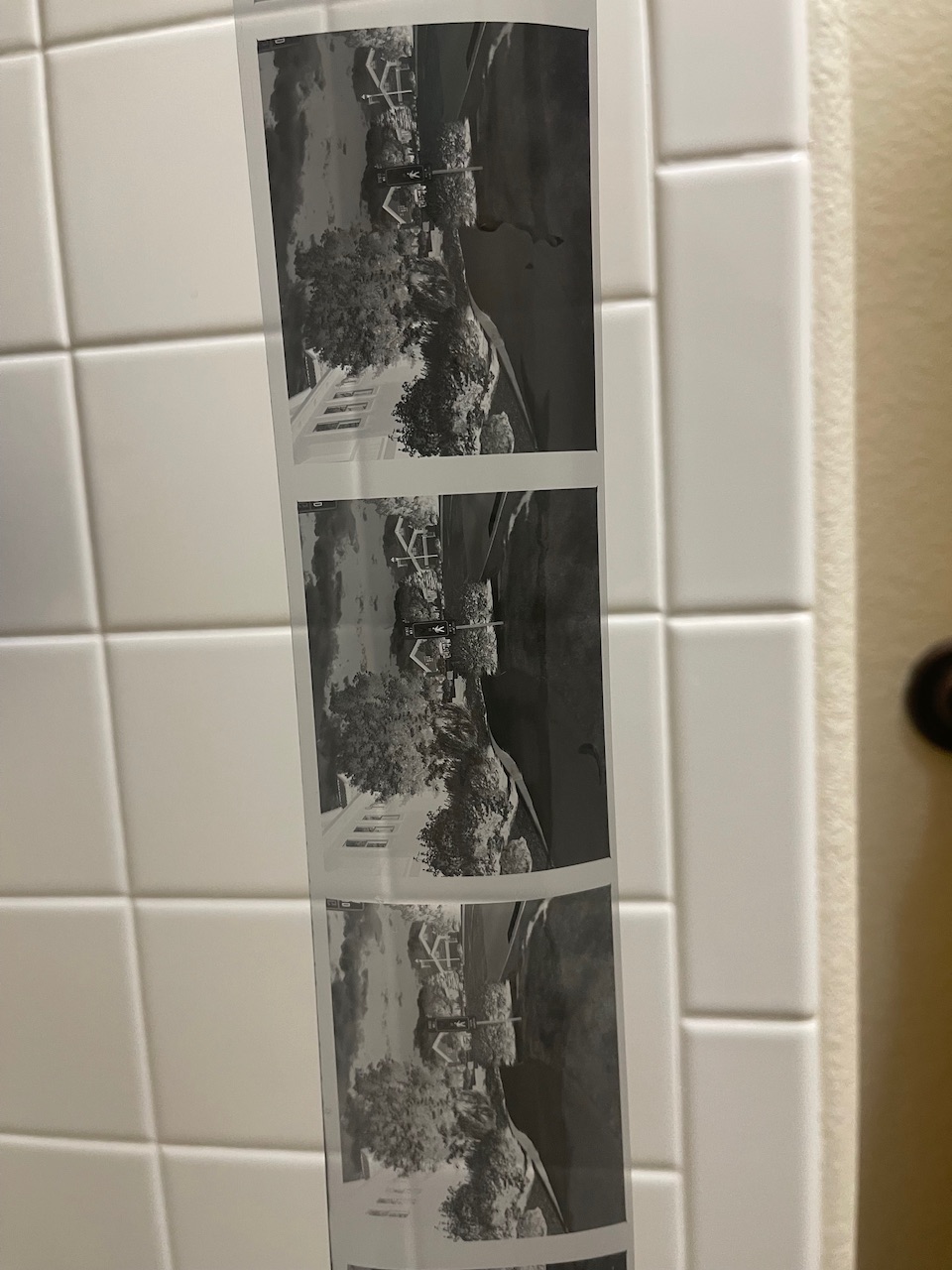

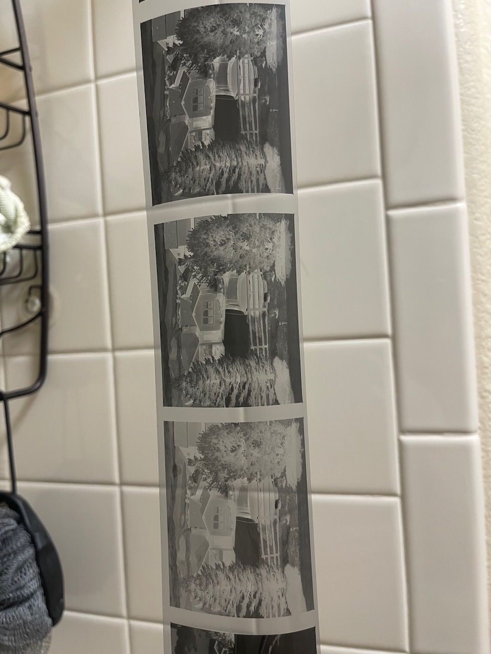

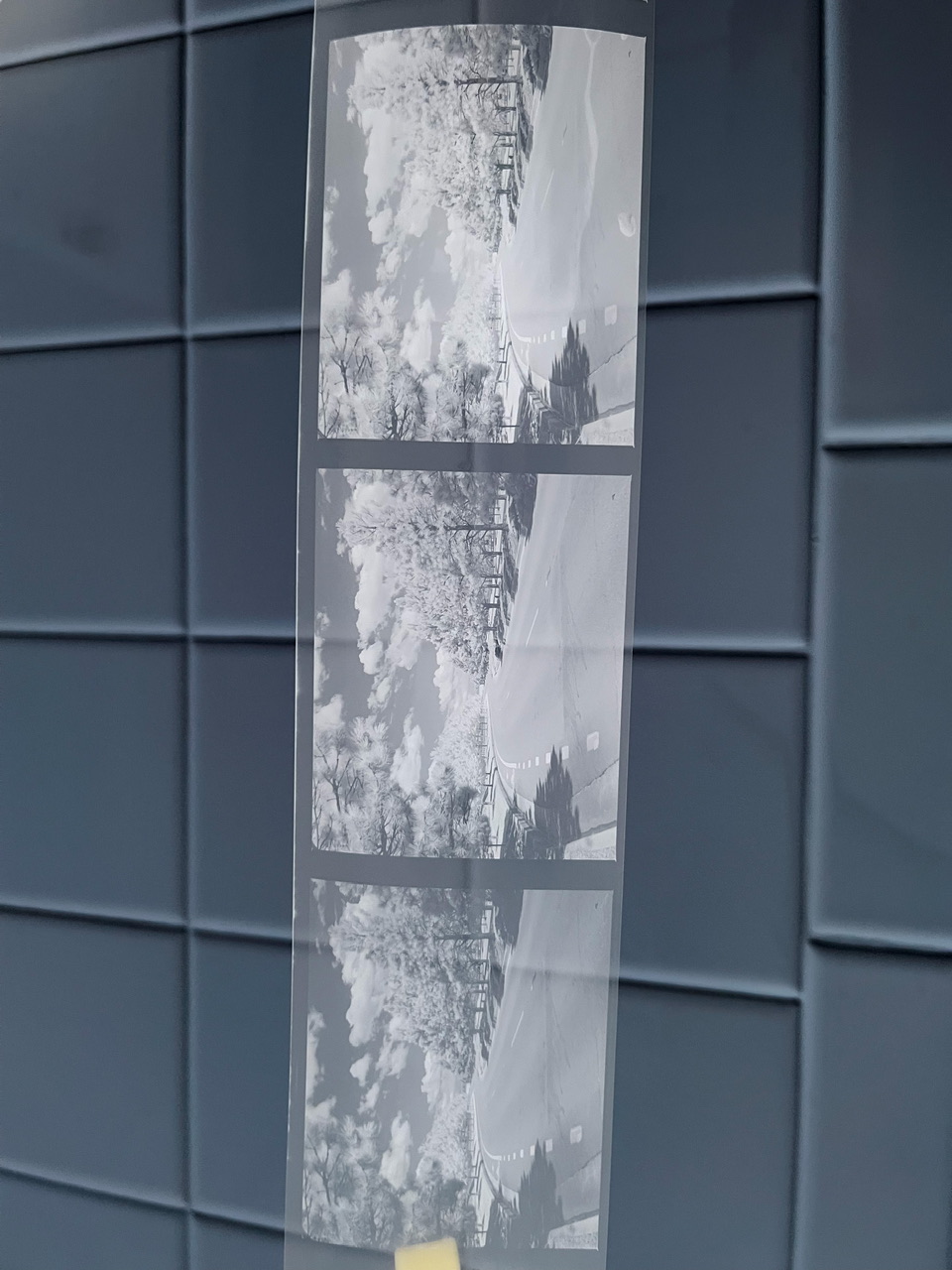

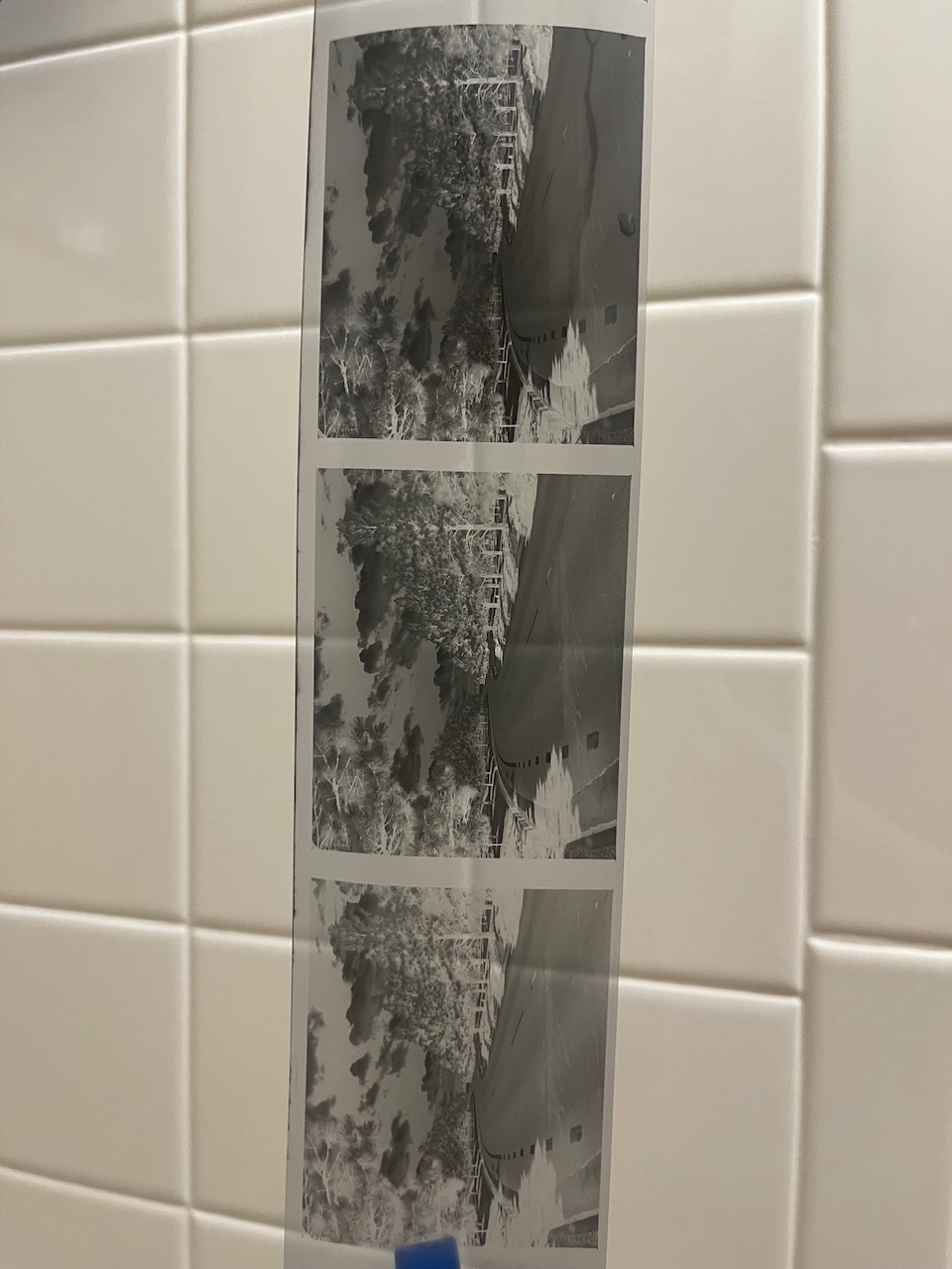

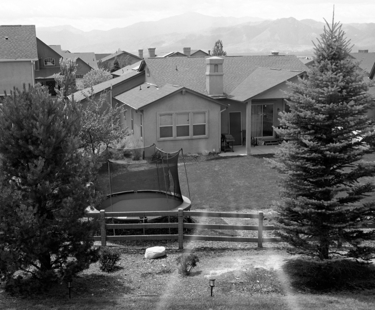

Just developed a full roll of this film, and it looks good!
Each of these sets from top to bottom is EI 12, 25, 50:
Control image of visible light at 200 ISO to verify correct development:
And, a quick and dirty invert on my phone:
Honestly, I think EI 12 looks slightly overexposed. EI 25 looks perfect for printing, and EI 50 is maybe a bit underexposed, but for scanning it should be fine.
Pretty cool stuff I think!

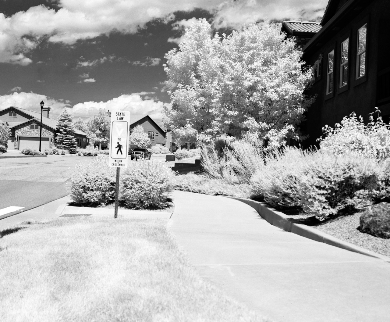

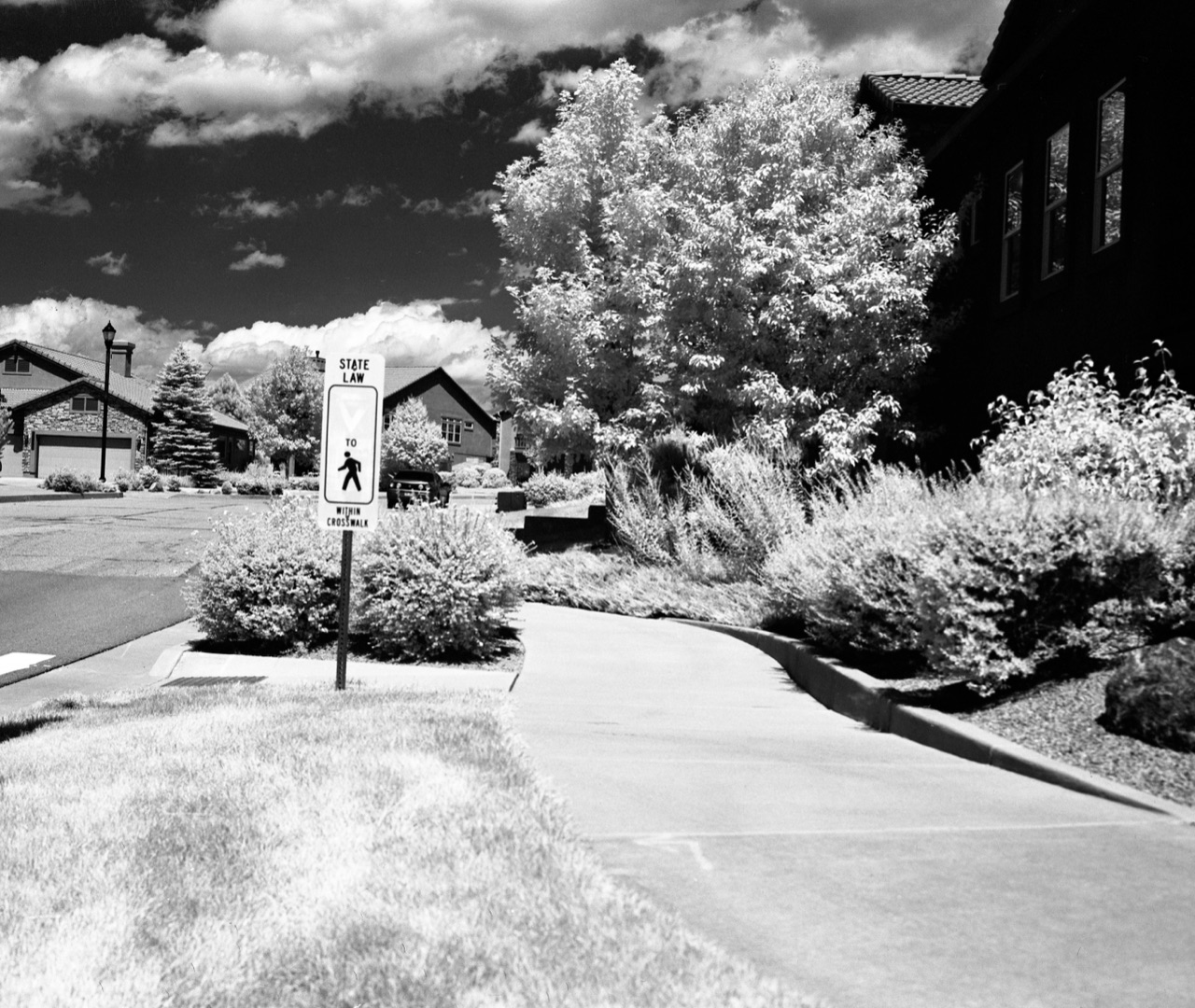

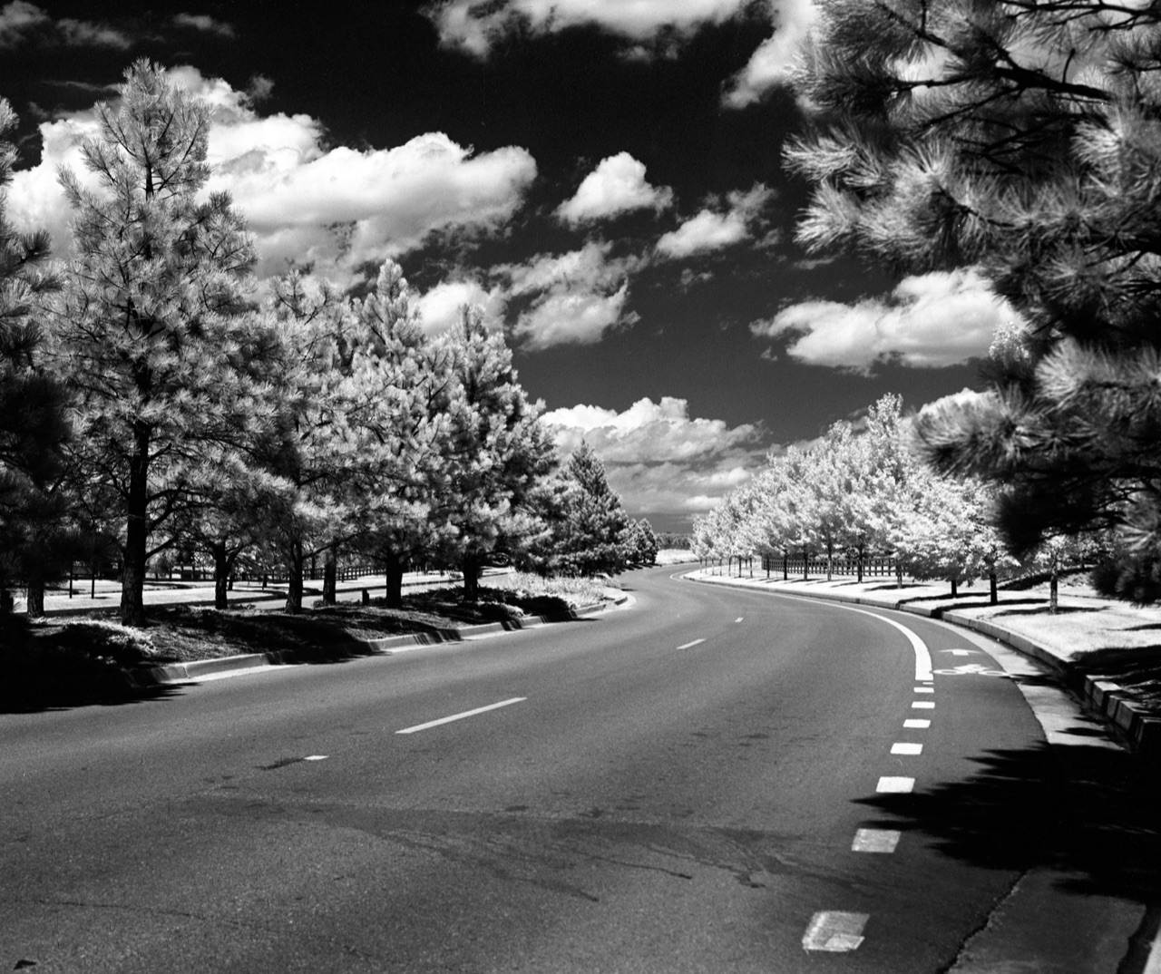

Scans are back, and holy crap this film is super awesome.
All taken on an RB67 with a 90mm lens and Zomei filter. Unless otherwise noted, all images are IR.
Visible light, EI 200 (control, to ensure development was correct)
EI 50
EI 25
EI 12
EI 50
EI 25:
EI 12
EI 50
EI 25
EI 12
  • 12 to me looks almost overexposed. But maybe that’s just me. You can see some of the shadows get crushed. There’s a bit of that with 25 as well, but to a lesser extent.
  • 50 looks absolutely stunning, and I would have zero issues using this as a 50 speed IR film, but the sky isn’t quite as dark as I’d like.
  • 25 seems like a nice sweet spot in my opinion.
What thoughts do you guys have?

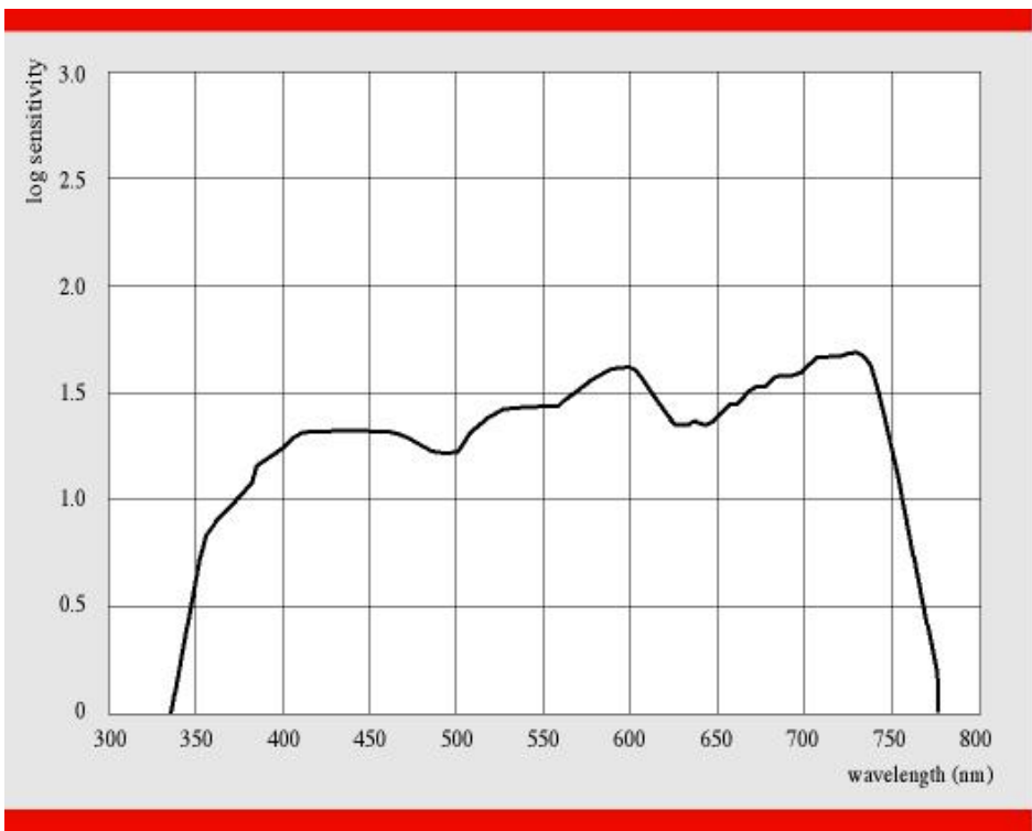

The 775nm IR film is Aviphot 80, Rollei also advertises it on their respooled Retro 80S. Aviphot 80 has extended IR sensitivity as per Agfa:
