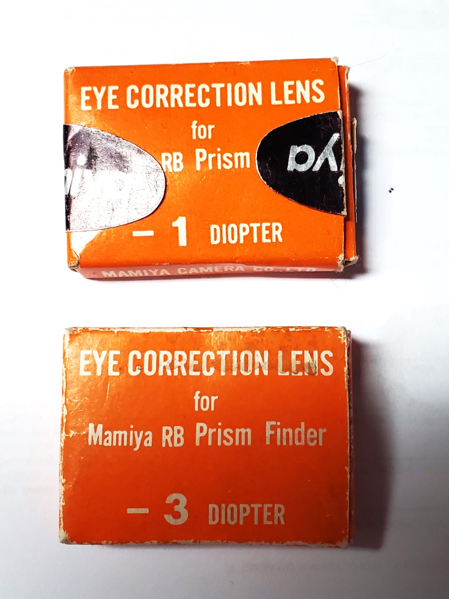

From the RB67 owner manual:
So it appears that you may be seeking the 'adjustment lens value (delta to the standard finder lens)'. I suggest you take your camera into the chain drugstore near you, and put on reading glasses of various strengths as trials, until you find the diopter strength that best permits your eye to visualize the texture of the focusing screen (or edges of the focusing aid in the center). Then, the optical strength diopter to buy is [-1.3 diopter + best drugstore strength], for example, if you find +2 diopter drugstore lens works to best see the focus screen texture, a replacement for the standard magnifier of the focus hood is
-1.5 diopter + (+2 diopter) = +0.5 diopter.
What is not clear is how Mamiya defined the strength for its diopter magnifier...they could have called the correction for YOU either by +2 (relative) or by +0.5 (absolute). ..unfortunately the camera manufacturers vary from one another about how they do that! I surmise that if +2 in the drugstore were best for you, you would want +1 to replace the standard -1.5. But you have the additional uncertainty about the diopter value supplied with your used WLF, there is that issue, too! It seems that if you cannot find a store that you can try out different diopter lenses in your finder, that you seek mailorder store willing to sell you several different strengths and that let you return the ones that do not work for you!
[edit]In reviewing a Mamiya RB67 price list, it appears that they sell ABSOLUTE value "Diopter Correction Lens" for the Single-action hood, values ranging from +1 to -3, including the standard -1.3 diopter

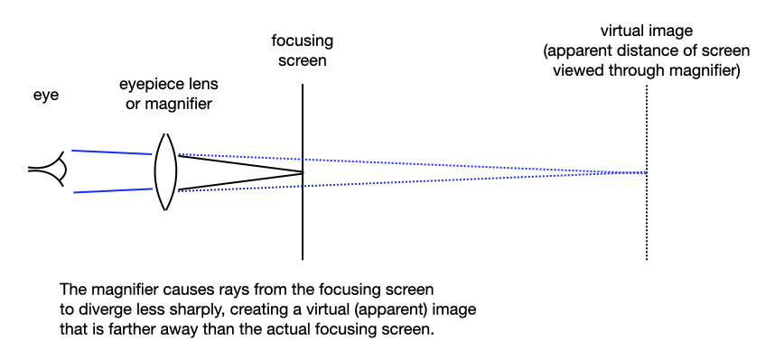

If you put your eye all the way up to the WLF without the flip-up magnifier, physically your eye is only a few inches away from the focusing screen. Most people even with perfect vision can't focus that close. The magnifier serves the same function as the eyepiece lens in a 35mm SLR. It is a positive lens with a focal length that is similar to the physical distance between eyepiece and focusing screen. This causes it to make an apparent image of the focusing screen that is about 1 meter away from your eye. This apparent image distance does not depend on where the camera lens is focused. The whole point of a focusing screen is that it is a matte surface on which the lens projects an image, and your eye looks at that image, not through the lens directly.
The apparent image formed by the magnifier is a lot easier to illustrate than describe in words, so I drew a diagram. The eyepiece lens of a 35mm SLR does the same thing, creating an apparent image. The chief difference between 35mm eyepiece and WLF magnifier is that you never use a 35mm SLR without some kind of eyepiece lens - the eyepiece may be permanently attached to the back of the prism.

Let me describe a little procedure that may help you get a handle on what these things mean. From looking at your blog I recollect that you also have a Nikon SLR camera. This can be used to find out the actual distance that your eye "must be focused at."
Here's how to do it... first set up your RZ on a stable surface or mount, pointed at some brighter object. Preferably focus the camera on it, but not strictly necessary.
Next step, using the flip-up magnifier/diopter - whatever you wanna call it - and use the Nikon to look into the magnifier. Use a basic lens, like a 50mm or whatever, in preference to a zoom. Get the Nikon lens pretty close to the magnifier then focus the Nikon on the RZ's ground glass (through the magnifier). (Focus on either the image or grid or dust on the ground glass; any of these will be good enough.)
Whatever distance the Nikon SLR is focused at is the same distance (roughly) that your eye must "focus at" to use RZ camera. In essence the Nikon lens has temporarily stood in for your eyeball as a means to "measure" the "virtual distance."
Here's the next part: without changing the focus setting on the Nikon lens, move the camera forward or back in order to focus on some object (a wall perhaps). Measure the distance between that object and the front of the Nikon lens. (Approximate is plenty good enough.) Whatever distance you measure is the same distance your eye must focus at when you use the RZ, when using that specific magnifier. This will be true no matter where the photographic subject is, whether the rabbit 10 ft away or a distant mountain range.
So now that you know what is the "virtual distance" that your eye must focus at (for this specific magnifier/diopter, at the specific height where it is set) you can see, outside of the cameras, how well your eye does at that "real" distance. You could, for example, set a magazine page, or cereal box, or whatever, at that distance, and see how well you can read it. (Especially try this in dimmer light; the pupil of your eye will open up wider and maybe affect the result.)
Now, this is not gonna answer the question of how to select different diopter, etc., but maybe will help you to better understand what several of the more knowledgeable posters are trying to explain.
