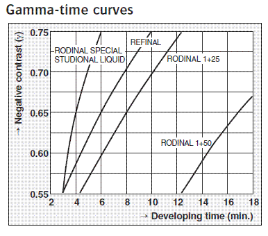

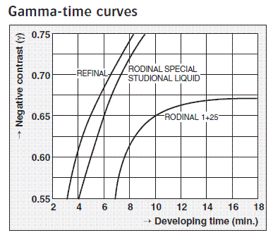

What's even more interesting is the contrast curve the Rodinal gives with the 'new' Agfa APX 400. It shoulders off really early and stops developing density, as if the developer simply is unable to increase density and contrast beyond a certain point, no matter how long you develop it for.
See attached picture snipped from the APX data sheet. The one with the Rodinal curve sloping off is the 400, and the other that has both Rodinal 1+25 and 1+50 is the 100.
- Thomas
