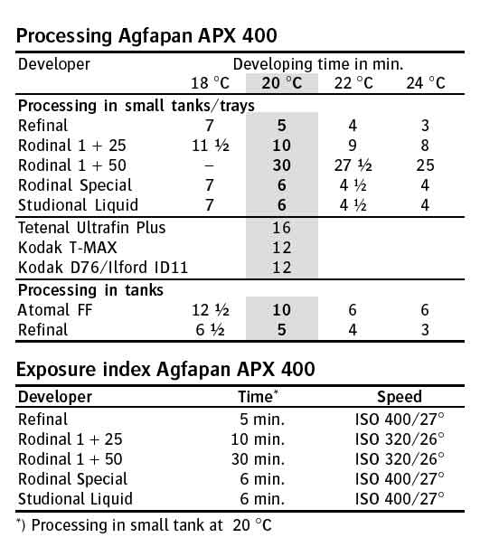

BIG QUESTION: the last version of APX 400 changed the film,
so that Rodinal required 30 minutes of development instead of 11 !!!!!!!!!!!
What is YOURS ???
d
30 Minutes in Rodinal 1+25 ???
Hmm I never heard this before.
We use 10 Minutes at 20 deg. C for comparison tests but the final product (because it is higher in effective speed) might end up between 10 and 13 minutes.
The First Coating comes best at about 11 Minutes.
Are you sure your Rodinal is OK ?

"Are you sure your Rodinal is OK ?"
Yes, Mirko. How is yours ?

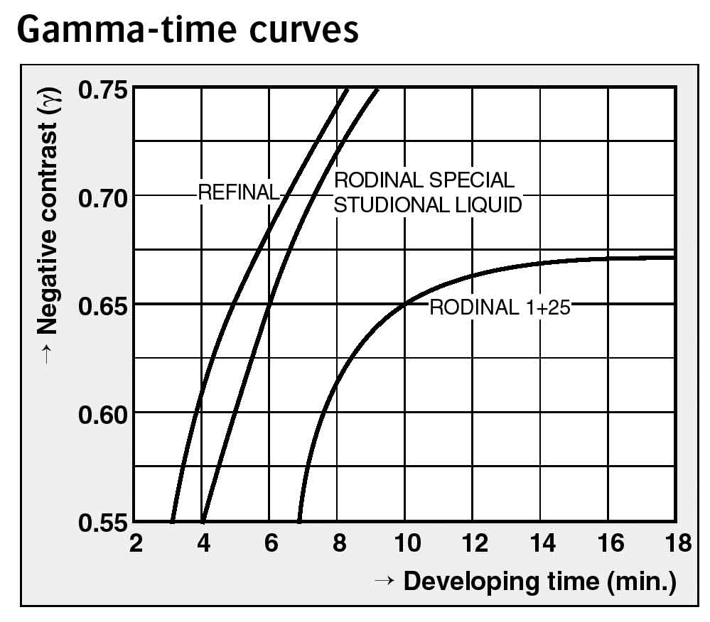

From AGFA Technical Data F-PF-E4
Date: 07/2003 4th edition (coinciding with the release of the final version of APX 400)
Please look at the attachments.
If that seems weird to you, it was REALLY a surprise to me (when my delivery of bricks and bricks of APX 400 arrived, and with the new design boxes.) It took precisely 30 seconds to open a box and see the development sheet, and to call AGFA USA and start waiting to talk to the tech guy. It took about a minute for him to get on the line to Germany.
And I shot precisely 1 roll of it, and the development data was correct. The old development time didn't make a dent in it.
So, which emulsion are you making ? And which base are you using. What era film is this ?
And do you understand why a few of us out here in Foto Land might be curious ???

Those Dev. times you posted are crazy! 30 min. at 1+50, wow. I used to use APX 400 in college (10-15 yrs ago) and used 11 minutes at 1+50, EI-320. Great results. Can't imagine what they did to mess up this film so it needed 3 times the dev. time!

30 minutes Rodinal 1+50 for latest Agfa APX400 has been said by Robert Vonk to be a mistake and 13 minutes was the supposed right time.
I've exposed the last stock APX400 to EI 250 and developed in Rodinal 1+50 for 13 minutes with agitation every 3 minutes and the negatives were developed enough.
